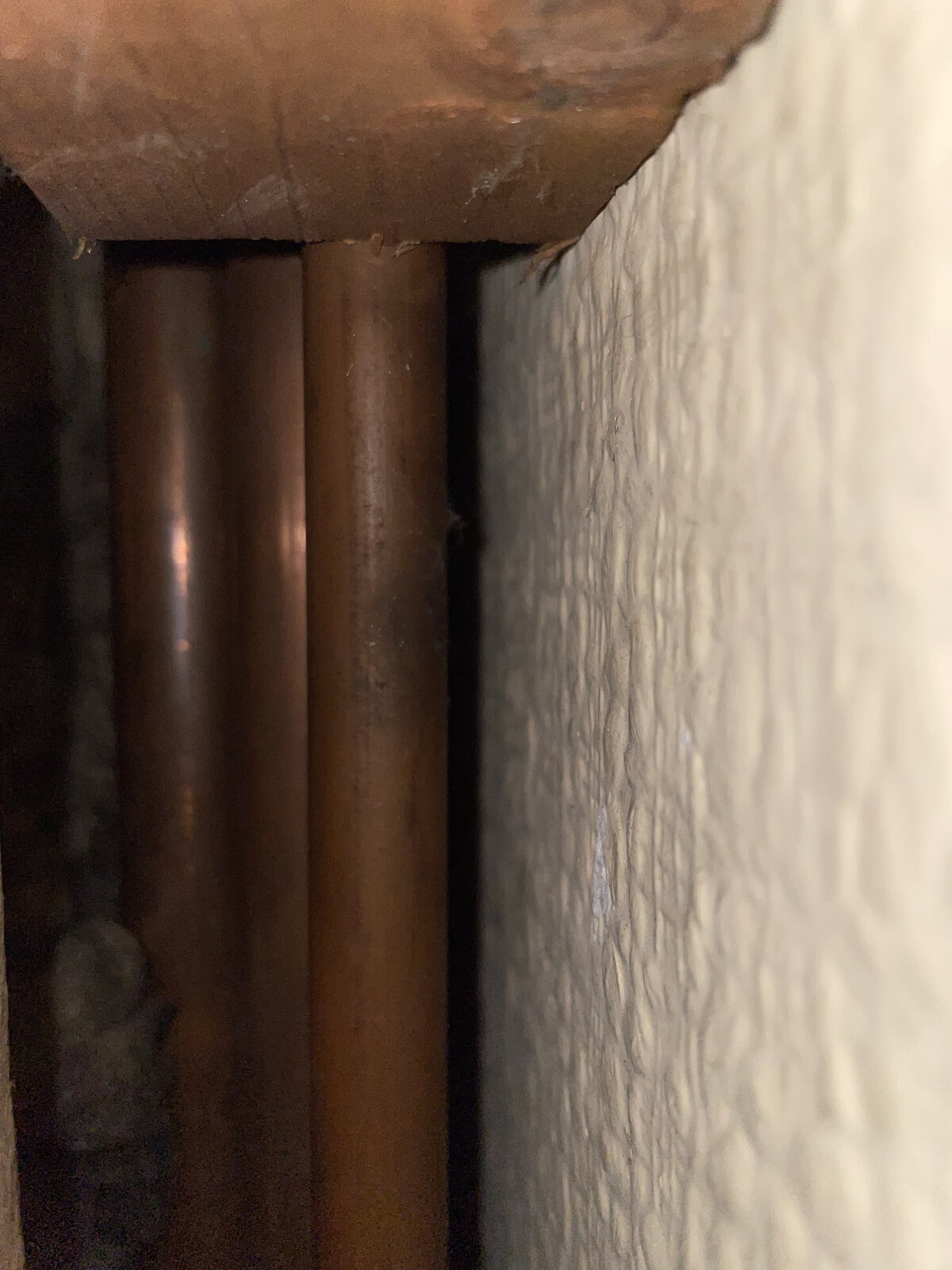

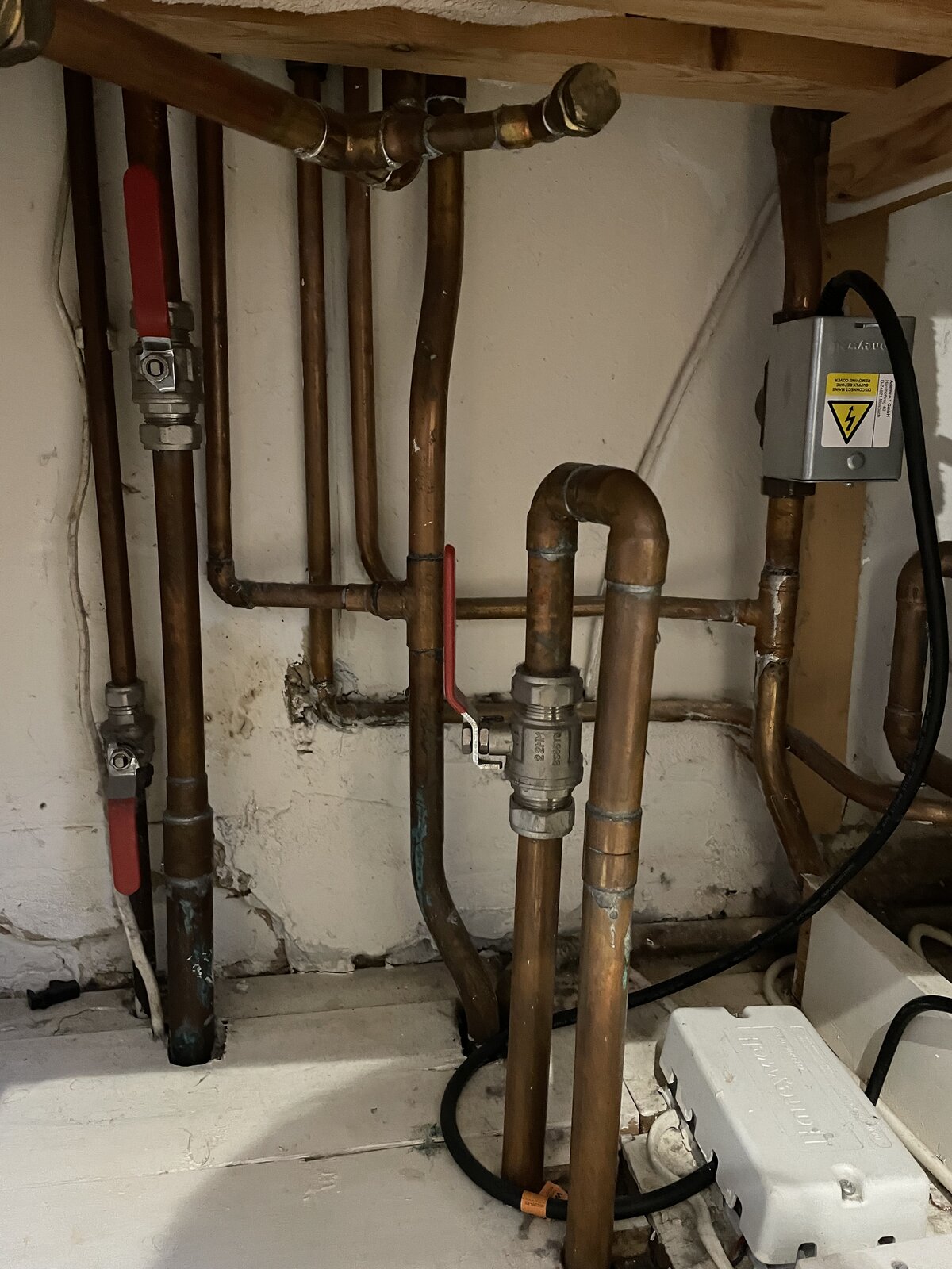

Back again with a tidy hole in the fake wall. I might have to open it up a bit more to be right on top of the pipes but from what I can see and feel there are 3 pipes going up. Two are 15mm I would say and the third one feels larger so I would say 22mm.
Edit- after that I cleared out all the crap in the cupboard and all the (messy) pipe work is there to be seen. If I’m right the gas pipe is at the back and looks to be 22mm and has an isolator on it. If that is the case then it means that a very short distance is 15mm which means the pressure drop is very strange. Oh well let’s see what GS have to say and I think I can fill the hole back in!
