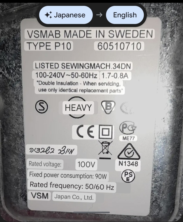

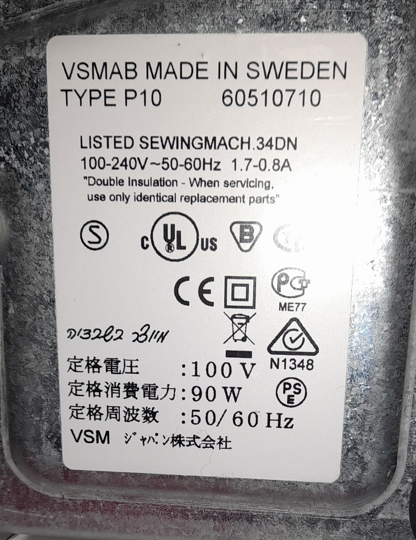

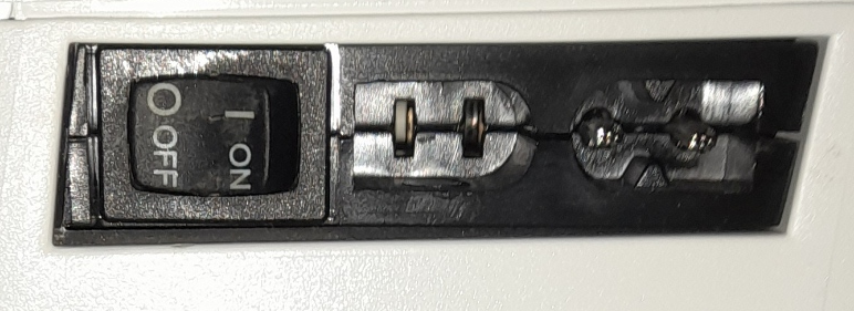

Asked to PAT test, and no mains lead, looked on base 50/60 Hz 100 volt, and the leads I can find on the internet are like this
a polarised 2 pin lead, but always seems to have a USA plug, so 100 volt to 120 volt seems no real problem, but to 230 volt rather a big jump, it was my mother-in-laws, and she did use it, but as to if it had some step down transformer not a clue, it may have been changed inside and the label not modified, or it may have some step down transformer, but can't find any info.
Can you post some pictures?
Possibly not helpful, but many sewing machines have proprietary mains connectors, because the mains is fed through the foot pedal - have you got one?

As the top label says 100 - 240V, that suggests there may be an easy way to swap between voltage ranges. I've had a couple of pieces of lab equipment that have a round plug on the back, that you take out and rotate, to select the correct voltage range.
I wonder if there's something like that hiding on the machine?

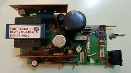

It may have an internal power supply that by using an invertor allows the machine to operate on any supply voltage between 100 and 240 .

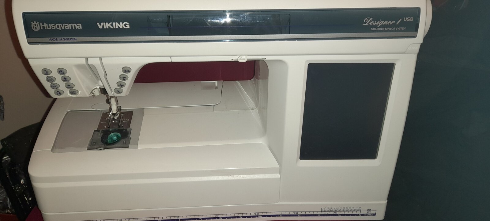

I now think it probably has a SMPSU, it's not nearly as old as I thought it was.
The USB gives a clue and so does the big screen on the side. These things are expensive.
It's just interesting that the Japanese rated voltage is 100V.
A standard figure of 8 lead should fit.
What PAT test were you planning to do on it?

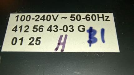

Some more digging - yes it is an SMPSU.
Although I don't think I'll be buying this one as a spare...
And it is rated 100-240V 50-60Hz
