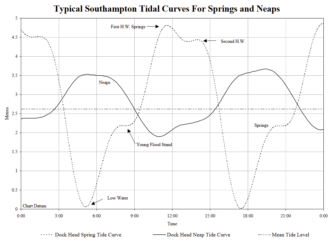

Southampton/Isle of Wight gets a double peak something like this, not two tides but a very useful longer period when harbours etc can be used.
which is due to that resonance thing I referred to . Remember it comes UP not IN, so it's nothing to do with the island being there..

I think that would be for an extended high tide - the Channel has double peaks even where there's no restriction. IE it goes down a bit then back up.

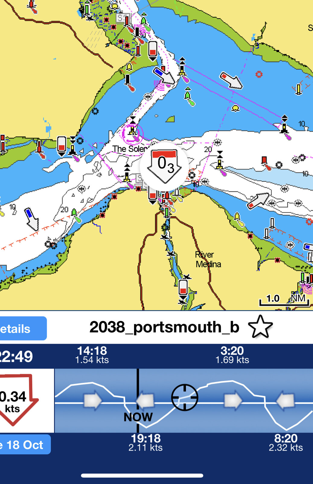

On your diagram for the iow. You have the effect of the southbound tide when it turns. It doesn’t go east then west etc , it swings south for about 40 mins - that tends to back up the medina a bit

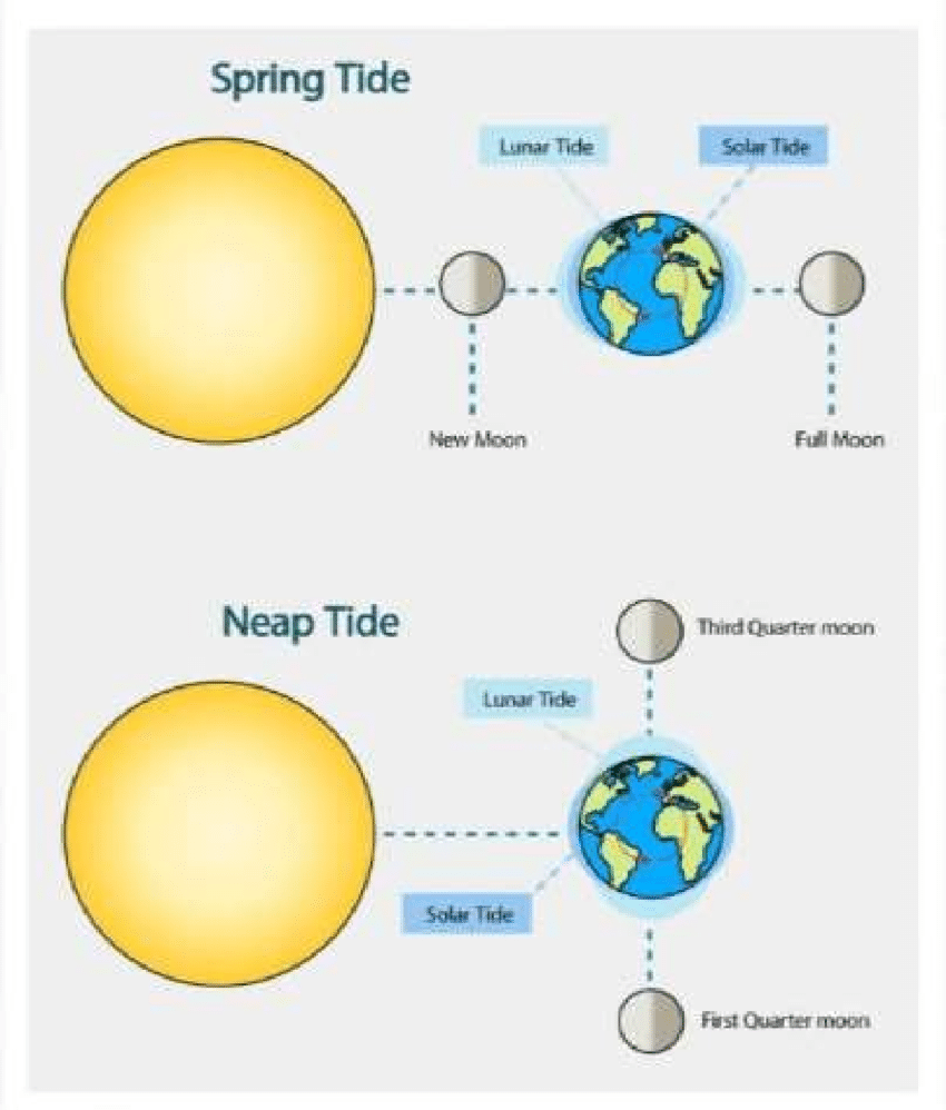

Dead simple. The sun and moon cause the sea to bulge where they are having an effect.
Then it gets more complicated. The bulge causes flow. In some areas the flow is restricted. In some it isn't. That results in specific high and low tide times around the country. Also different heights.

The tides are (obviously) later towards the east, but the double high tide is a result of oscillations and resonances.

I wasn't arguing with you, I was offering an explanation as to why there is a backing up of water in the mouth of the Medina.
