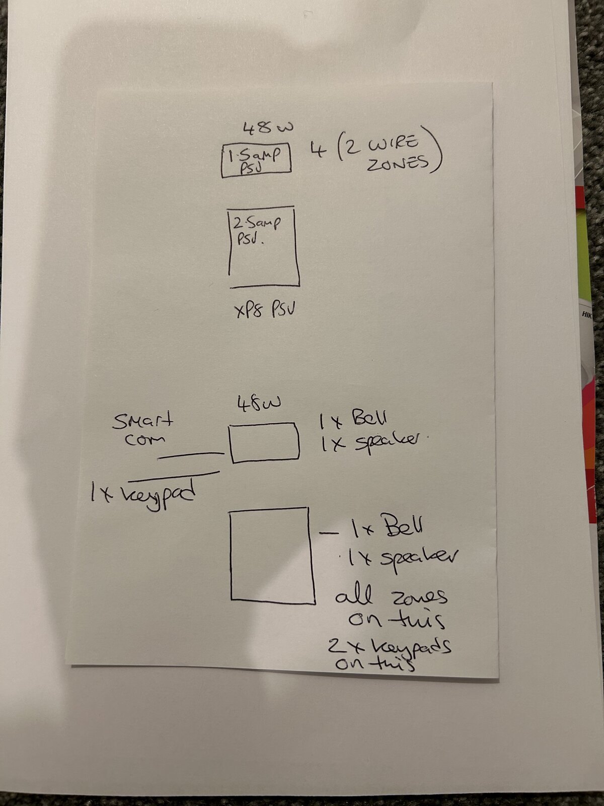

Ok this what I would do
If you had replaced like for like ( but elite ) you could done a straight swop and switched a few things around …
As you have got a 48w it’s a bit different

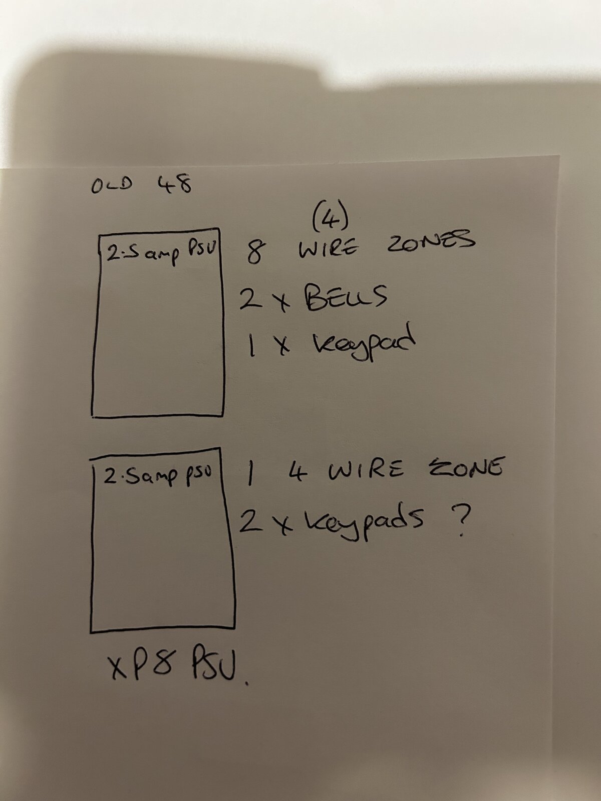

You need to balance out the load between the 48w and the psu
See rough diagram
Your going to have to transfer some of the old zones onto the 8xp in the psu and possibly fit resistors in the ones you leave on the main panel ( 4 ) max

Ok- i kinda understand balancing out the zones between the 2....as i got the whole lot for 85quid (the smartcom being the more important part) would be it worth getting a different panel? - (before we get started!) and if you think i should what would you suggest...i can just put this panel back on ebay if i need to (just trying to make your life a little easier with barrage of questions im throwing at you!!

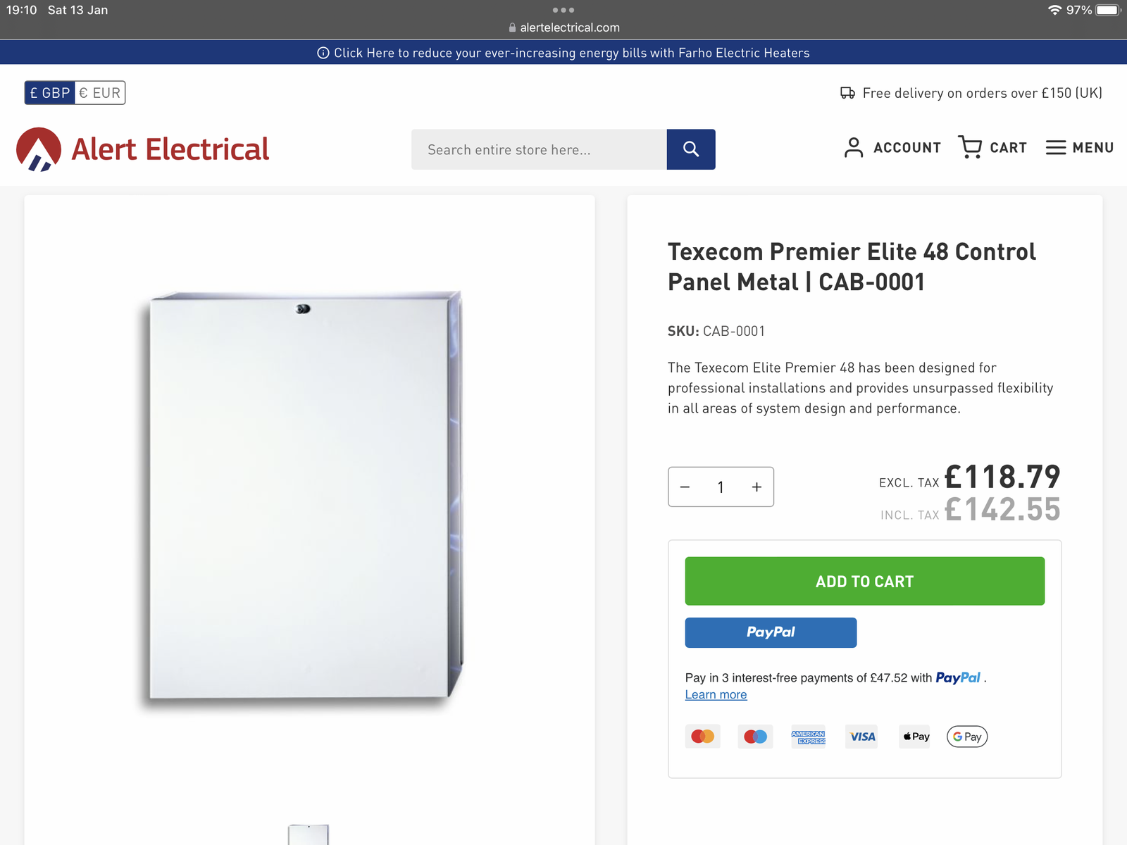

Just get a new 48 , at least you know it’s a good panel with no issues plus you won’t need the flasher as it should have the latest firmware or one that can be remote updated ….

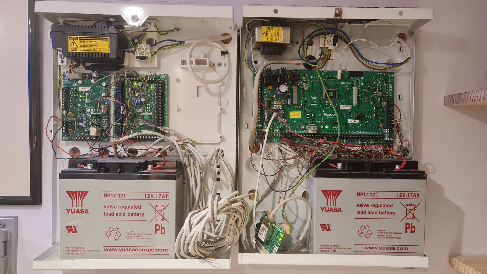

Post pictures of what devices you have and a picture of the existing panel and psu together in the same picture

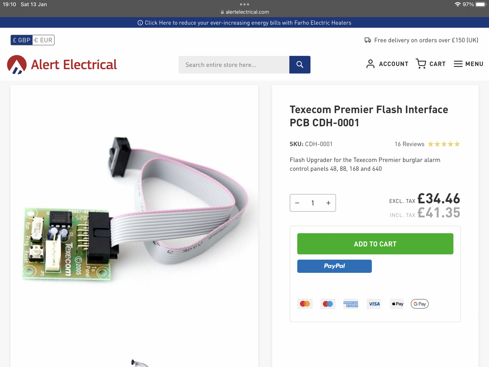

Righty...cool - thats ok..i can get one of those later - if i ever make it that far....! right...enough of the questions ill get the panel on order with the flasher - when i get the usb com ill update the 48w ive got here (im sure ill be asking questions) and move that on...!
Just double checking....this one ok...?
If your getting a new one shop around prices vary a fair bit.

Oh..heres a shot of them side by side as requested...
So - stuff starting to turn up....the new premier 48 panel arrived last night. Ive got the USB cable and ive also ordered (i know i dont need it for the new pane) a flasher unit so i can flash my old panel and the one i bought off of ebay (self inflicted training if you will) plus i thought it might be a handy thing to have...
The brand new panel looks nigh on identical to my original panel so im going to label it all up and transpose the wiring over....i did try briefly last night to get into the panel over the usb cable...coudnt get a connection (but i think i know what im missing) so will try again tonight...assuming i can get a connection ill read off the existing config....then when the flasher turns up (hopefully tomorrow) ill try to flash the panel to the latest version of whatever revision of panel that it is....
