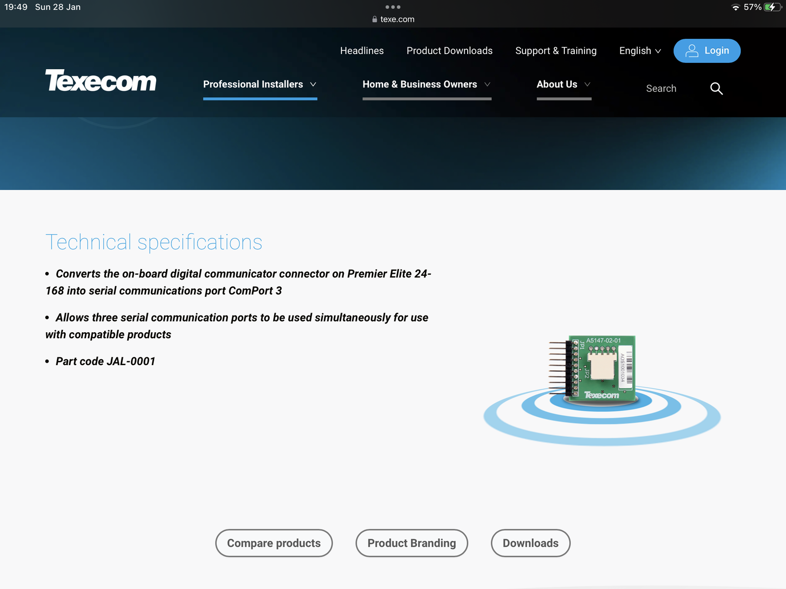

Can the Smart com replace the ComIP? ie can i use WinTex to connect it through the smartcom?
Theres also a com3 ? wheres that on the board..nice if i could have 3 comports!!
Yes you replace the ip com with the smart com , it will take up com 1 and 2 , you can connect via smart com and you can use the digi com connector via small adapter normally supplied with the smart com
Ah - right - ive not got that board...ill have to get one on order...strangely i loose connection over ip to the board if i mess with comport1?? weird - i did set it to "nothing installed" but now ive lost connection over ip...? - the module is working though as i can get to its landing page..the smartcom module is missing its front cover so that tamper switch is open..will that matter...ive mailed texecom to see if i can buy a replacement box for it..
Located a digi converter and purchased. Ive asked Texecom but not had a reply back about a replacement case for the smartcom. Assuming i cant get one i was going to house it inside the main premier 48 metal box somewhere. Obviously theres a tamper button which kinda wouldnt work was gonna stick a bit of blue tac on it just to get round the fact i didnt have a case...
Normally ( used to be ) if you powered up the smartcom with the tamper open it ignores it
Ah - brilliant - cool...ok when that little board turns up ill move to the SmartCom...cheers.
