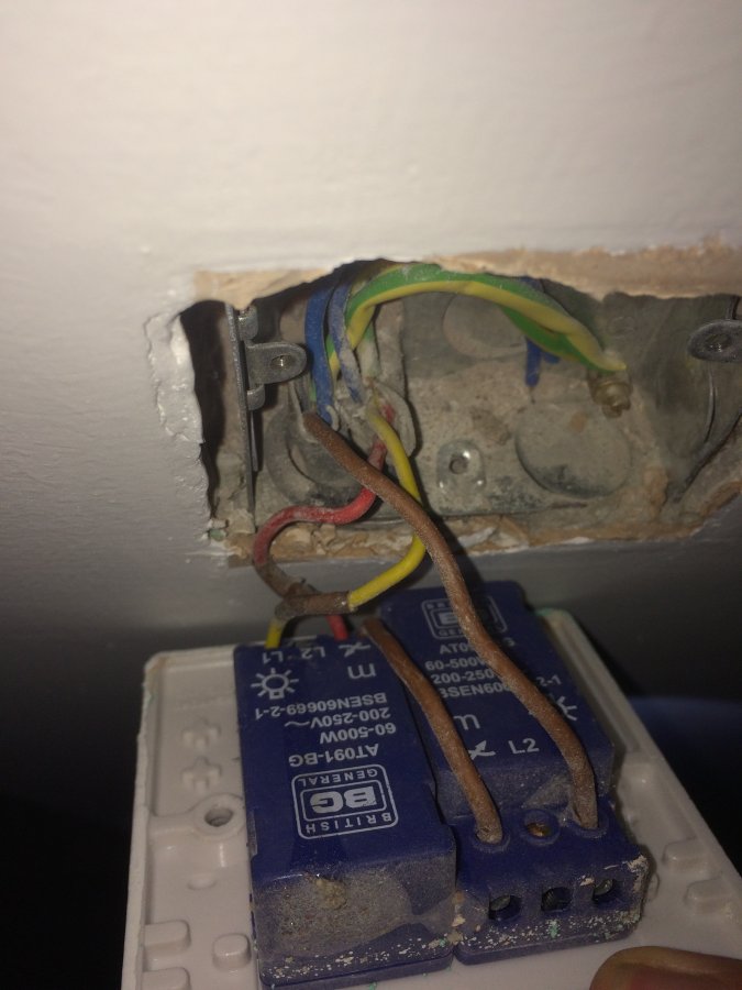

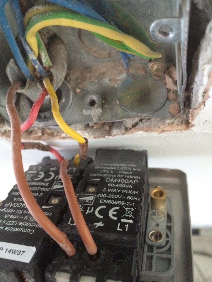

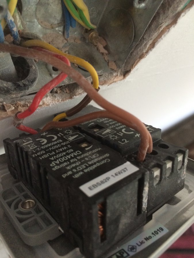

Hi everyone, so I decided to keep the lamp sockets and bought a 2 gang dimmer switch. I've wired it up the same as the previous one, and the switch that turns on the two main ceiling lights works fine, but when I try to turn on the switch that turns on the lamp sockets it pops and the power trips.
Any ideas what I've done wrong? I'll post two images below of the old and new dimmer switches and how they are wired up:
Old switch wiring:
The wiring looks fine. Except you must earth the metal plate!
What is tripping exactly?
Do you have a lamp plugged in?

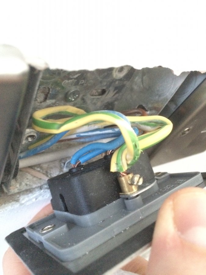

Can we see in the back of the 2 sockets?
I think this could be a very easy fix but I need to know the answers to this first.
The power to the entire house trips. I've ony changed one of the sockets so far, wired up exactly as the last one was.
Can I earth the metal plate using one of the earth wires at the back of the box?
Is the plate screw on that socket screwing into the brown wire that is positioned behind the screw lug? There is also a lot of exposed copper on the line and neutral wires which isn't ideal.
You can either fit all the earth wires from the back box earth terminal to the switches earth terminal. Or run a 1.0mm² earth wire from the back box earth terminal to the earth terminal on the switch.
