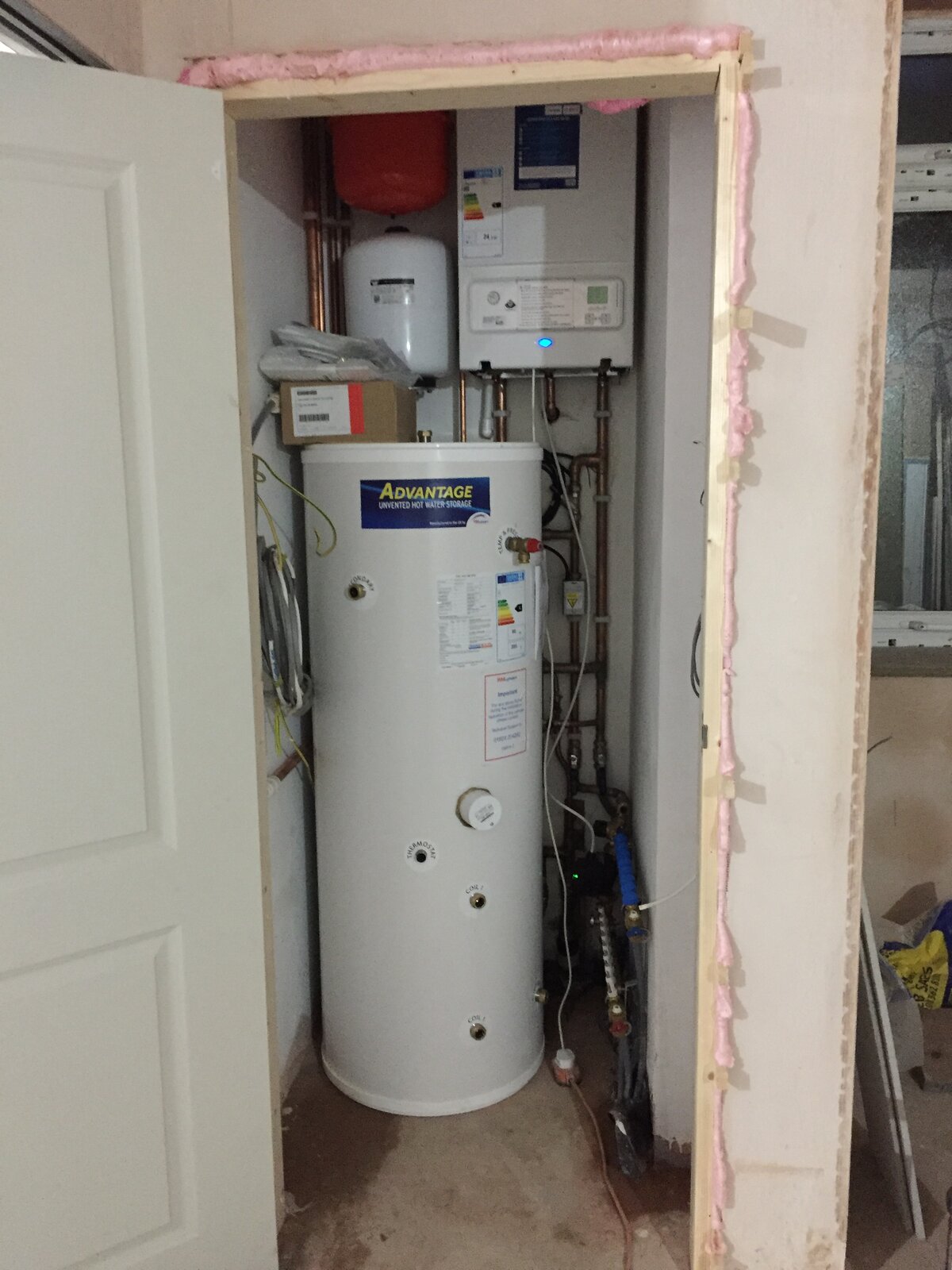

Ideal logic plus combi 30
And. Flow & returns are copper. No problem with hot or cold water being plastic to that point. Take another look Bodd
I may be wrong but as far as Im concerned any plastic push fit should be min 1m from boiler.
Mathew if Dangee thinks thats not a bad install then don't listen to him Sorry Dangee.
Its Poor.
Yeah this was yesterday’s job. I don’t know what I’m talking about. Lol.
Apart from the install. It could be existing pipework that is making the noise. In which case then the plumber cant be at fault.
TRV's should be on all rads except in the room that has the wall thermostat.
Old TRV's if any can may a banging noise like water hammer.

It’s way out, the photos don’t show how bad it is! We aren’t at the property anymore was just unaware when it comes to having a landlords cp12 it could be commented on or given as an advisory or anything?

Is the ceiling level? Sometimes other things not being level make it look worse. Very harsh if you haven’t paid after 3 weeks. Had he had the opportunity to deal with it?
The noise from rads is probably expansion, velocity or air. Simple to sort. Have you not even covered the cost of materials?
The lad was paid in full on the 1st visit, 2nd visit asked for more money for the filter then trvs on 3rd visit! He’s left the boiler today also on 1/2 a bar pressure is that the going thing? I thought it was between 1-1.5 bar?

There’s 2 rooms without trvs, the bathroom and the kitchen (room with the stat)
Thanks for your reply Dangee
Its a poor instal.
I would agree, If I was mounting this I’d have made sure it was flush
Was it power flushed? You need to check if they are registered.
It wasn’t flushed should it have been? he is registered.
