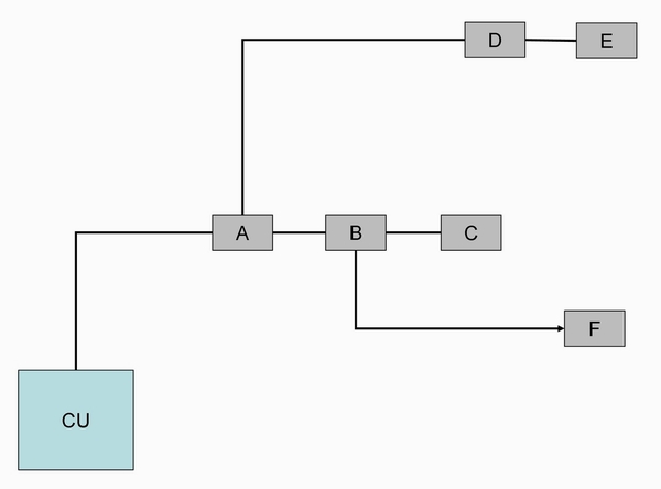

Identifying a radial or a ring circuit?

Replace a socket with a FCU and you can then add sockets protected by the FCU it really does not matter it the socket being replaced is fused spur, unfused spur, radial, or ring final if the socket being replaced has been fitted correctly in first place there will be no problem.
So, back to square one.
I just cannot see the sense in deliberately discarding one of the advantages of a radial circuit by using undersized cable on a branch.
To re-cap about spurring from a 32 amp 4mm2 radial circuit, there is no problem whatsoever spurring from it in 2.5mm2 cable to supply one new outlet.
As said, exactly the same as adding one 2.5 mm2 spur from a regular 2.5 mm2 32 amp ring circuit.
However, by spurring off the 4mm2 radial in 2.5 mm2 means you couldn't add to that spur in the future - so 4mm2 is definitely a better option.
Thanks for all your replies folks, I completely forgotten that I posted this and for some for reason I haven't received any email notifications. I've asked our contractor for the certificate now, so hopefully that should answer my questions.
