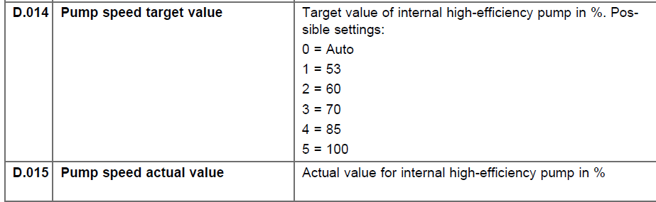

Can't find the exact one but see D.017 in the attached (ecotec 627).

I know it has been mentioning pump setting might be too high. But heat pump is set to auto..is this typically ok?

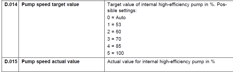

If these code parameters are available on your boiler then note them with boiler on. The pump is probably a 7M one so the actual speed (%) will tell a lot.
1=1.97M, 2=2.52M, 3=3.43M, 4=5.05M, (5=7M)
Ok it was actually set to 100%! I didn’t know. So I set it to auto. The actual value was 100%. I rebooted boiler put heating on and the actual value is still 100% despite being auto? Will it take time to tweak itself?

No, because it's auto based on 27kW when your system likely needs about 10kW
Ok given I have 13 radiators with trv averaging about 2.5 out of 5 shall I start with with 1? If it works leave it at that?
Ok I’ve set it to 1. I will check if anything changes. I will also report electricity usage as vsmart displays that
A pump head of 1.97M will give 53% of the flowrate at 7M so would expect the rad(s) dT to double, your original dT was 4C? (47-43), so might have expected a bit more than 2C increase but rads with flow/return of 47/43C at a room temp of 20C, makes them 25deg rads which will only emit, (25/50)^1.3, 41% of that of their full 50 deg rating. Can you look at D.005, D.006, D.040 & D.041. Will find a few more parameters to look up later.
