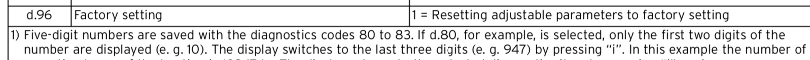

VAILLANT 831 not reaching temp
If I removed the Vaillant control…
As in just pulled it out would it need some sort of blank putting over it
Yes, blanking plates are available or a time clock 150. Try factory reset for parameters
Unlikely to be set to return temperature control but check it out anyhow.
