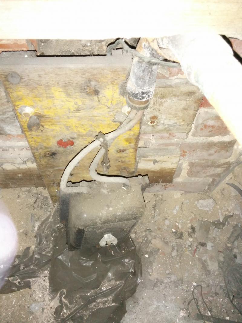

Illegal cabling(?) and strange box
The cut-out and everything prior are usually owned by and the responsibility of the DNO. Any issues should be sorted by the DNO at no cost.

The fabric covered cables look like VIR to me, they are rubber insulated with a wax coated fabric on the exterior. Don't touch them!
So, if this is the old cutout, at the point of entry,
how did this one come to get installed as well?
It can't have been done by a dodgy electrician.
we moved in about ten years ago and we had an inspection done (can't remember details now). Following that, the gentleman who did the remedial wiring and CU installation was NICEIC (I think) registered, although I'm now a little doubtful about his work.
I won't! If they are fabric-covered rubber, won't they need replacing?

You tell me! My first thought, on discovering the old metal box, was that it must have been a redundant installation - until I discovered it was still live. I had assumed that the cables that come out of the conduit near the CU came directly from outside. As the old box was hidden away under a fitted wardrobe, I can well understand that no-one else knew about it either.
When I spoke to the DNO gentleman, however, he confirmed that according to their maps/plans that is exactly where the mains enters the house.

Could well be that the new cutout by the meter wasn't the first one at that location - on reflection that wooden board looks like it's been there for more than 10 years.
But at some point in the past a DNO employee must have put the first one there.
We may find out later today if at the time the normal procedure would/could have been to replace fuse(s) in the old cutout with solid link(s) and leave it in situ.

That cutout is well past it's sell by date and really needs sorting, it's not accessible and the tails are PBJ- polybutyl jute covered. Basically rubber insulated but will probably be in half decent condition- still need replacing.
When it was installed it was probably all ok, but has been built over and boxed in etc. the dno will be able to help and at least change that old cutout!
The DNO gentleman has just visited.
BAS, yes, he said as much. Being rubber, they will have to be replaced. They may pull through the existing conduit or just install new PVC cables under the floor.
Oh, I'm certain the old box must have been there well before we came here 10 years ago. I wouldn't be at all surprised if it was put in when the house was built in the 1920s - and maybe even on a DC supply! I don't know how early AC came into use around here.
If they replace any fuses in the old box with solid links, won't that mean that the (new) connecting cables to the meter/CU won't be protected?
Taylortwocities, he did measure the earth resistance(?) which came out at 0.34 (Ohms?). He assures me that this is safe, being well under the 0.8 limit. Looking closely, there is a bare earth wire from the supply end of the conduit to somewhere behind the old wooden board. I shouldn't be surprised if they replace that as well. He did mention something about digging up outside as well - presumably that will involve our drive.

The DNO gentleman told me he'd be submitting a report (and another photograph) and that the people who do the remedial work will be in touch, although they tend not to rush too much unless it's a dire emergency. He advised me to call them tomorrow or Wednesday to see what's happening, and to tell them that my wife is worried sick. B***er that, I'M worried sick!
Good news: they will pay for it all!

I suspect they will install a new service from outside the property to the meter position following the existing cable in then via the conduit.
This will do away with the old box completely.

I am not saying that it does not need to be sorted, it does. But it is no more dangerous today than it was yesterday. It will go on being fine unless it is disturbed. So sleep well.
The trouble with old rubber cable is that it goes hard and brittle.
As long as nothing disturbs it then it remains a very good insulator (and looks fine too) but a bit of movement and cracks will start opening up. Since it's basically impractical to gaurantee zero movement (houses are not 100% rigid) it should be replaced.
