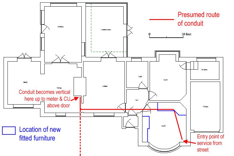

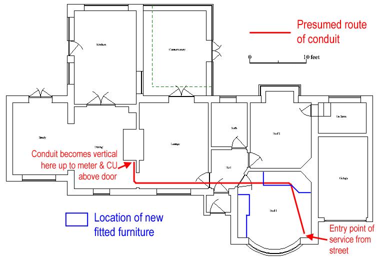

Here is a floor plan of the house showing the presumed location of the existing conduit. I am certain about the position of each end, but assume the rest goes along this logical route.

I would be surprised if ENWL drag new cables through the old conduit.
They will more than likely joint the old PILC (paper insulated lead covered) cable to modern PVC split concentric (http://www.batt.co.uk/products/view/610/Split-Concentric-Cable-BS7870)
using a resin filled joint.
But westie can advise better!

I'm assuming leaving the old conduit in and jointing the cable Not at all sure the split-con will fit in the conduit, especially where it goes round corners.
They could lay it in ducting to give it protection.
If I were planning/doing this job I would look at installing a new service to a surface mounted viewing cabinet adjacent to the meter/CU location, with tails from there. The cable to be rub underground through the garden (?)
If tail length is an issue a SW fuse could be fitted.
Other alternative would be a complete new service to the existing meter position.
No way would I try to reuse the conduit.

That sounds a lot less hassle to me, in fact before I found the 'mystery box' I had assumed that the service came in directly from the road under the front garden to underneath the meter position, the conduit visible next to the CU running straight out of the house at that point (the broken red line on this plan:)
In fact, I can't think why they didn't do it that way in the first place except perhaps, as someone said earlier, the meter and fuse box may have been elsewhere originally.
Of course, that would mean a lot more digging outside, especially as the electricity services run under the road and no pavement in front of our house. Still, whatever they think best; they're doing me a favour, after all.
But what is a 'surface mounted viewing cabinet'? Is that some modern equivalent to the old metal box under the bedroom floor? I assume there would be sufficient space for it on the board next to the meter and cutout (see earlier pictures).
Just out of interest, why do both you and SS think it unwise to re-use the present conduit?
