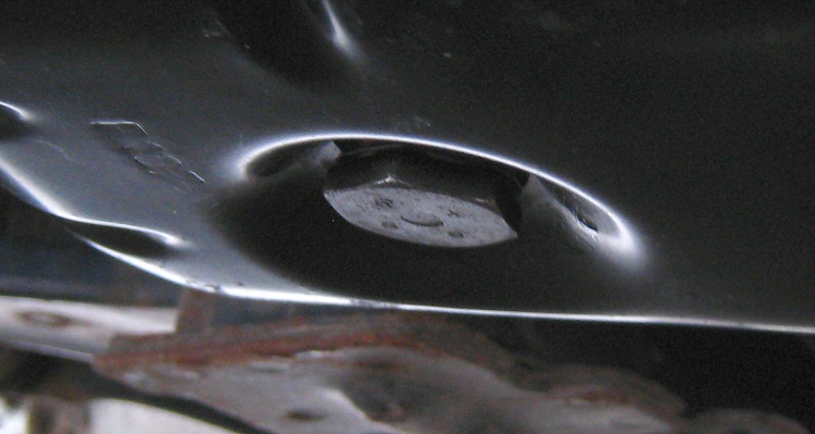

I'm scared to change the oil because I think I stripped the sump threads last time, but it needsdoin
No it's because the engines are a nightmare for oil carbonisation, and suction method cannot get it all out.
The old stuff that remains turns into sludge and solid carbon, this generally then breaks down and gets sent around the system and clogs up turbos etc
Exactly, ad this is why I was wondering if suction would get more of the old oil out. Take a look at the stupid design of the sump, the drain plug is recessed into the sump so there is no way all the old oil can drain out, no wonder the engines run into the problems they do.

I have changed the oil in it every year, but it is 11 year old now with 66 on the clock, I'm trying to look after it as I would like it to keep going. I may drop the sump next year and see what its looking like.

but with such low mileage, surely the oil is always clean and clear? Assuming you take it on journeys to get it properly hot?

Ah that's strange, I know the older ones were extroverted, and tbf that's where my experience is with them,
In this instance I would say suction method is best. What a stupid design by the oem
I heard the plug is recessed to prevent it being belted by speed bumps - whether that is true or not I don't know.
Anyway, with the DV6 if a quality oil has been used and together with a filter change every 10k or yearly it will be fine.

No, lots of short journeys, often less than a mile! but on average may be 10 mile so 70% running at full temperature.

It does seem particularly stupid that neither suction or drain removes all the old oil. Plenty modern cars come without sump plugs, but presumably their dipstick tubes are open ended and fit into the lowest part of the sump.
