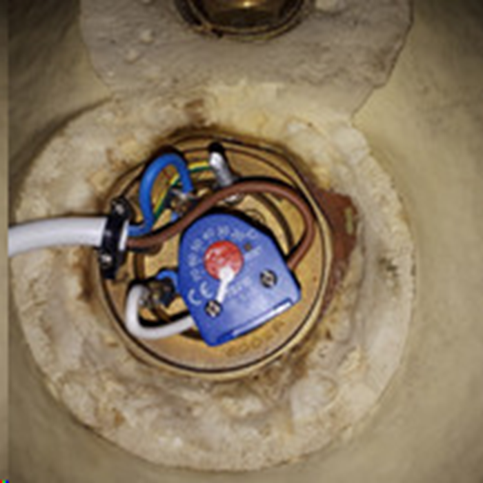

Hi, just had a new immersion heater installed after the old one self destructed. Anyway, after a few hours of it being on, no hot water.
Measuring between N and the L entry side of the thermostat I get 240V. Thermostat set at the default of 60, measure between N and T/output of thermostat and get 0V.
Measured resistance of the heating element (having disconnected everything) getting 18ohms, which is in the right ball park.
Measuring across the thermostat, nothing no resistance, and no continuity. So effectively open circuit. Which would stack up with 0V between N and the thermostat output. Tried pushing the reset button, but nothing changed.
So chalk it up to a duff thermostat. Given we've already had 48hrs of no hot water, I was dispatched to screwfix to get a replacement. Thinking, if it's the thermostaic I'll just swap it, rather than empty the tank, swap the heating element.
5 mins to swap the thermostat, and nothing. All values as before, nothing coming out of the back end of the thermostat.
I've tried pushing the reset button, but doesn't seem to make any difference. Anything else I can try before I start to cry?
Thank all.
Very odd ,two duff thermostats ,but not impossible. With the stat not fitted ,but on the bench ,if there is no continuity across its two terminals it is duff !!
Yep, well stat in situ, but nothing connected to either side, so functionally the same as just on a bench.
Guess it's the just because it's new, doesn't mean it works.
show us photos of the connections please
Hopefully this will work
Left the heater in situ as that seemed to be ok, and wasn't going to start messing about with changing that.
Tested new thermostat in car park, and seemed ok. All now installed and we have hot water.
Guess the lession here is, just because something is new, doesn't mean it can't be faulty.
Thanks to everyone who's commented and made suggestions.
