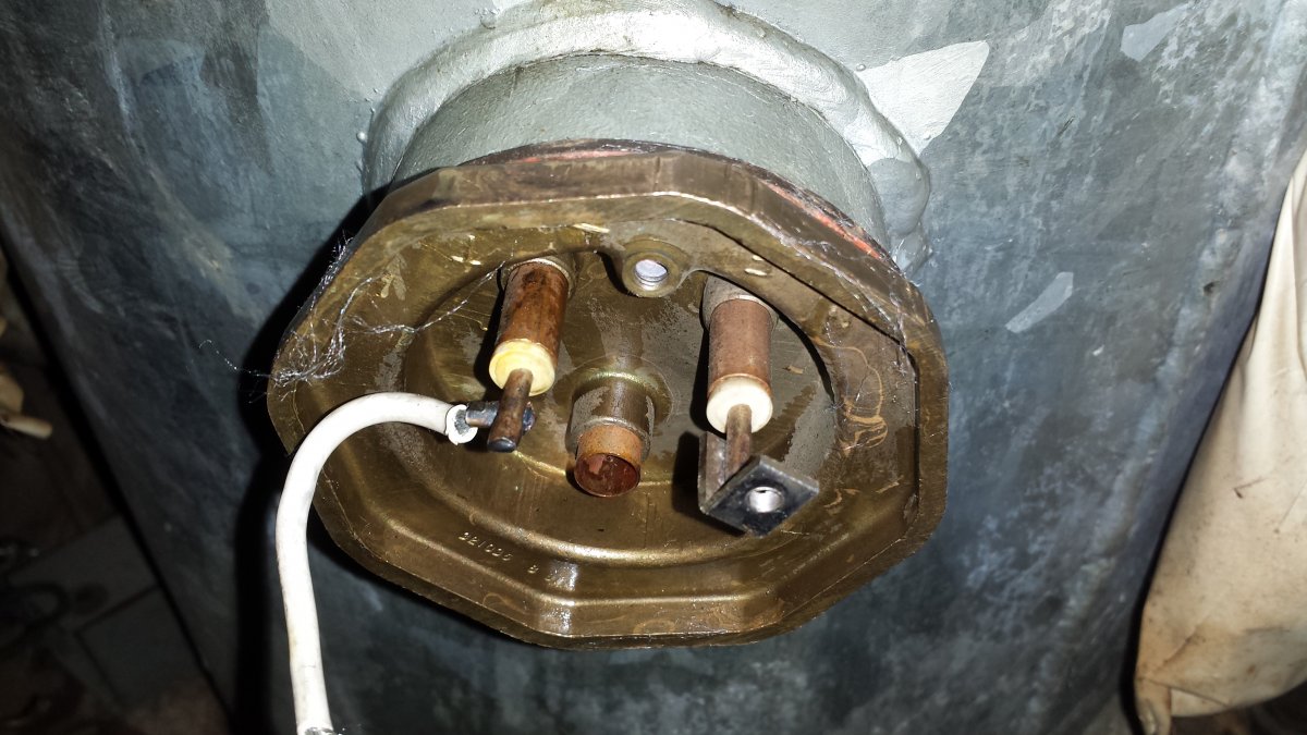

Immersion heater not heating?

I'm not having a lot of luck with removing the heater element - seems stuck!

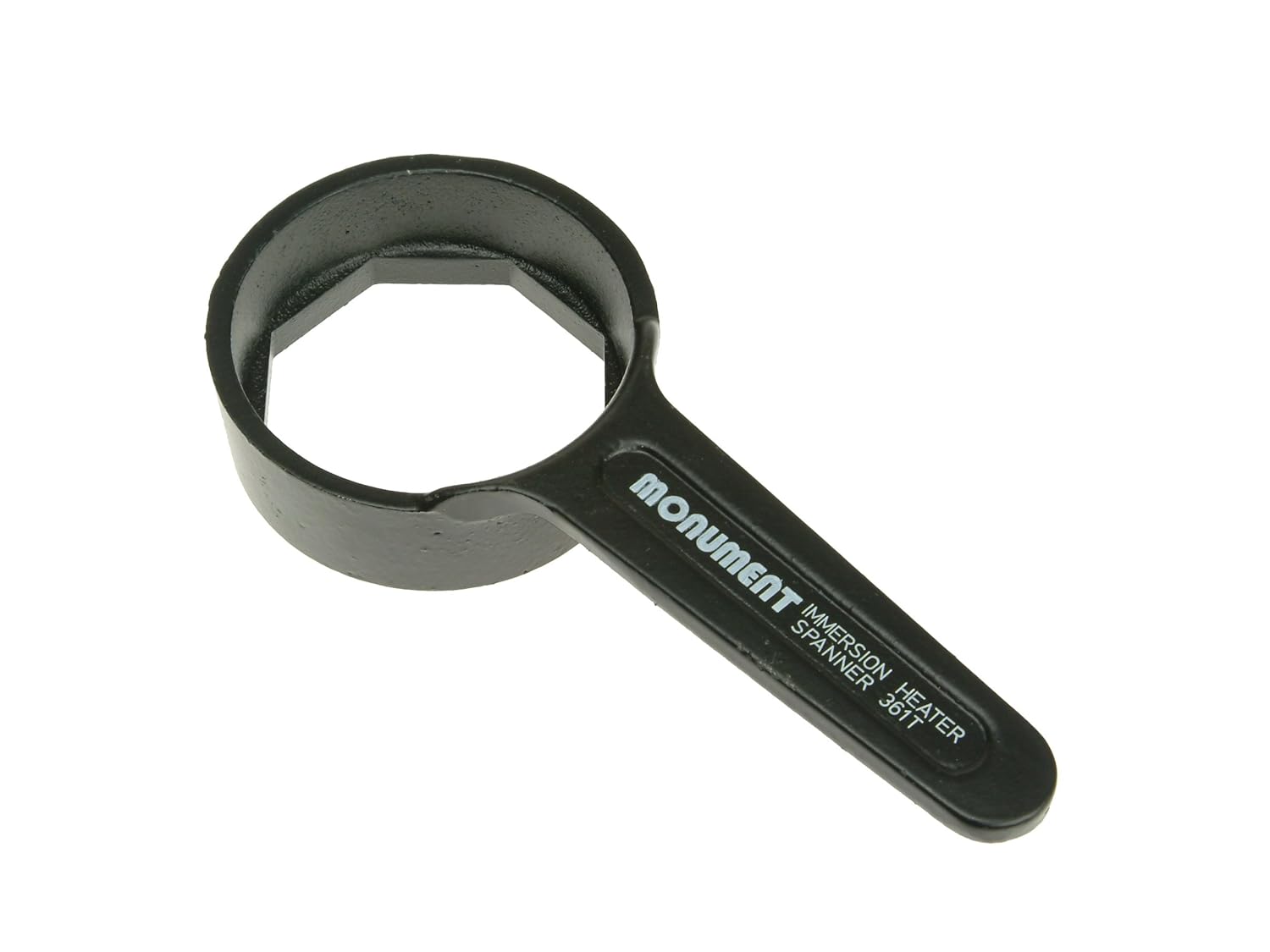

The box spanner also does not have a tight / snug fit - any suggestions?
Would the flat one work better? I guess they're all the same size?
These diy spanners are just made from folded or light weight metal....I'm not surprised you are having bother, unfortunately.
Use the other spanner, but we weren't kidding about the stilsons!

A large set of Stilsons or a Plumbers Chain Wrench plenty of WD 40 and a few taps with an "ammer" on the handle of the wrench should move it !
I'm giving up.
What's the point of spending £30+ on a tool I'm only likely to use once (one with 85mm jaws?).
How much will a plumber cost to unscrew this thing?
A plumber with a set of Stilsons will have that out in no time.....if it was a copper tank there would be every chance it would be wrecked, but as its a steel one there's every chance that it will undo.
