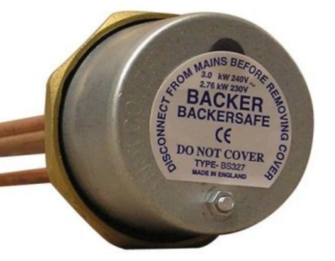

What brand/ make is it ? Is it GreenBrook (kingshield)

Here we go again. The UK voltage is 240v and has been since nationalisation. (Some idiots decided to call it 230v a while back but nothing has changed). His immersion heater is most probably rated at 3kW at 240v so Harry Bloomfield is correct.
Yes, Harry and Winston are correct.

Thanks All and especially EFL for the photo evidence to confirm that what I knew was correct, was in fact correct. I have not seen many immersion heaters, but all of those I have come across have been rated 3Kw at 240v. I have come across JohnD's argument that the rating is 3Kw at 230v before, but I have never seen such an immersion heater in the UK.
