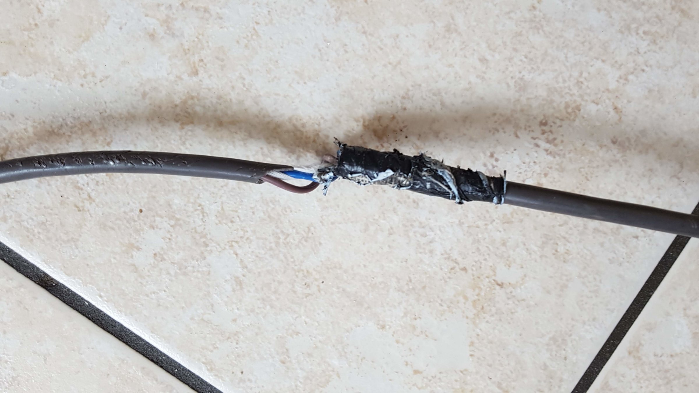

We found damage in our rental property recently and determined the tenants have a rabbit and it has been nibbling its way through carpet, skirting and plaster walls. However, it has also damaged the outer sheath on the power cable on the tenants own lamp and vacuum cleaner as you can see in the following photos.
It looks like the vacuum cable has been damaged and patched up a couple of times.
I have discussed the damage with the tenant and verbally warned them about using these appliances without replacing the power cables and I'm just about to put it in writing, however, a quick Google hasn't really found anything tangible about what this kind of cable damage could cause.
It seems to me that the damaged cables could result in electrocution if any of the wire cores are exposed (I couldn't see this) or fire, and it may also affect insurance policies (knowingly using an appliance with a damaged cable).
Am I correct to "forbid" the tenants from using these appliances in my house or am I being unreasonable? Could these cables actually cause a fire and if so, how would this happen?

Tenants own items = tenants own risk in using them.
Other than warning these people, there isn't really anything you can do.
I wouldn't worry too much about fire.
In your shoes just make sure the house has RCD protection, and it has been tested by pressing the test button.
That should cover yourself I hope
The tenants would have to be rather bloody stupid to not want the flexes replaced. I have no time for such stupidity so I'd just let them kill themselves.
The large damages to vacuum cleaner flex was possibly caused by being mangled by the brushroller.

Speaking solely as a Portable Appliance Tester, that Dyson would receive a Fail, Do Not Use sticker. If ANY of the coloured cores of a sheathed cable/flex are exposed, that is an automatic fail.
HTH
