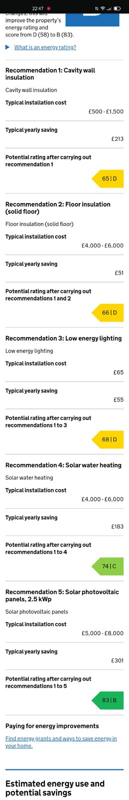

Hi all,
I've recently read that the government are thinking of forcing households to have an EPC rating of at least C.
Article here https://www.thisismoney.co.uk/money...-1-7-million-homes-owners-face-penalties.html
Mine currently has an EPC rating of D, but can be made to be a B.
This was rated when i bought the house 2.5 years ago.
The house already has cavity wall insulation and double glazed windows. There is insulation in the loft, the hot water tank is already well insulated.
Since moving in, I have installed a high efficiency boiler, an opentherm smart heating system, changed all the bulbs to LED ones except the strip lights in the garage ( I have plans to remove these).

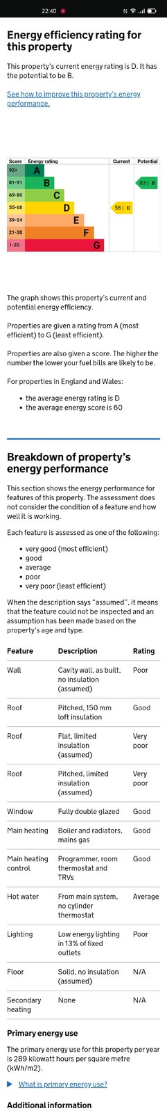

I've found the copy of the EPC for the house when I bought it, and it appears some things have been wrongly assumed, (I know the property has cavity wall insulation as I've seen it first hand when drilling through.)
I don't think I will realistically be able to get the EPC to a B as one of the recommendation was to insulate the solid concrete floor (the cost of this I'm pretty certain would never be outweighed by the energy efficiency I'm sure)

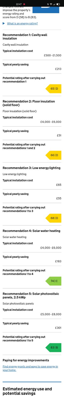

These are the recommendation from the surveyor.
It's quite an expense to get the property to a C grade by the sounds of things..

The EPC can only be as accurate as the information provided.

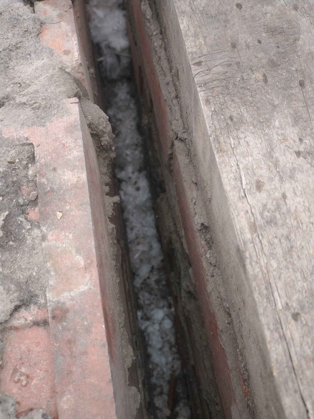

I've recently been replacing the roof on my house and have noticed a few "issues". Firstly, the cavity wall insulation, installed about 8 years ago. It has settled in the cavity - in some areas it was nearly 600mm from the top of the cavity:
Secondly, the loft insulation, also done 8 years ago, there is a gap of 3-400mm in the eaves where there is no insulation:
In the second case I understand the potential for interfering with ventilation, but this can be managed with care (and in my case not an issue as roof was not felted).
Basically, I had an uninsulated area of about 800mm all the way round the top of my house and I can imagine heat pouring out, I think the only reason we didn't have extensive condensation was that the house was so "leaky" in other areas.
I read recently that the predicted energy savings from these measures are not actually been realised - I can see why, when you compare my (presumably fairly typical) installation with the "laboratory" version on which the figures are based.
Obviously 99% of people have no interest in their EPC - if they did, and compared their actual energy consumption to that predicted they would have a shock.
I would be interested to know if the BRE (or whoever does it these days) actually gets out of their labs and compares before and after energy consumption in real houses, where there are issues like mine, or where people flatten their loft insulation when they board it out, or turn up their heating a bit because the new boiler is cheaper to run.
