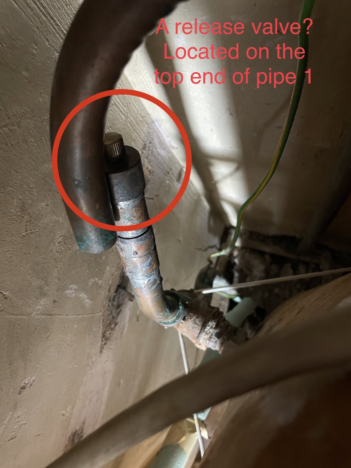

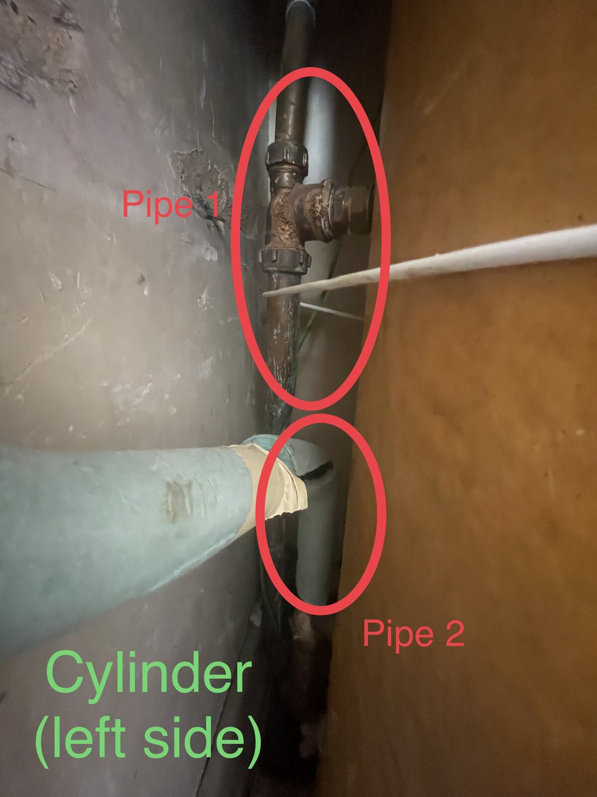

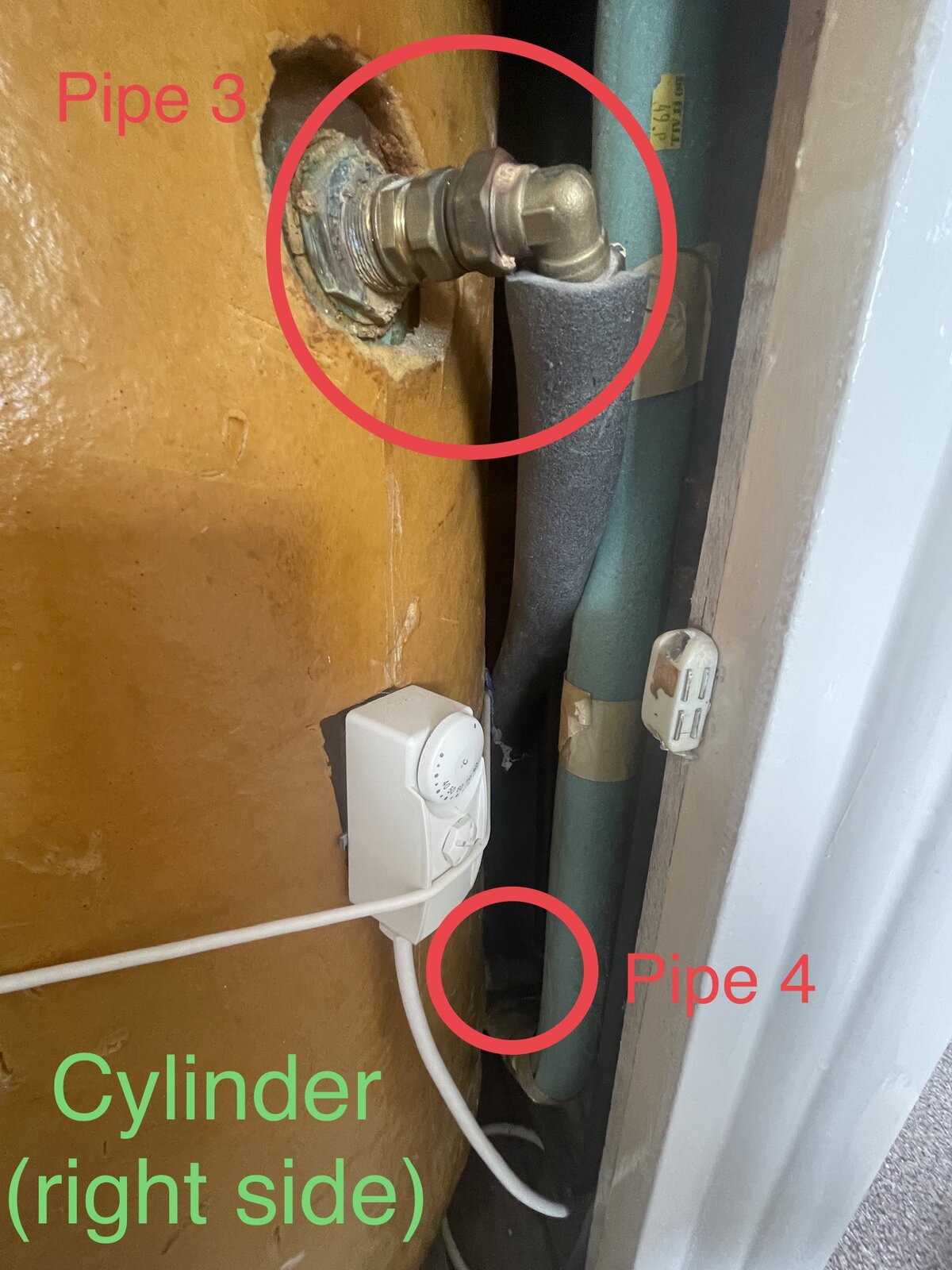

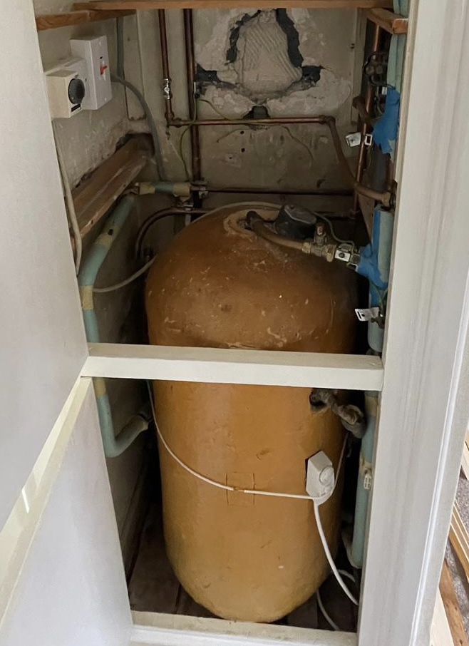

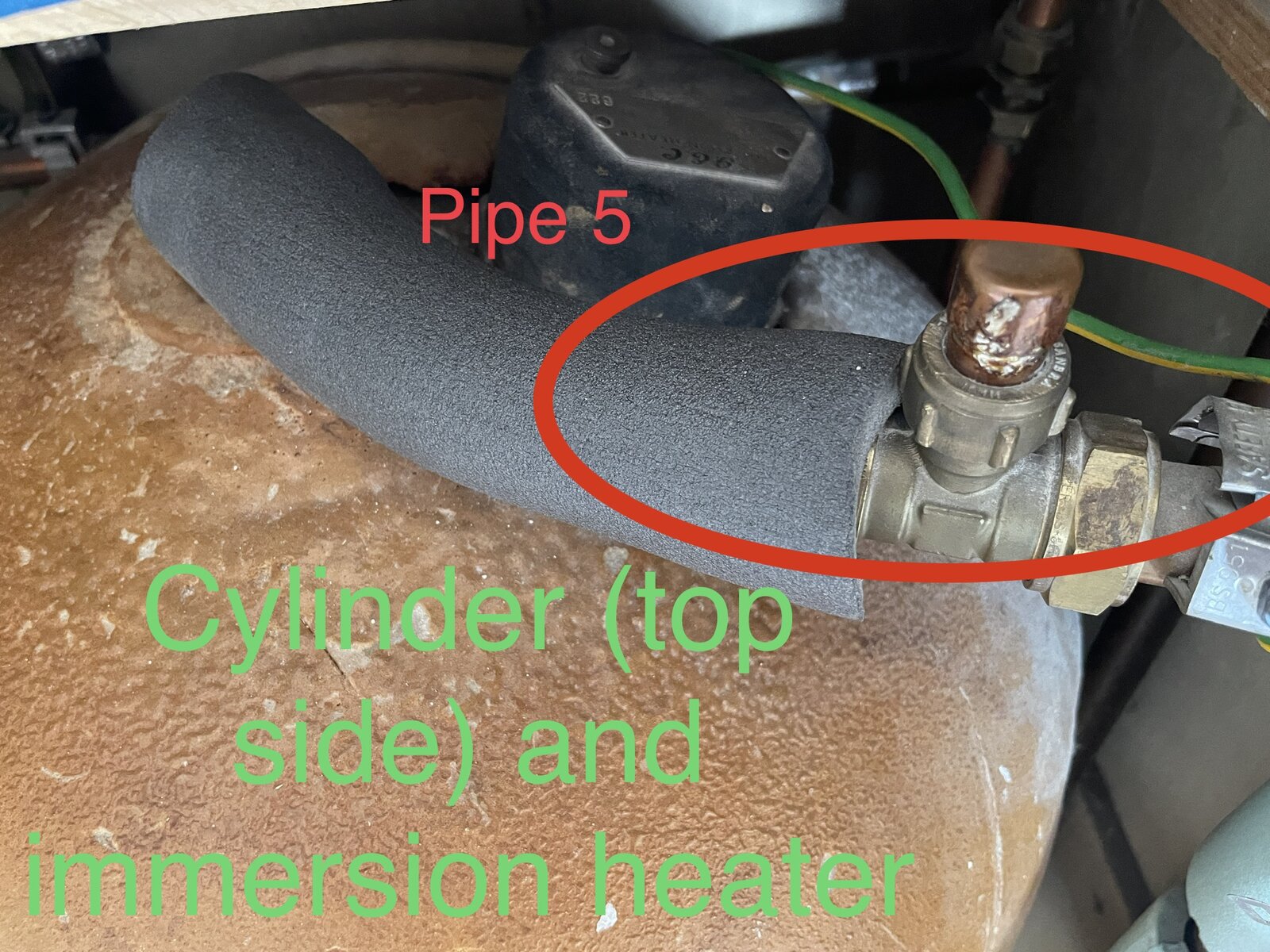

I identified five pipes that go into the cylinder. I took some photos of the cylinder to show the current set up.
Pipe 1 and pipe 3 are warm to the touch. Pipe 3 enters the cylinder at a slightly higher position than pipe 1. Am I correct to say pipe 1 is the coil return pipe? I can't find any wheel valve near pipe 1 but there is a turn knob (a release?) at the top end of pipe 1 above a T junction.
Pipe 2 and pipe 4 feel cold.
Pipe 5 is the hot water exit that connects to the taps if i am not mistaken.

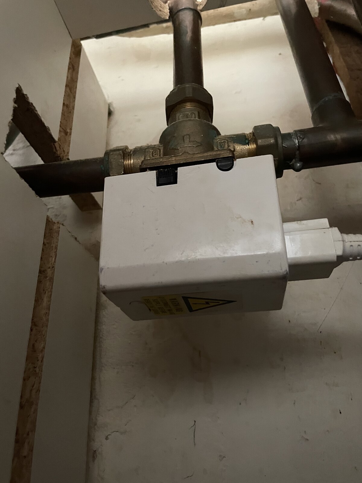

Is any heat reaching the other radiators? If the 3-port valve is old and worn out, this can happen.

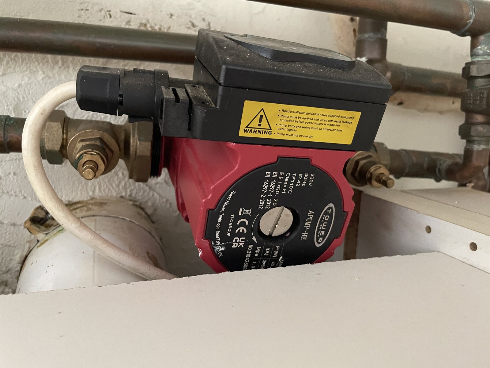

I don't know the limits of the heat exchanger coil in a yellow cylinder. If it was only 3kW, it would take about 2 hours to heat 120 litres. There might also be sludge in the pipes. There will be losses from poor insulation. Presumably it is fully pumped? Please show some photos of the pipes, cables and devices around the cylinder.

I believe the current setup is a Y plan. the boiler is located on ground level inside a kitchen cabinet. i can find a pump right above the boiler and there is a 3 port valve to the side if i am not mistaken.
the radiators in the house run reasonably.

What is the T piece circuled in Pipe 1 photo?, is it a valve connecting pipe 3 (coil inlet) to the pipe return which should be near the bottom of the cylinder.
Stand back and take a pic showing the entire cylinder and all its pipes, cables and accessories please
In your image 6044 it looks as if the cylinder stat is resting on the insulation. It should he touching the copper cylinder. This is done by cutting a rectangular piece out of the insulation to fit the thermostat. Use a round-ended table knife, not a pointed knife that might puncture the copper ( it is a soft metal, and very thin).
Here is a picture showing the entire cylinder.
Shall attend to this. Thanks for pointing out.

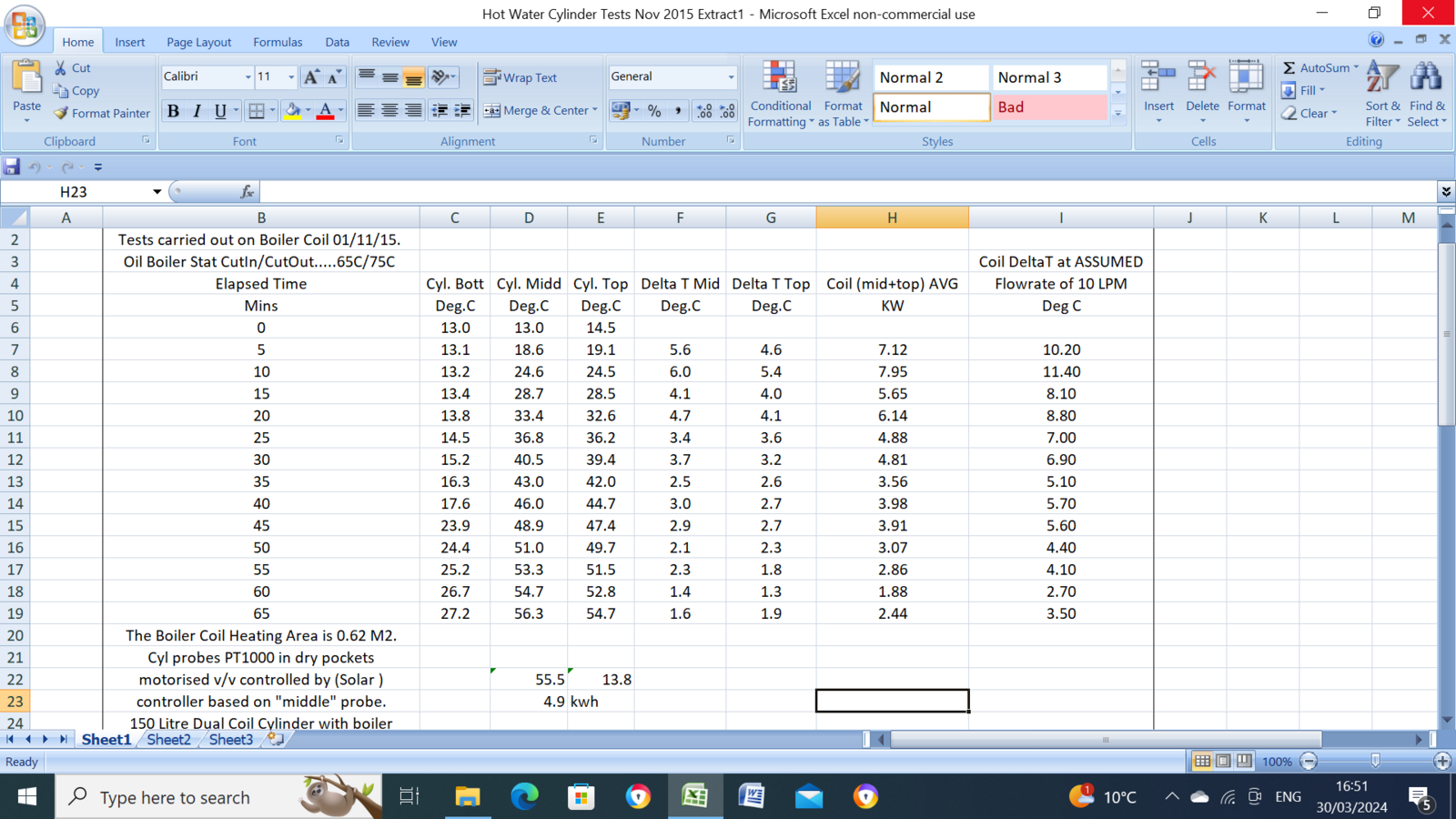

From personal experience, with a couple of cylinders of that age, I don't think 1 hour 20 minutes is out of the ordinary to reach 60C with a flow of 70C.

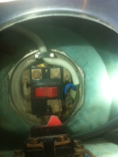

Here is my twin coil cylinder, with solar coil in the bottom and the oil fired heating coil heating the top 100 litres, its still performing the same but I have very soft water (no scaling), that cylinder replaced a 1972, 120L one in 2011after 39 years, the electric dual immersion elements were like new so I transferred it into this present cylinder, this immersion is now 53 years old with the sink/bath c/o switch on the top of the immersion!!. luckily I only use the sik element.
