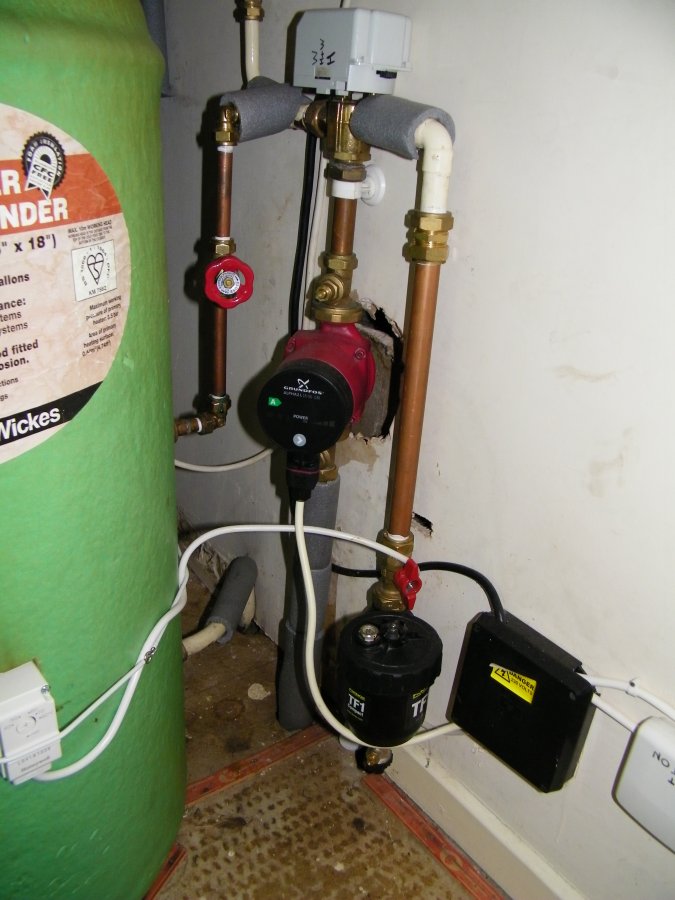

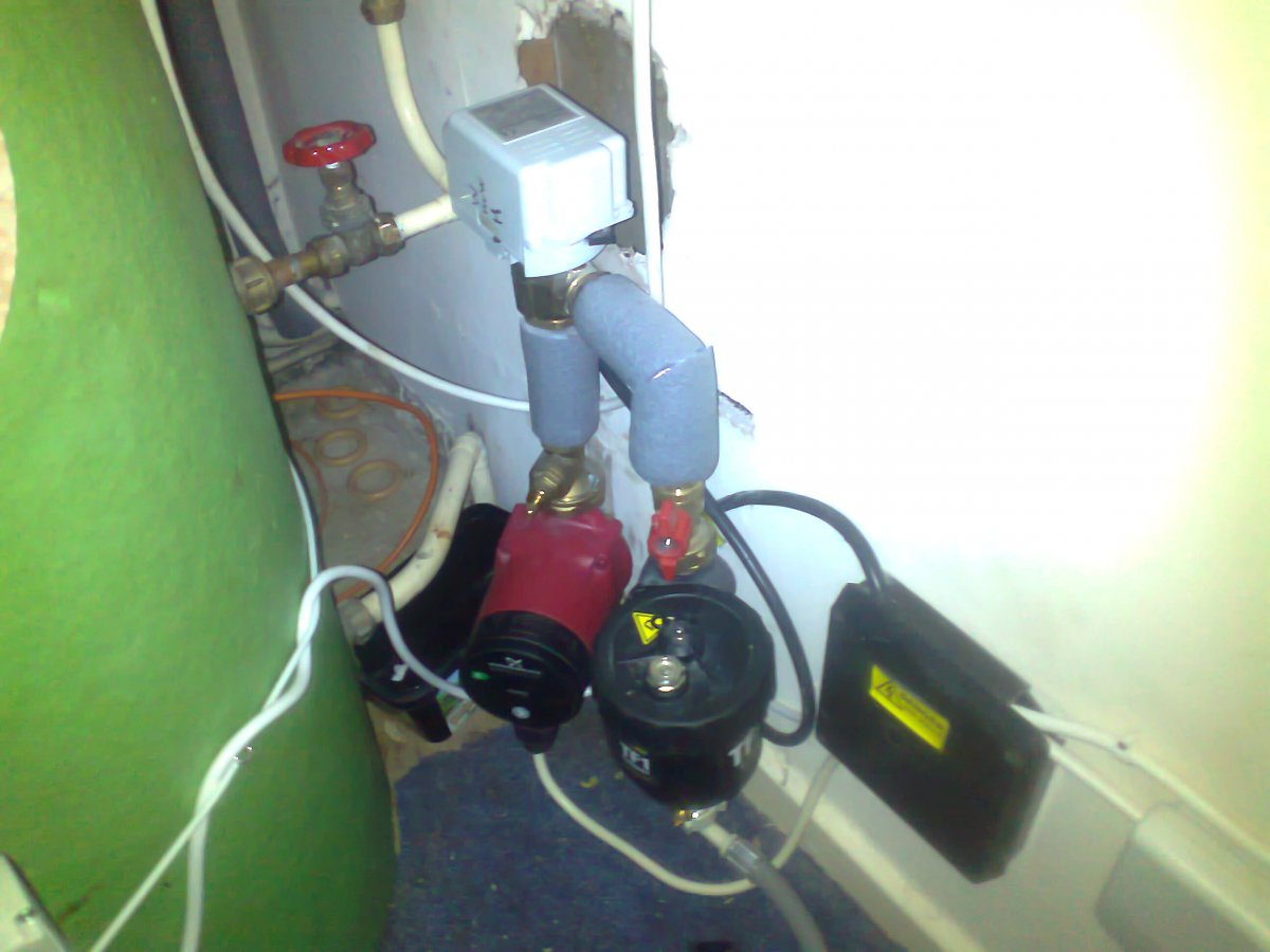

what about the airing cupboard plumming i recently raised the pump a foot because it was touching the floor and i couldn't get a spanner on the bottom nuts - could that be a mistake and make the system worse ?
here's a before and after
How far is the "bend" in the vent pipe above the water level in the F&E tank?
It would be better if the vent and feed pipes were both coming off the horizontal pipe, i.e moved to the right in the current layout. In the current arrangement, with the vent pipe a straight vertical run there is much less resistance compared to going round the bend, so water will want to go straight up.
Balancing, done correctly, will reduce the need to have the pump running fast. Contrary to what many think, water does not have to be "pushed" through a radiator; it goes through naturally because the pressure at the return connection is lower than the pressure at the flow connection, i.e. the water is "sucked" through the rad.
You don't need a bypass as you have a mid-position valve which means there is always an open path for the water to circulate.

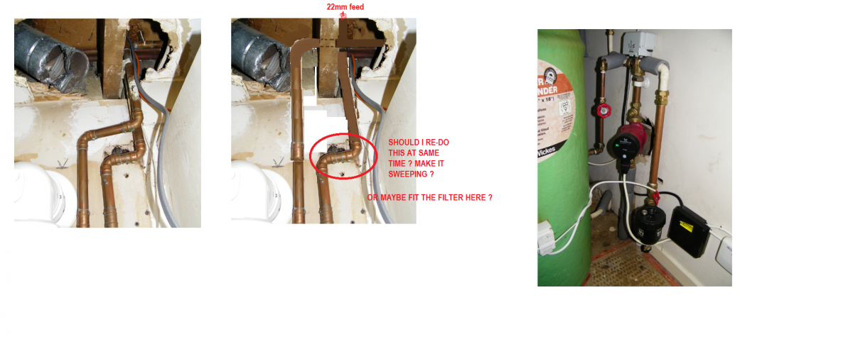

what i will probably end up doing is re-using the 22mm copper pipe that's already in place for the vent and either use it for combined feed and vent or just re-use it for the vent.

this is what i was thinking of doing :
I would leave the Feed and vent as is, filter can be fitted where shown current layout (but better on the return (if anyone doubts, check Megnaclean installation sheet)
I woukd also look at the pipe between vent and feed n the flow
Why is the filter so low near the floor?
