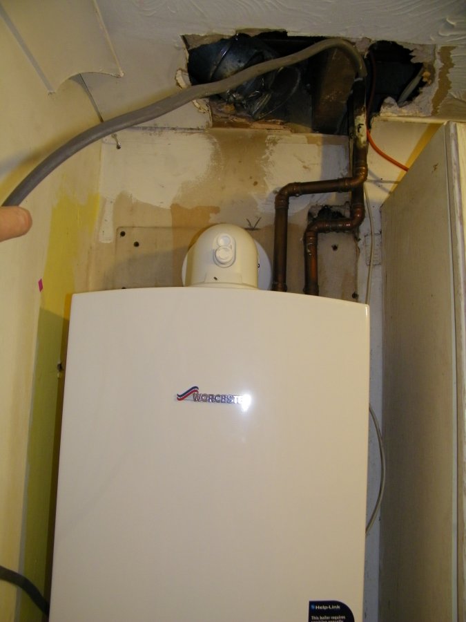

improving pipework for feed and vent
filter is low because the pump used to be very low , i raised the pump and valve recently because i couldn't tighten the pump fittings, i left filter where it was,
the filter is a fernox compact one and it says can fit on flow but better on return., i plan to fit boiler in a kitchen cupboard so i'm not sure about filter yet, filter is handy there because it catches air before it goes into the rad pipes.

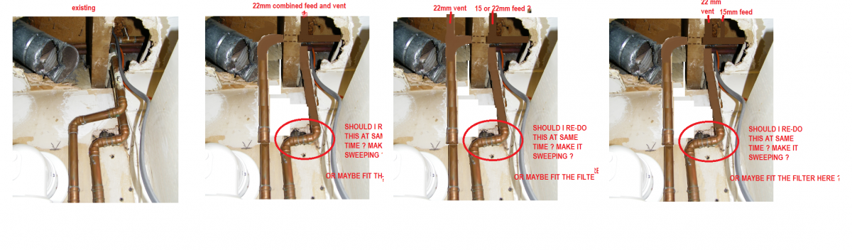

i guess if the Tee's and surrounding pipes are a bit blocked i will replace and keep separate feed and vent, but if they are clear guess i'll combine them.
the worcester manual shows a picture of seperate feed and vent.
so are these my best options ?
what about those elbows on the returns ? is it worth sweeping those a bit better ?

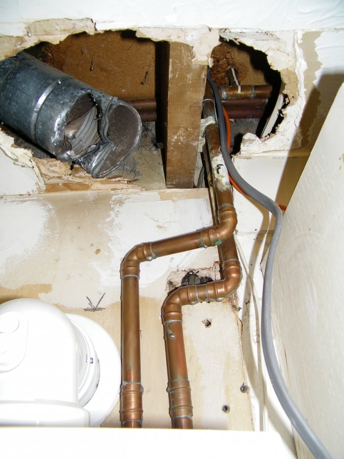

i don't understand what you mean, here's a few more pics:
some of the drawings i have added are not proper photos but proposals drawn using windows paint.
Is the vent the tee on the flow and the feed on the return?
If so try and follow it through logically.
It goes feed, boiler, vent, pump. The vent will be subjected to negative pressure because of the pump and will suck air in.
no all connections are on the flow pipes, it goes : boiler, 22mm vent, 15mm feed, then pump is about a meter away.

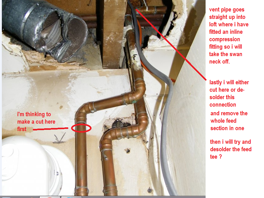

this is what i'm thinking to cut out :
i will remove some more of the kitchen ceiling and just make sure which pipes run to the pump.
appreciate your help, i will post back tomorrow with some pics of inside the pipes

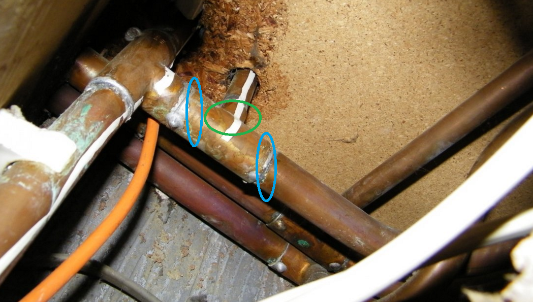

so where abouts on the cold feed do they get blocked ? at where i have marked the green circle or the blue or does just everything get blocked ?
if i'm combining feed and vent i may just re-pipe everyting from the boiler rising to the pump, depends if i can borrow a decent pipe bender,
there's a poor bend where it comes through the floor into the pump - the bend has ripples/crease marks on it and there's another compression fitting between that and the pump i could remove , difficult to decide what to do until start working on it.
i want to combine the feed and vent if possible , it will end up simpler and easier for me to do, as long as the system fills ok , the boiler does have an over temp. cut off. one thing that was quite handy is when i had any airlocks when filling i used to blow down the vent pipe and free it all up.
anyway i'm jumping the gun abit first thing is to see if it's blocked or not

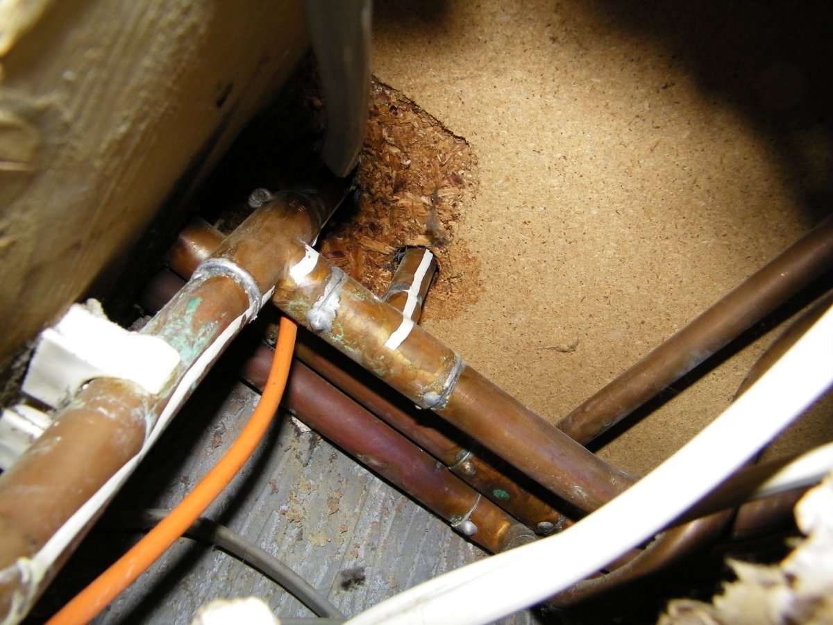

so how can i clean it without cutting it ?
i don't really have a pumping over problem now , it's more air in the system i want to sort out and if combining feed and vent helps with that even if it makes system slightly less safe then i'd rather do it.
the air vent on water side does collect some air but i thought the pump was running too fast and air passing past it.
i don't know, i'll cut the connections out and see how blocked they are.
