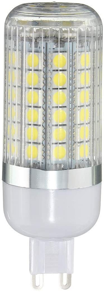

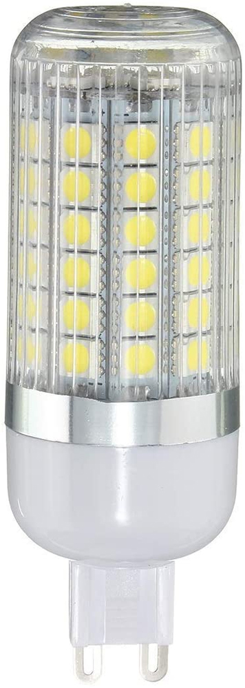

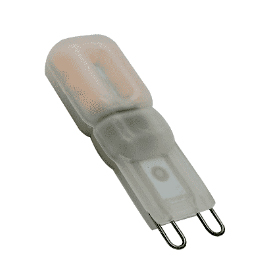

But LED's flashing when switched off and shimmering when running has been a problem, swapping bulbs did cure it, oddly using cheaper ones, but to say change to LED is easy, but to actually change, if all BA22d bulbs OK, but with GU10, and G9 I have found problems.
I presume you mean infrared output rather than a deduced output......the tungsten bulbs did this with the inferred output,.....

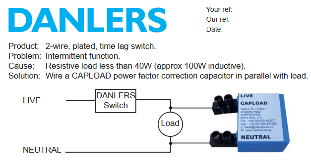

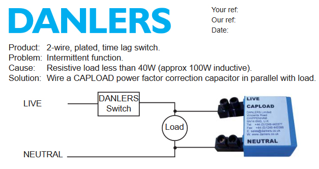

Shimmer when on, flash when off, we have wifi switches in bedroom so can use a remote by bed to turn lights on/off, easier than rewiring with two way lighting, these bulbs were a problem, both would not switch off and shimmer when on, the switching off cured with one of these which leaks away the slight current through switch which causes the flash then wife got these, far bigger and the covers will not fit over the bulb which is about same size as a E14 bulb, even when G9, within a day one failed, got replacement and decided to open the failed but to see what was inside it, and found a dry joint, so fixed and went back into service.I'm all LED, but none of mine shimmer when off.
