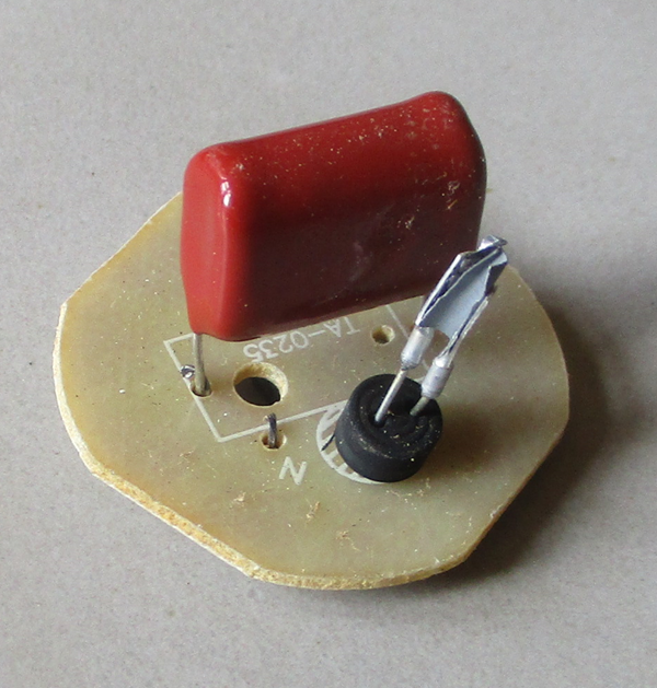

Even the cheapest of LEDs seem to usually have some sort of fuse inside them, which will usually blow before anything else does.
They tend to use a resistor, which will limits the short circuit current - a trick I sometimes use, where normal demand is low, but on a circuit with a relatively large current behind it. Resistors are much cheaper than fuses.

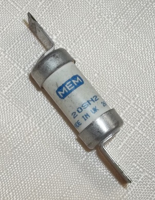

This 20 Amp SN2 - HRC Fuse Link
was blown when a one Watt Golf Ball lamp self cremated itself. It was one lamp in a bandolier of 60 lamps in the village Christmas decoration. It was a surprise that the fuse went but at least the cremation ended before more serious damage was caused.
... and little bits of foil probably even cheaper. I can't say that I've seen resistors used - as I said,usually little bits of foil (which have usually ruptured by the time I dissect them). This one is not quite as flimsy as many are, but it's roughly the sort of thing I'm used to seeing ...
'Self cremated'?
That sounds bad. Did the bulb melt or something?
I am not sure as to exactly what happened. The lights went out one evening and next day we found the fuse blown, replaced it and the bandolier came back on; When the lights were taken down there was one socket with only the metal bayonet cap from the lamp.
