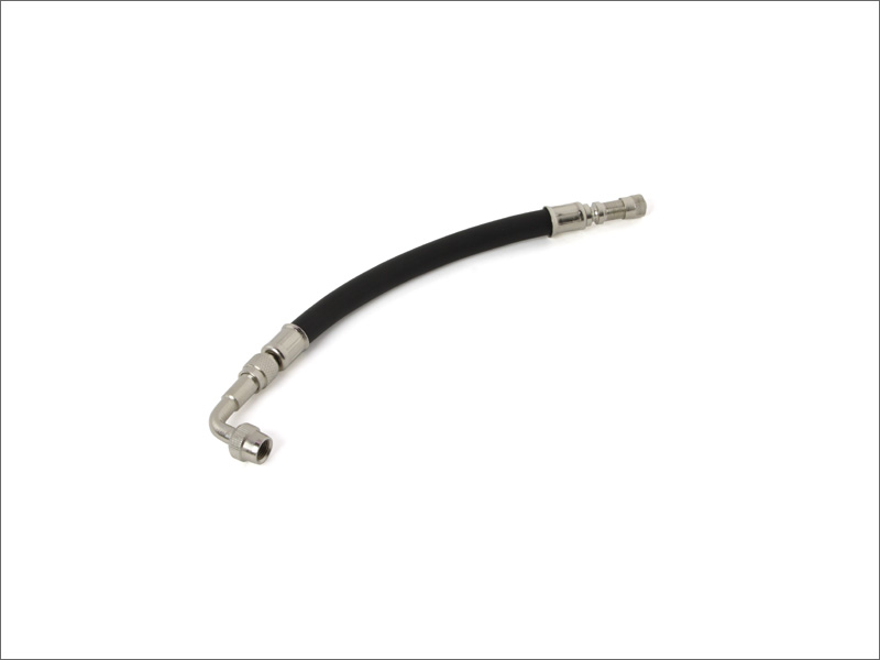

Nope the boiler would've been shipped with an orange plastic cap blocking the expansion vessel connection. I would say the OP is probably right and there's been air trapped in a couple of the rads.
Will be interesting to see how you get on as constantly running at higher than expected pressure won't have done the tupperware boiler any favours :(
Sounds like BG engineer has left his extension hose for charging the vessel on the vessel TBH ;) Let's see if I am right.
That looks very much like the pipe I saw - it was attached to EV but the other end just hanging in the air.

It just stroke me - how could the EV have been incorrectly installed (not connected) if the second engineer*) who came a week ago said the EV pressure was toll low ~0.5 bar and he managed to re-pressurise it to 1 bar? If EV were disconnected, would he managed to re-pressurise it at all??
Could it be that EV got disconnected itself due to the incorrect boiler operation (faulty prv, e.g.)?? Please explain.

I also think that the BG engineer left an air connecter as pictured on the EXV.
The Worcs I saw yesterday had a braded permanently fitted connection between boiler and EXV.

Most smaller Worcesters (i's until last year, iJuniors, Si's, Compacts) over the last 10 yrs have the expansion vessel on the backplate, separate from the boiler. You have to connect one to the other during the installation process.

Tony I fitted well over 500 Juniors and I can tell you they forgot to connect up the expansion vessel that's what the orange plug was. We've all done it at some point. If there was enough air in the system he wouldn't have noticed.

BG can and do very occasionally leave the EXV disconnected. Obviously it's an over sight by the fitter but certainly it happens.
I've come across a few, some have caused issues like the OP has. Some I've caught before it was noticed and discreetly fitted it correctly.
