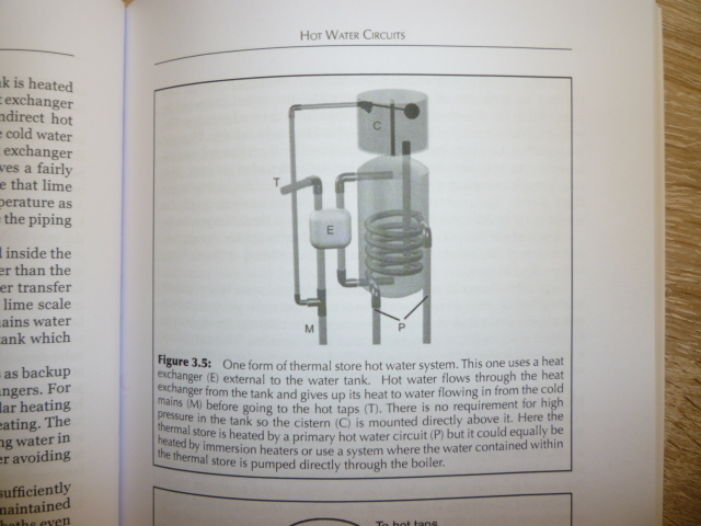

I've just been reading a book titled "Central Heating" written by Patrick Mitchell. It's a really good book with lots of information I must say.
On page 48 and 49, an example is mentioned:
"the water in the mass storage tank is heated indirectly by hot water from the boiler passing through a heat exchanger at the bottom of the tank as is found in a conventional indirect hot water cylinder. The hot water for the taps is taken directly from the cold water mains supply and heated by passing it through a second heat exchanger external to the thermal store tank. This arrangement involves a fairly complex control and pumping system but has the advantage that lime bearing water from the mains is not heated to as high a temperature as the water in the tank. This avoids lime scale deposition inside the piping carrying mains water."
So, does anyone here have a such a thermal store? Is it any good? What are the pros and cons?

Are you saying that your arrangement is a conventional indirect hot water cylinder but with the addition of a secondary heat exchanger (coil internal) for the shower?
What I was talking about is an external heat exchanger (see diagram below)
It is said that the principal of thermal stores is that a large volume of water is kept hot; not to act as a hot water store but rather to act as a heat store. Thermal stores are normally kept at 70 deg C or more. This is too hot to pipe straight into the hot water taps.

Makes one wonder where they think the water in the tank came from. :rolleyes:
See the diagram above. It's fed from the cold water cistern above.
But where does the old water in the cylinder drain to? Manually? How often?
Because it's the primary system water. Unless you are actually talking about Bernie's contraption, which is nothing like the one you displayed m
