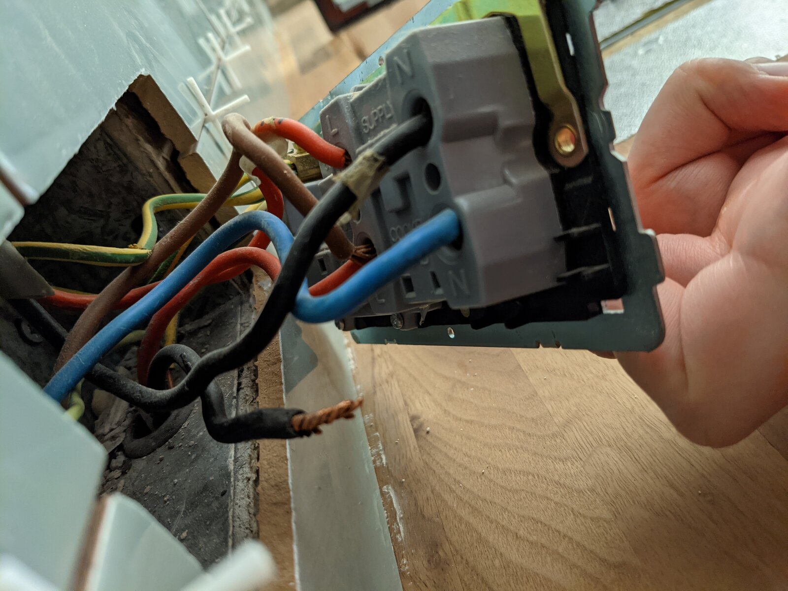

Induction hob - "no power between live and neutral"

Ok, so update. I switched the sockets off at the fusebox and started checking the wiring and got a bit of a surprise when things started lighting up!
Turns out the hob is actually on the cooker fuse and is operated by the switch, as below. Looking behind the faceplate of the switch, there is a loose black wire. Where does this need to be wired back into?

Same place as the blue.
At least it looks thick enough.
Don't really want lots of copper exposed
Andy, the 2.5 was what I was talking about.
The OP needs to make sure the load on that cable does not exceed its maximum, or if it does, to replace it with something more suitable. Now we can see 6 milli leaving the switch, there has to be a joint between the 6 leaving the switch and the 2.5 and the appliance flex, which is not ideal, even if the terminations were in keeping with regs, which the ones we can see are not.
Well the hob is working which was my original concern but what can I do to bring the setup up to scratch on this?
