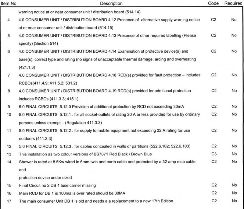

Our old house, which is to be rented, has had its first electrical inspection. One of the things they are saying is that the CU needs to be replaced, to meet the 17th edition......
The existing one has MCBs, not fuse wire, and RCD protection, and is not faulty so they say. So, in layman's terms, why might a CU need to be ripped out and replaced?
I know there might be a zillion reasons but there is nothing else in the report to suggest why a new CU might be needed.

Here is the summary of the report. Sure, there's stuff that must be needed but they are quoting a total of over 2K to sort it all out, so I need to see why I am forking out on all that work!
As a landlord the government web site makes it clear that safety must be ensured, not that some certificate is needed. How much of what's on there is a safety issue, in your opinions? I really dont want to sidestep my responsibilities but I am also wary of work that MIGHT not need doing.

I would employ your own spark to do his own EICR and go from there.
Does it have a generator switch over or two sources of supply? One of the c2 comments seems a little bit odd.
Do people normally write reports like that - it sounds like the work of a mindless robot?! Items 14-17 are the only ones which appear (at least to me) to actually state explicitly what the alleged problem with the installation is - items 1 to 13 seem to just be statements (in some cases not very specific) about regulations/requirements, without any explicit indication of the manner in which the installation is alleged to have failed to satisfy the requirements. IN many cases, one can guess - but one surely shouldn't have to?!!
Quite apart from the questions about what is wrong with the installation and what, if anything, needs to be remedied, if I were the person paying for that report, I would be seriously unhappy with the way in which it had been written!
