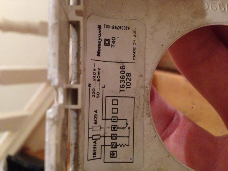

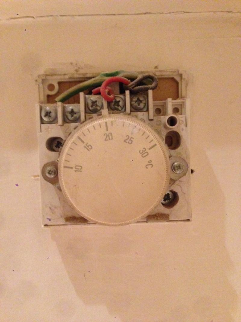

So currently we have a Honeywell T40 wired as below:
So first up - just out of interest how can i ascertain whether the current honeywell is/was working? Not that I'm (yet) too skilled with a multimeter - but with it set to 500v AC, I seemed to register no voltage at all across any of the terminals shown in the pictures - does that mean the thing isn't wired up - or I'm using the multimeter wrong? The temperature switch does 'click' around about the right temperature - but the boiler doesn't respond - is the Thermostat a bit mechanical? Surely switching the thermostat all the way down should stop the boiler from working?
Well, one way or another that's going - its just whether I then wire the new Nest Thermostat to that or plug it in somewhere else.

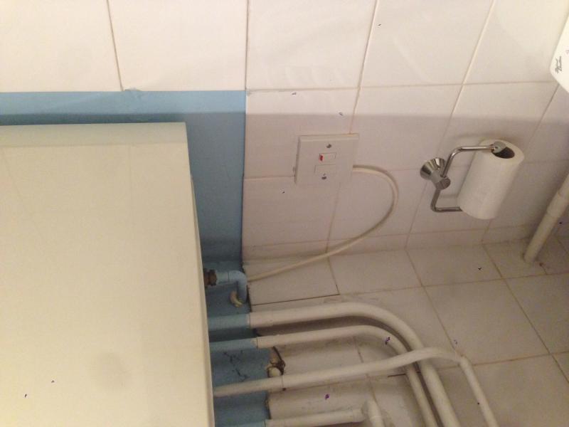

So the first question is do I have a junction box? Here's a picture of the bottom of our boiler. I don't see any external boxes so I'm guessing the thermostat is somehow wired into it. (I would have thought somewhere I should see wires coming in from the T40 - but i cant see anything - perhaps they've been cut?)

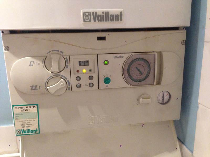

So I guess, after switching off the power I unscrew the main control panel:
which flips down? In the middle of this I should see a bunch of wires as per the wiring diagram found in the installation manual:

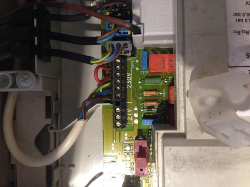

Flipped open the main unit on the boiler today, picture below:
So i think Nest will wire into 3,4,5
Would I be right in deducing that the lack of any wiring there indicates that the thermostat (as previously described) definitely isn't wired in (and appears to be redundant furniture in the house)?
The red linkis where the stat should be wired to so the wife was right the old honeywell does not work!
The lack of any measurable voltage at the original stat is probably because there is no Neutral on 2 to measure the voltage via lives on the red and black.
which also probably is why your original stat was not working as expected.... perhaps!
if you are unsure of the connections probably best get sparks in... no offence but pcb's can be an expensive mistake!

Right - well that solves that. I guess I pull the old Honeywell of the wall.
Whats the best way of dealing with the wire on that thermostat - bit of insulating tape and leave that there - or gently pull and see what happens?

Your original stat should have a neutral connection to make it more accurate, otherwise fit a stat designed for 2 wires only. A common fault on the Honeywells is for the plastic to split meaning the knob rotates out of sync with the spindle.

Unless i have a mental block then the honeywell is NOT wired to the boiler at all!
Also with most multimeters if you was to measure between the red and black on that stat (1+3) with the stat calling then you would measure 0v even if there was 240v there!

According to a post here: //www.diynot.com/forums/viewtopic.php?t=152468 , at your boiler, 3,4 and 5 are Live, switched live, and Neutral.
At the nest, 2 is Common, 3 is NO (call for heat) and obviously L and N are Live and neutral.
So, connect boiler 3 (live) to Heatlink L and 2.
connect boiler 4 to Heatlink 3.
connect boiler 5(neutral) to Heatlink N
I managed to get two cores in the live terminal of our heatlink to link across to 2, but I was using the .75mm (I think) cable which went to my old stat.

Possibly not quite the same. I would have thought the live at boiler 3 will be 'downstream' of any fuse on the boiler PCB. If the fuse were to blow due to a fault and you were taking the live to the heatlink from the boiler supply live, then the fuse would be bypassed when the heatlink calls for heat, which could be a bad thing to happen.
I'm mostly confused at the suggestion of boiler 3 being double wired to Heatlink L and Heatlink 2
The relay contacts on the heatlink are 'volt free'. that means they could be used to switch 12Volt DC or anything else a boiler might need. In your case you need it to switch 240V so you need to link the live to the relay common which is heatlink terminal 2.
