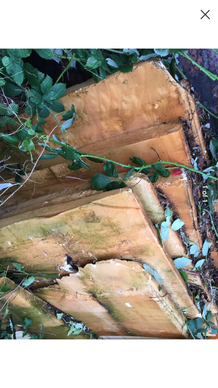

Cracking deal, eBay seconds?
Wtf is that? Looks like the old sofa someone dumped in the river 3 years ago!:eek:i think they'll struggle to sell, what's the asking price?
