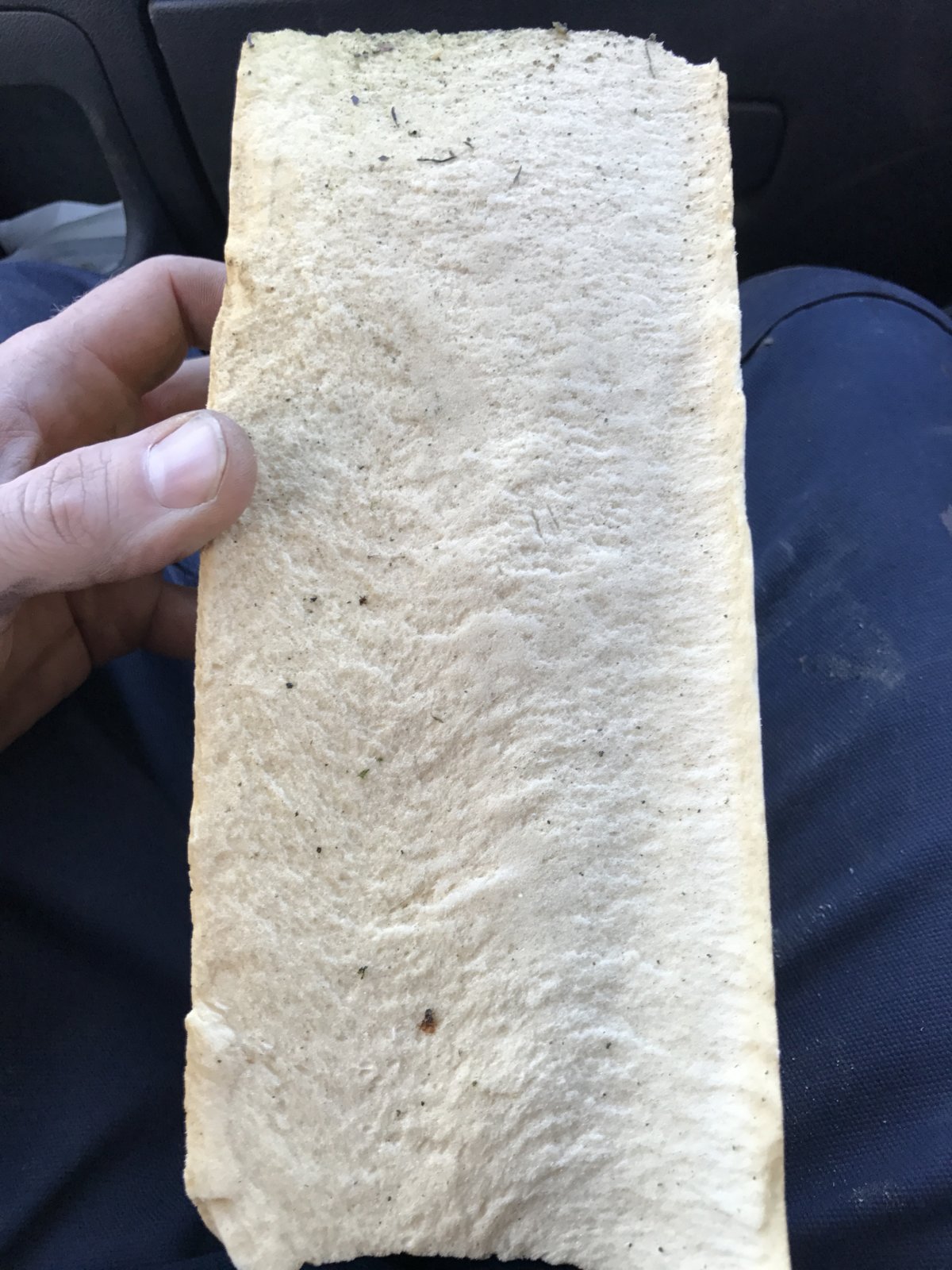

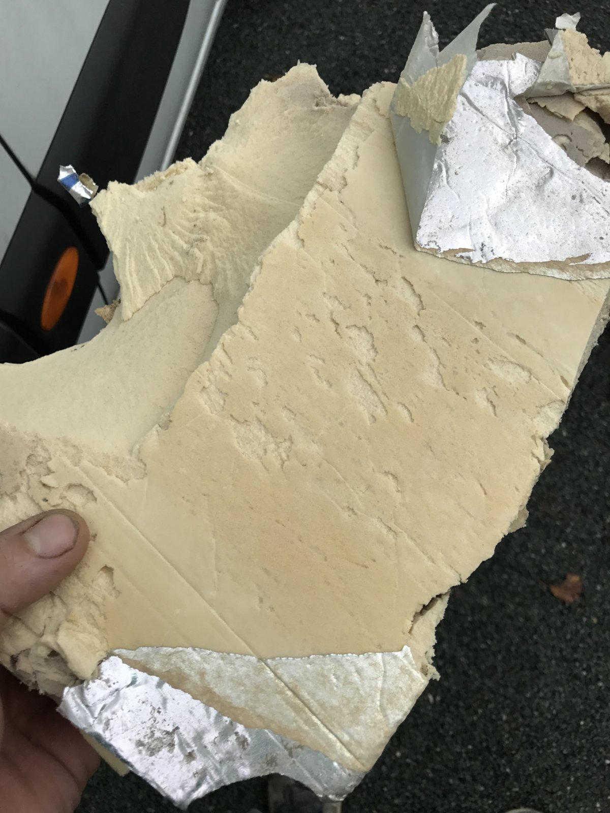

I was just working near the guy that's selling the non foil 100mm for £15 per 2.4x1.2 board so I thought it rude not to go and look ;)

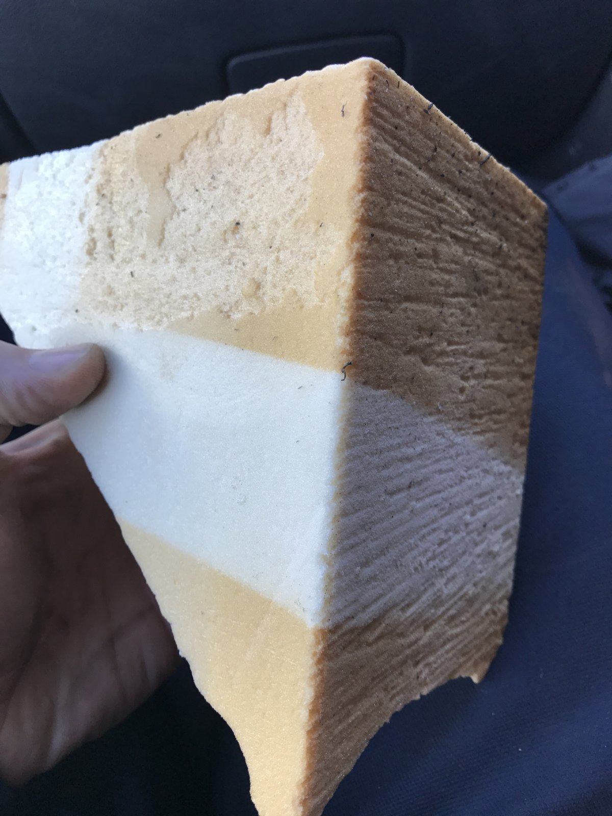

I took an offcut to compare to the celotex. Although it's unbranded it is the same as the celotex inner, it's fireproof and waterproof. He is a builder and says some building control guys are fine with it but others prefer the foil.

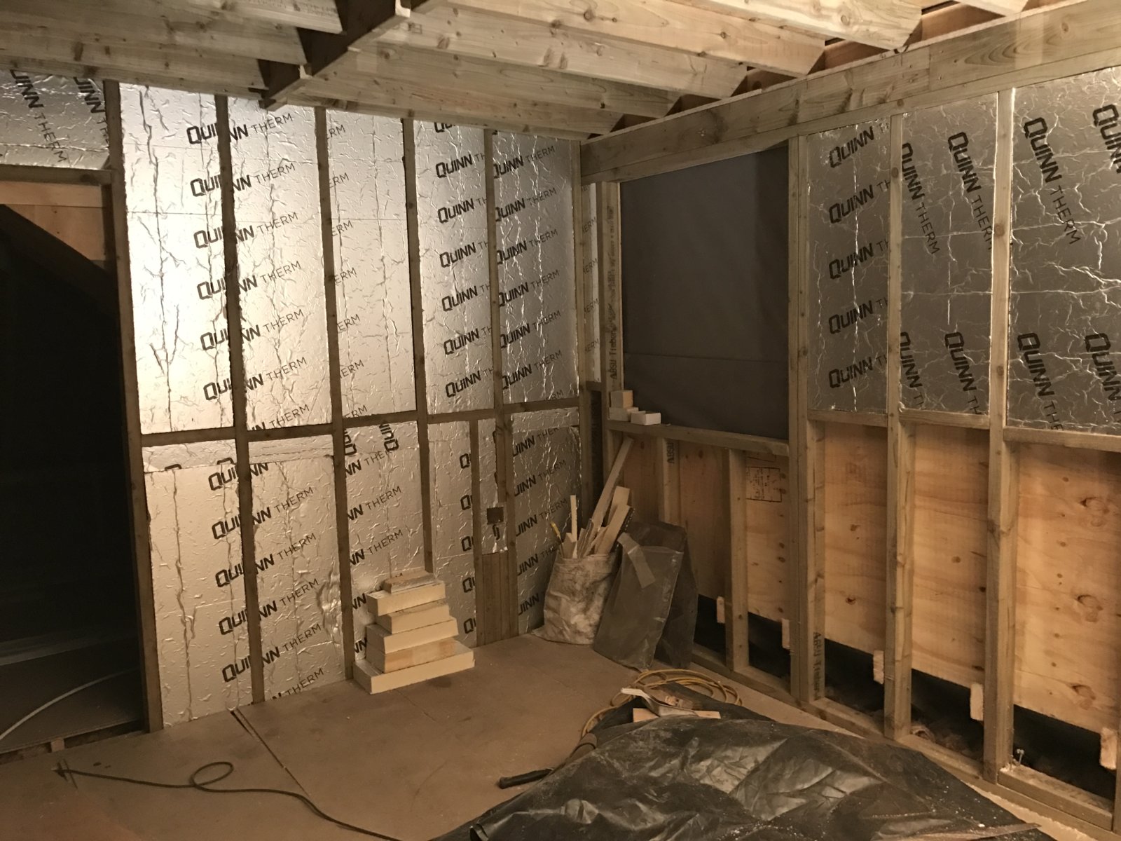

I need loads and I'm tempted to have it between the rafters and in the dormer roof space with 50mm of foiled board under it.
Opinions?
(That's a rough corner that's been out in his yard for a while)
The problem you've got, is that you don't know the true performance of the PIR, but there's a good chance that with 150mm in total, you should be fine. The question is whether you ask the BCO if he'll accept it or not.
100mm underneath, and 50mm of foil faced on top should be okay, just make sure that everything is sealed with aluminum tape to get the VCL, and the BCO shouldn't batter an eyelid.
Now being unbranded, it wouldn't have cost the same as celotex, so it may only have been £20 a board when he bought it - see if he'll come down any further.
The foil only really does anything if it's facing into a void. It also acts as a vcl. If you don't need either maybe it's OK!
However as it's unbranded you don't know how they made it.

I'm digging through some Quinntherm today:
I'm going to ask the BCO, if he is happy, I'll be happy.
Seems the foil faced is easy to get cheaply if you work all over in a van.

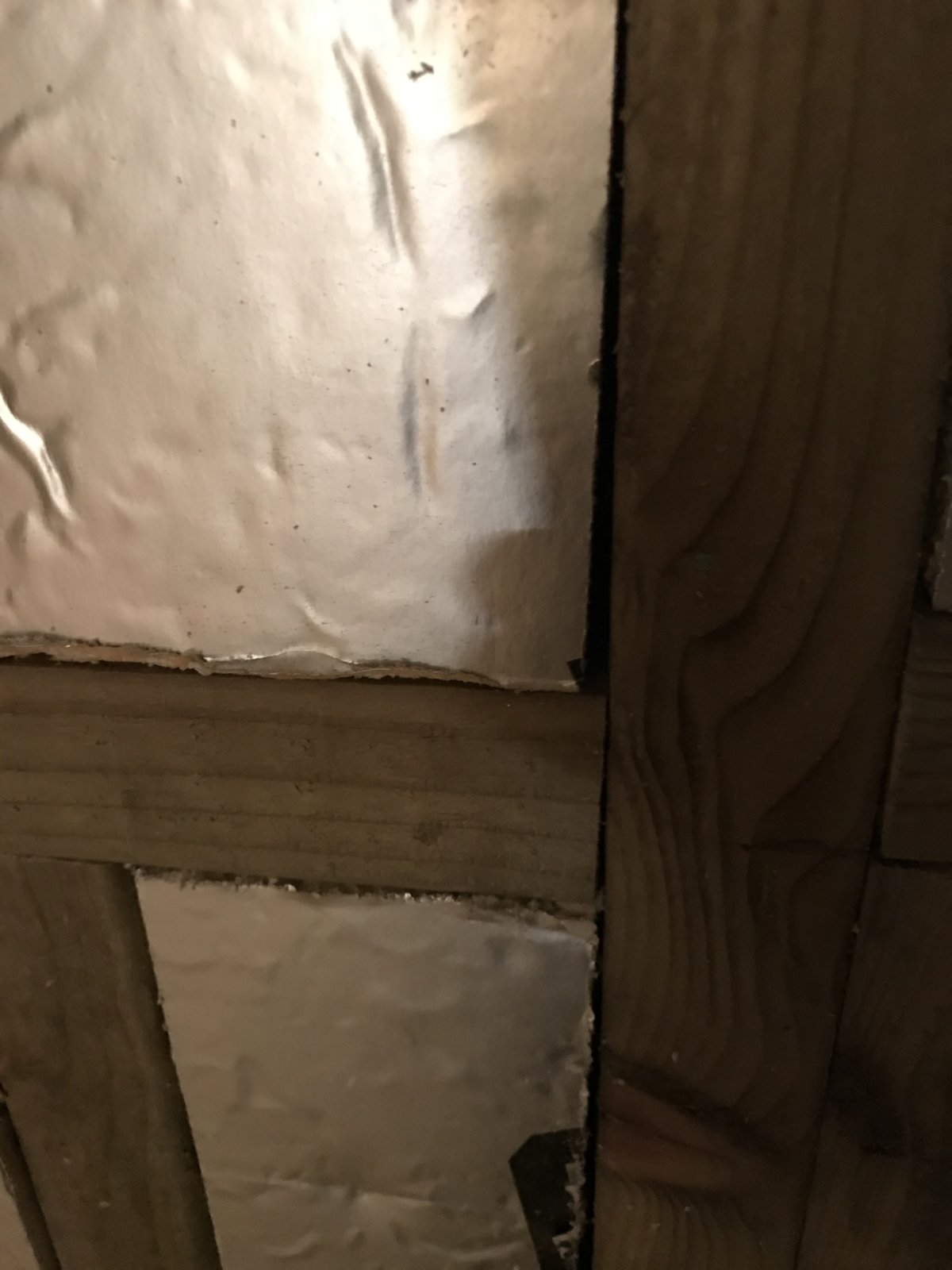

I've started filling between the rafters but wonder if there is an expanding foam that will fill the tiny gaps or should I foil tape accross the rafters and owner the gaps?
A foam that's applied like silicone would be ideal
No, the only foam I've used has been the cans with the nozzle that's too fat for a small gap.
The gun grade is much much better. You can apply it at a trickle just like silicone, plus a can will last a month if you're tidy. You end up getting much better value from the cans as a result.
