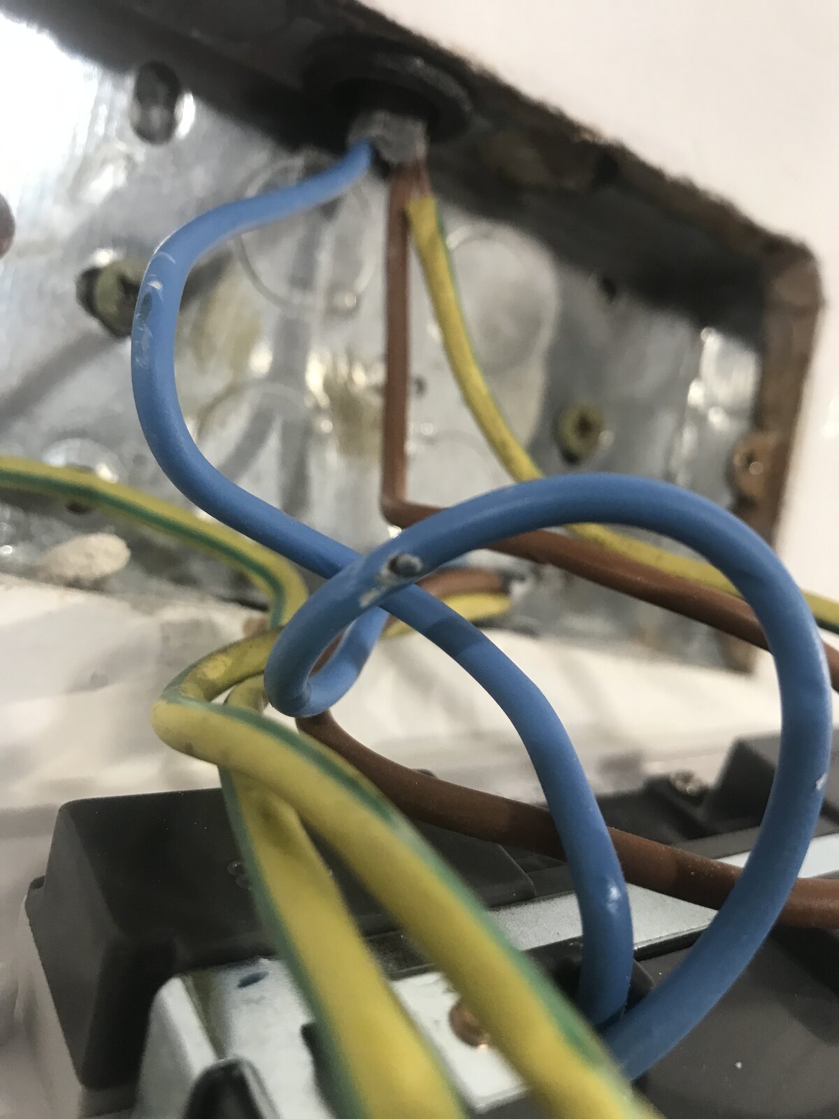

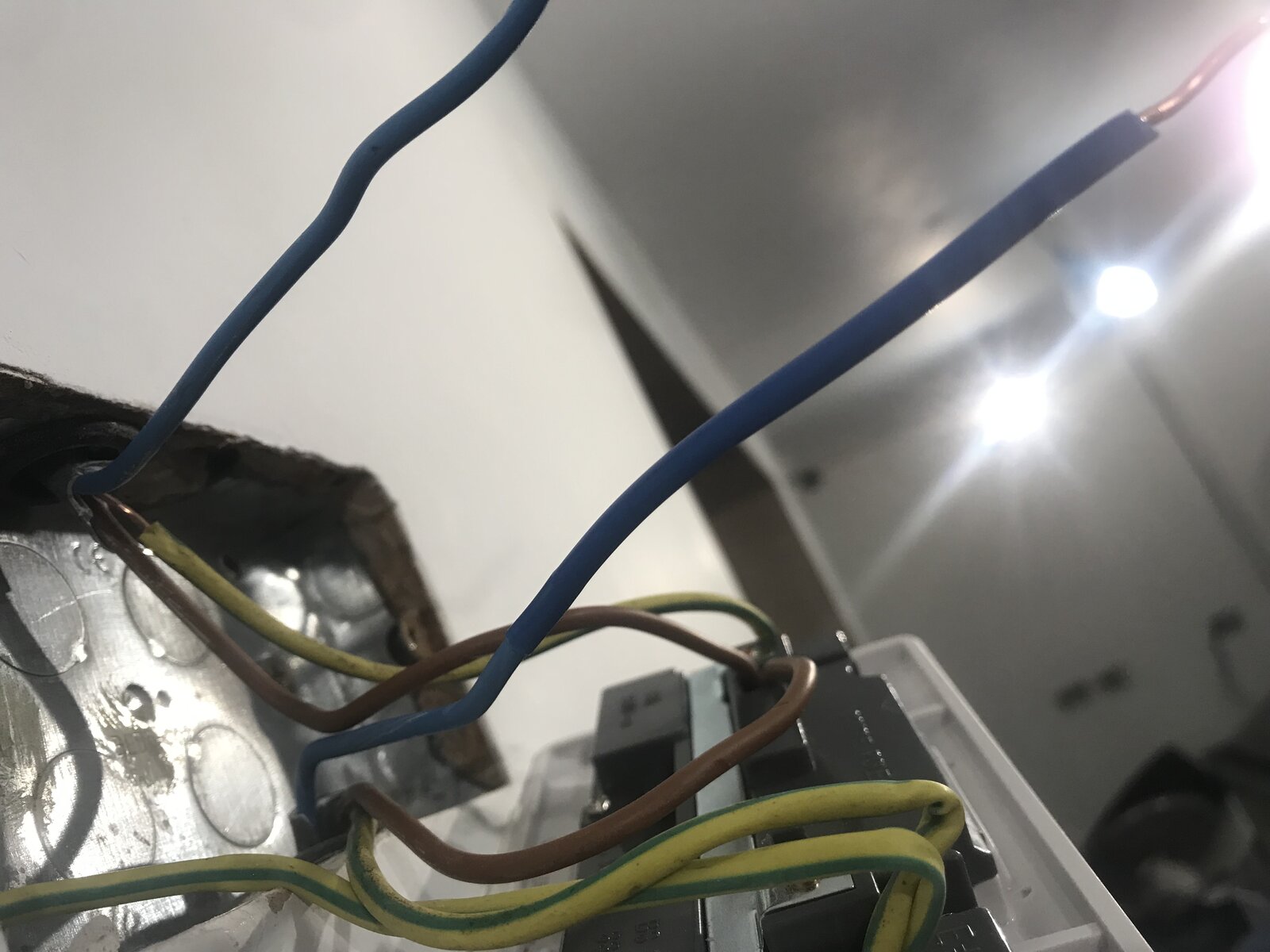

UPDATE: fault located and resolved.
I did a continuity test initially. The small r and big R readings were all within the appropriate tolerances.
I then moved onto IR test and it failed with a reading of 0. Split the ring down the middle and had a good and bad radial. I had to figure out which part of the ring was which as I was measuring at the CU end. I used a wonder lead to figure out the good and bad part of the ring. I then added sockets to the good ring until it failed.
The problem was here:
I sleeved the neutral with some spare sleeving I had in he toolbox. Was that the right thing to do?
Repeated the continuity and IR test and everything passed.
Thanks for all your help.
