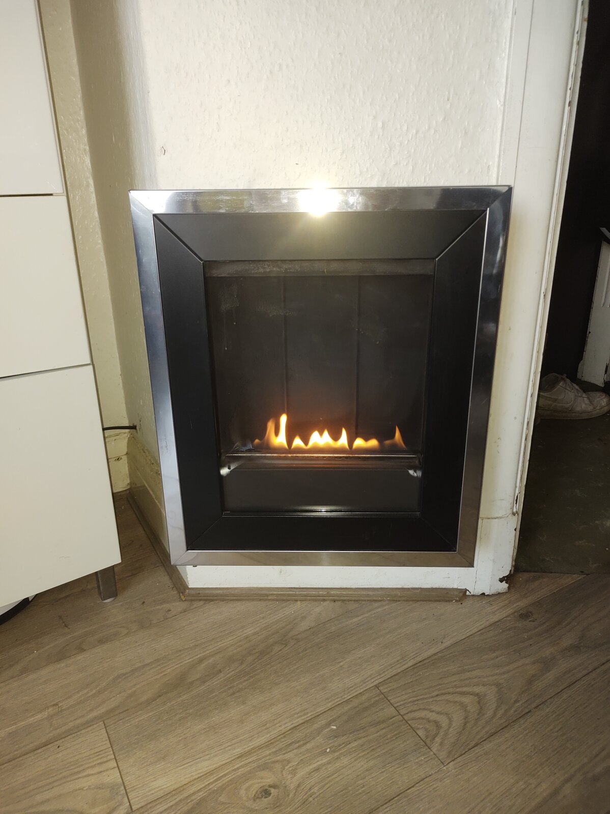

I recently got one of those dreadful/dreaded flueless gas fires (and accompanying big hole in lounge wall). It's 2kw and 90/100% efficient (depending on whether you consider the hole in the wall). It has just about kept our big drafty lounge warm over the cold snap @21p per hour. Rest of the house freezing as we barely had the heating on to save money - boiler is fixed 15kw and runs quite a lot when on in cold weather. I should think we've saved a few quid but at considerable discomfort - the real purpose of the fire was is to take the chill off the lounge in mild weather as my wife feels the cold, particularly in that room and constantly puts the heating on when the rest of us hardy bunch aren't that bothered.
They have a clean burn and a catalyst to "remove" the combustion products - the external vent hole is to replace the air.
We don't have a chimney or suitable external wall to fit a flued fire.
I thought with flueless they could be situated on an inside wall and that you don't need any sort of hole?

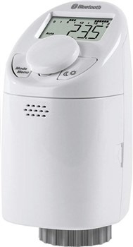

I have considered heating just the rooms required, the TRV EQ-3 Bluetooth Smart Radiator Thermostat.jpgcan be set to a schedule, and you can set a sequence so rooms are heated just before your going to use them.
However the main problem for me seems to be speed. Theory is sound, for £15 per room (2019 price when I bought them) you can set each room only to be heated when required.
But set wife's bedroom to 18ºC 24/7 she does not like room too hot, but allowing it to cool to 15ºC during part of the day, it was simply not re-heating on time for her to use it.
The same applies to the wall thermostat, theory great, set to 15ºC at night, and 18ºC in the morning, but in practice just takes too long to re-heat.

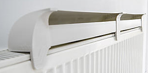

This looks so easy circulation3.jpgshowing how the heat naturally flows, but stick a fan on the radiator and it works so much better. I looked at these radfan.jpg and thought what a good idea, so got a small fan and a thermostat which I put on radiator return pipe, so once radiator warm the fan would turn on. It turned on for about 5 minutes the radiator stone cold.
Looked at Myson, and realised the propriety type have nothing to restrict water flow, but this also means when off, hot water returned to boiler, this was OK before the condensation boiler, but with a modern boiler that return hot water will turn boiler down, OK if all rooms heating together, but selecting one room at a time, means other rooms return hot water and turn down boiler.
The fan assisted does not turn water flow on/off, but turns fan on/off or with better versions 5 speeds. This would work if radiators plumbed in series, but they are not, they are plumbed in parallel.
They can, the hole is a vent to refresh the air in the room, with a minimum area of 100cm. Possibly a bit OTT when the output is compared to a gas hob or cooker but those are the regs.
Thanks, I didn't realise that.
