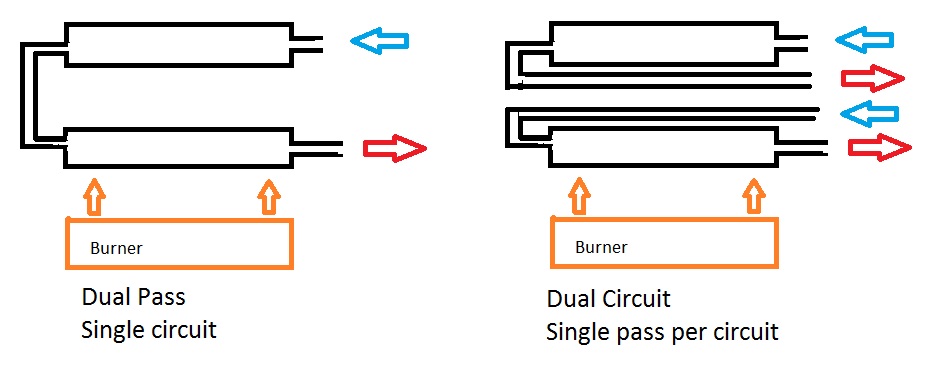

If it is to be answered can we define terminology first.
dual pass heat exchangers
The way I see it both Intergas ( separate tubes ) and Ferroli ( tube in a tube ) are dual circuit , single pass heat exchangers.
Bernard, the Intergas appears to be `dual pass single circuit`on the CH side. The 1" looking pipe coils in and out of the heat exchanger a number of times. I would say the Intergas is "dual circuit multi-pass." on the CH and single circuit single pass on the hot water. A hybrid.
Disagree slightly
Dual circuit, yes, circuit 1 for the CH and circuit 2 for the DHW
Multi pass, yes it is multi-pass both on both circuits IF you consider each tube through the aluminium core as a separate heat exchanger module (*) AND the tubes are connected in series AND the cold water entry is into the tube furthest from the burner.
(*) The separate modules being fused together as a solid block of cast aluminium
