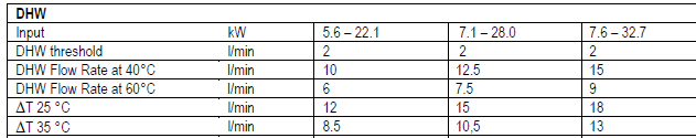

Intergas:
(Obviously we're looking at the right hand column for each).
Laws of physics seem to be different for our Italian brethren. Especially as said laws, even assuming 100% heat transfer state that at input of 32kw, ΔT35 you can get 13.06 l/min.
So how the feck does Ferroli manage to get 15.3 at both ΔT's? If we take ΔT30, that gives us 15.24l/min.... but again at 100% transfer efficiency. Which we ain't gonna get. Ferroli manage to squeeze another 0.3 l/min on top of their 100%.
Now, we give the same calculations to the Intergas figures?..... This gives us 13.35 l/min at 32.7kw input and an assumed transfer efficiency of 100%. Put that to ΔT30 and that rises to 15.57 l/min. IF we use Intergas' figures of ΔT25, it is 18.69. Ferroli - a slightly more modest differential of 0.1 litre a minute. Again assuming 100% heat transfer.
Of course we can't have 100% so a bit of a reduction ius in order. Something Intergas has done. But Ferroli?
