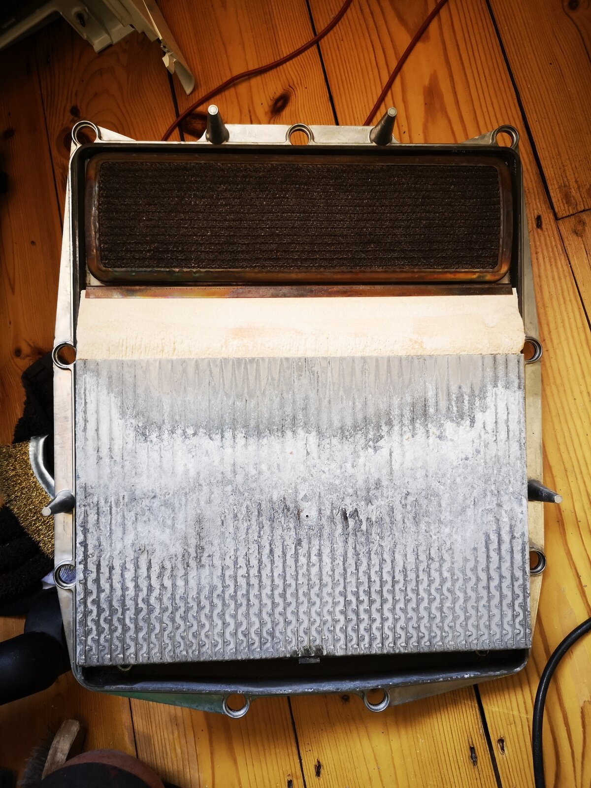

Like most boilers, that kind of debris that's found inside the heat engine is more likely to be stuff that's being drawn in from outside and then burned and collecting/attaching on the fins as ash. It is more prevalent in built up areas and shows how much rubbish is actually in the air. That can glow white hot though during the heat cycle and cause damage to the aluminium surfaces. Could it be called corrosion, guess so.

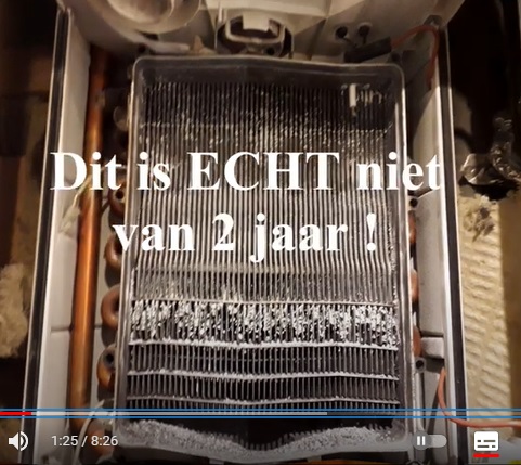

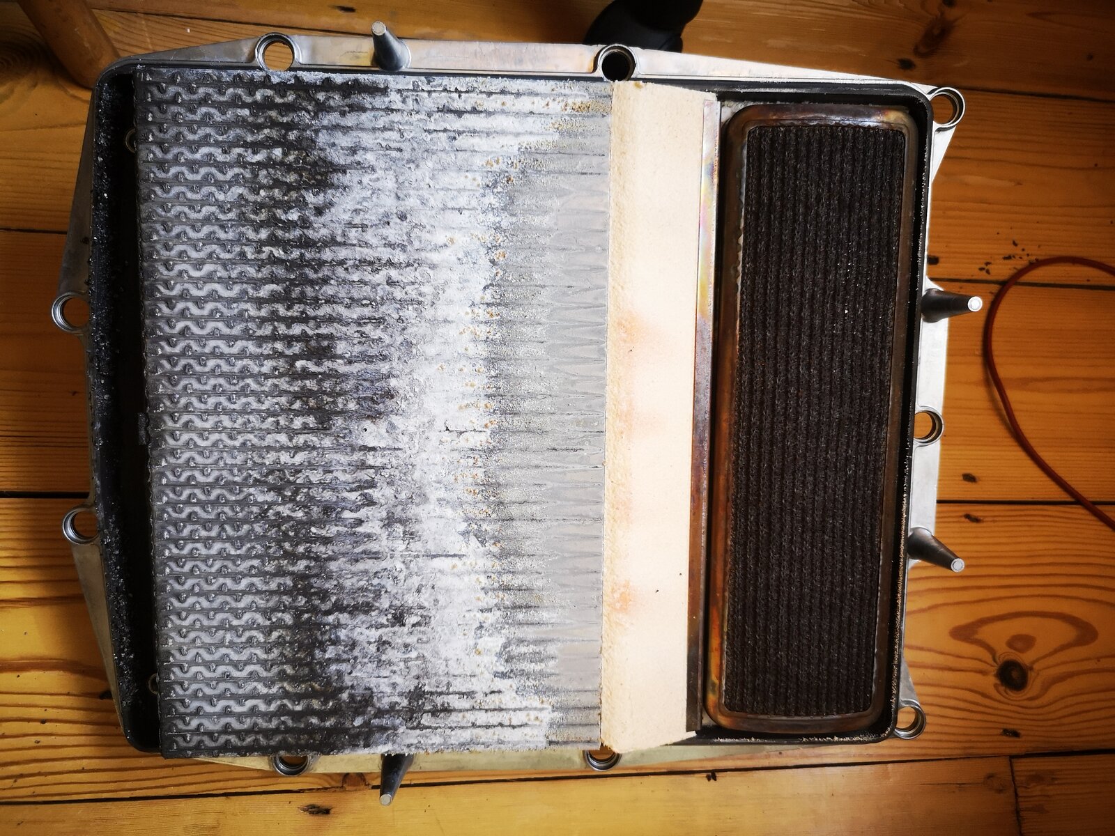

This is a still from the video posted above by bernard green. Google translates it as "this is really not from 2 years", by which he presumably means it must be more than two years build up?
Indeed, I've been into boilers that that have not been serviced for many more years than that are their main HEX is spotless (apart from the odd fly/wasp/insect). I do do a fair amount of work out in the sticks as well as in built up areas and it's certainly seems attributed to air quality with the ones out in the sticks being much cleaner. That and if there are open spaces and great airflow around the flue area rather than lots of growth and less airflow.

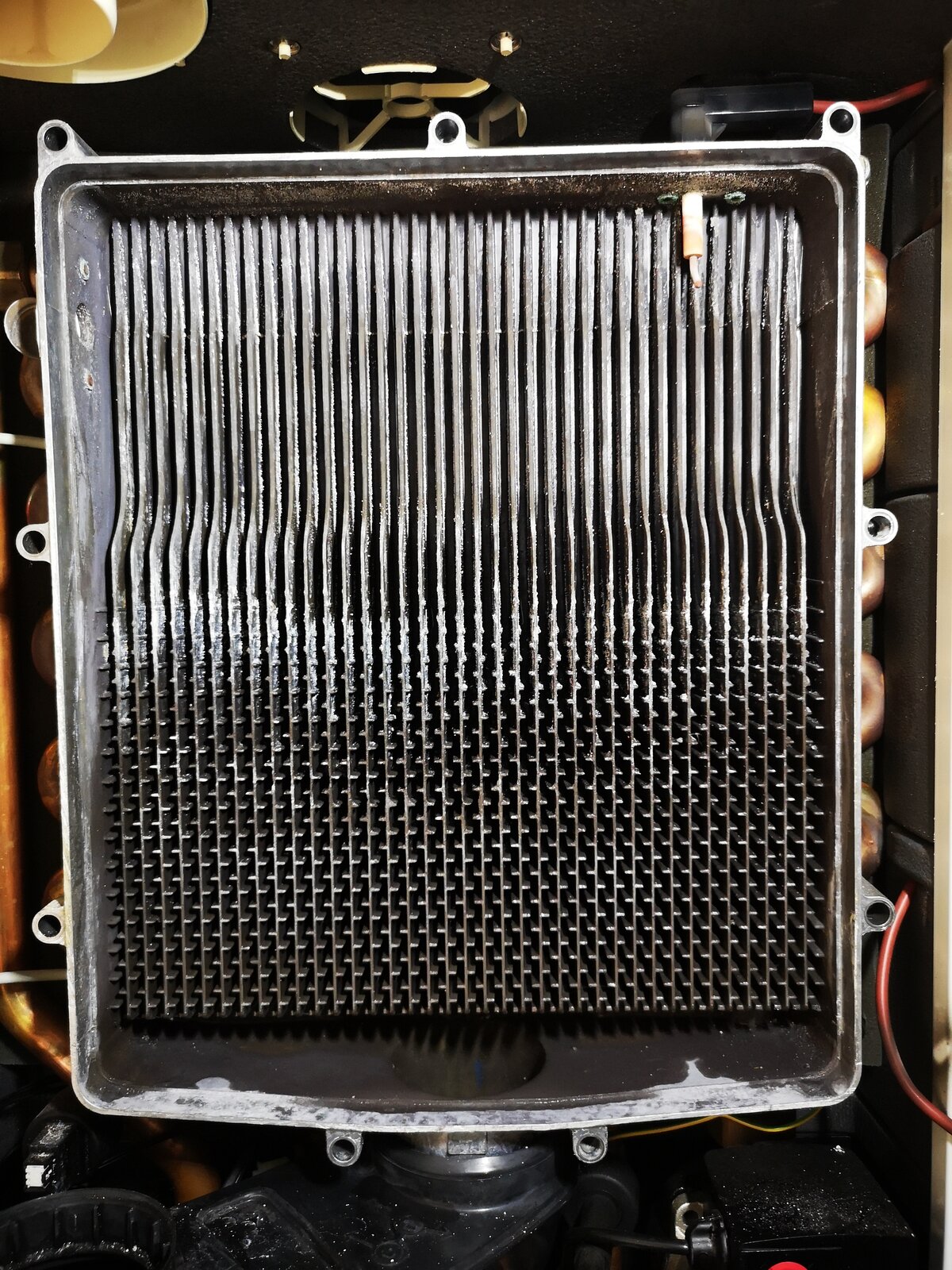

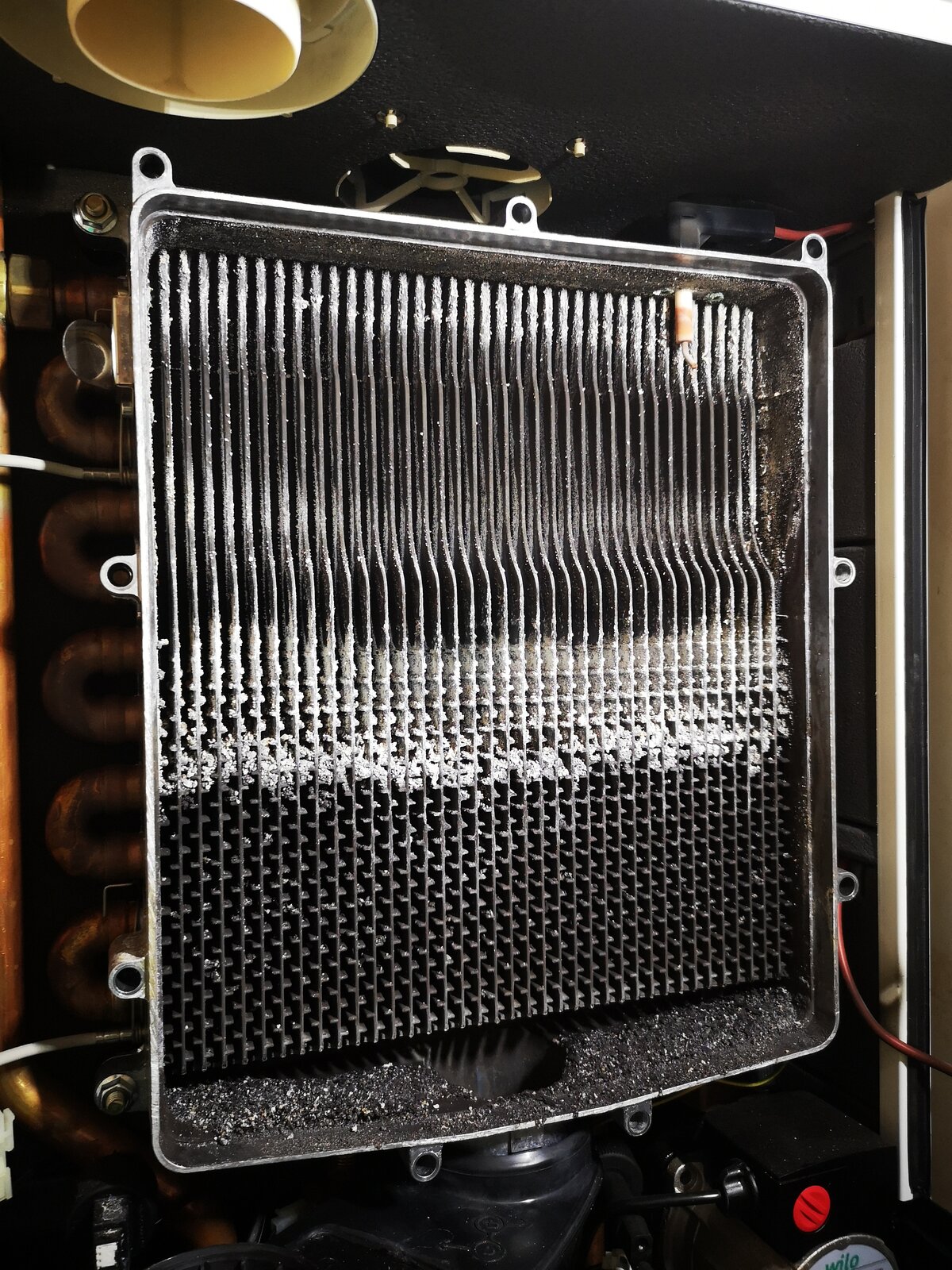

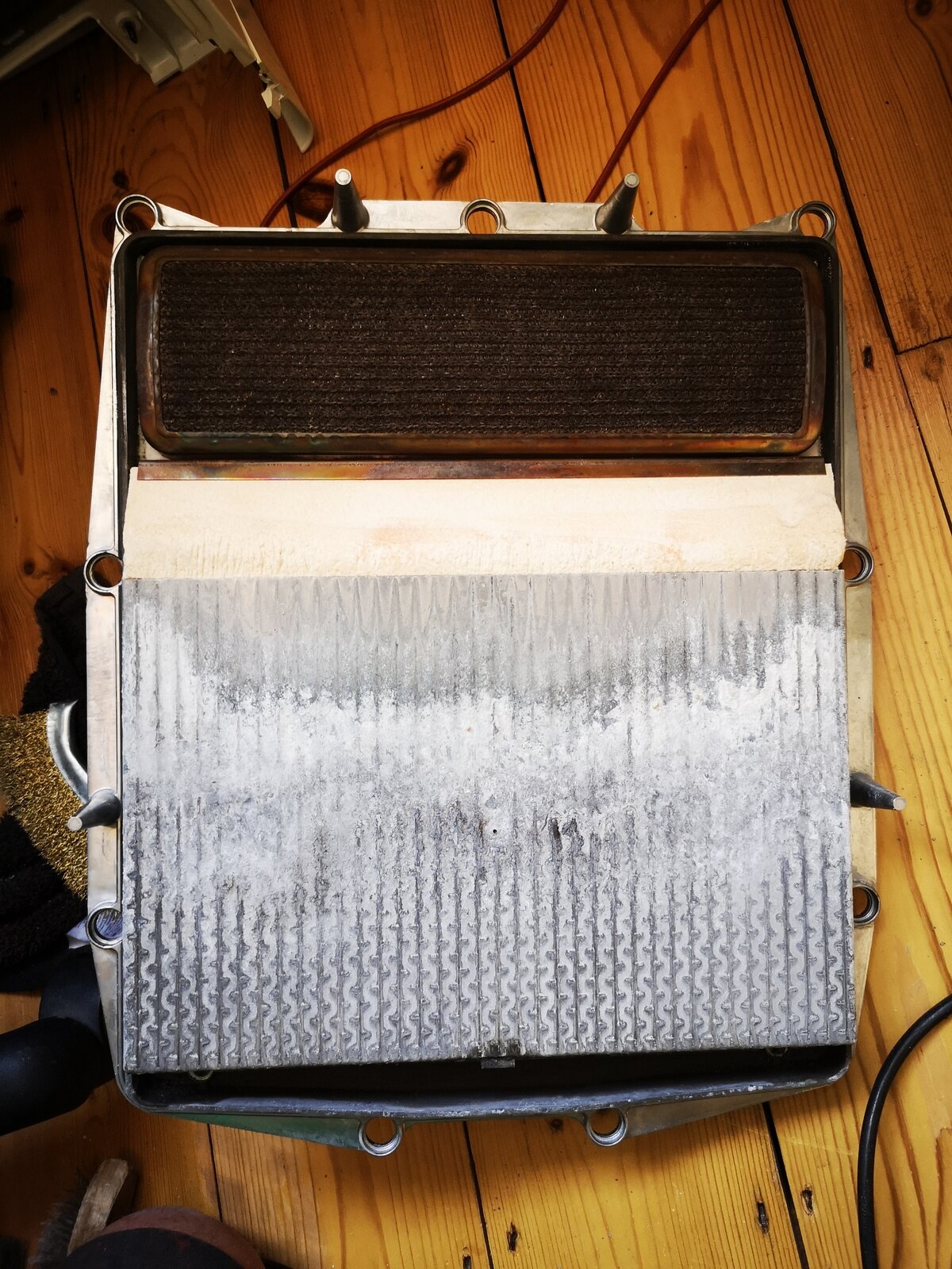

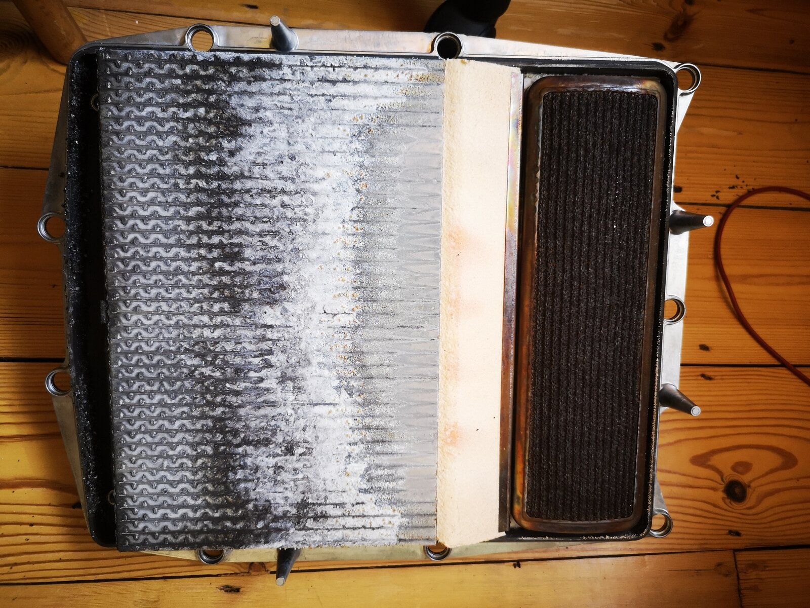

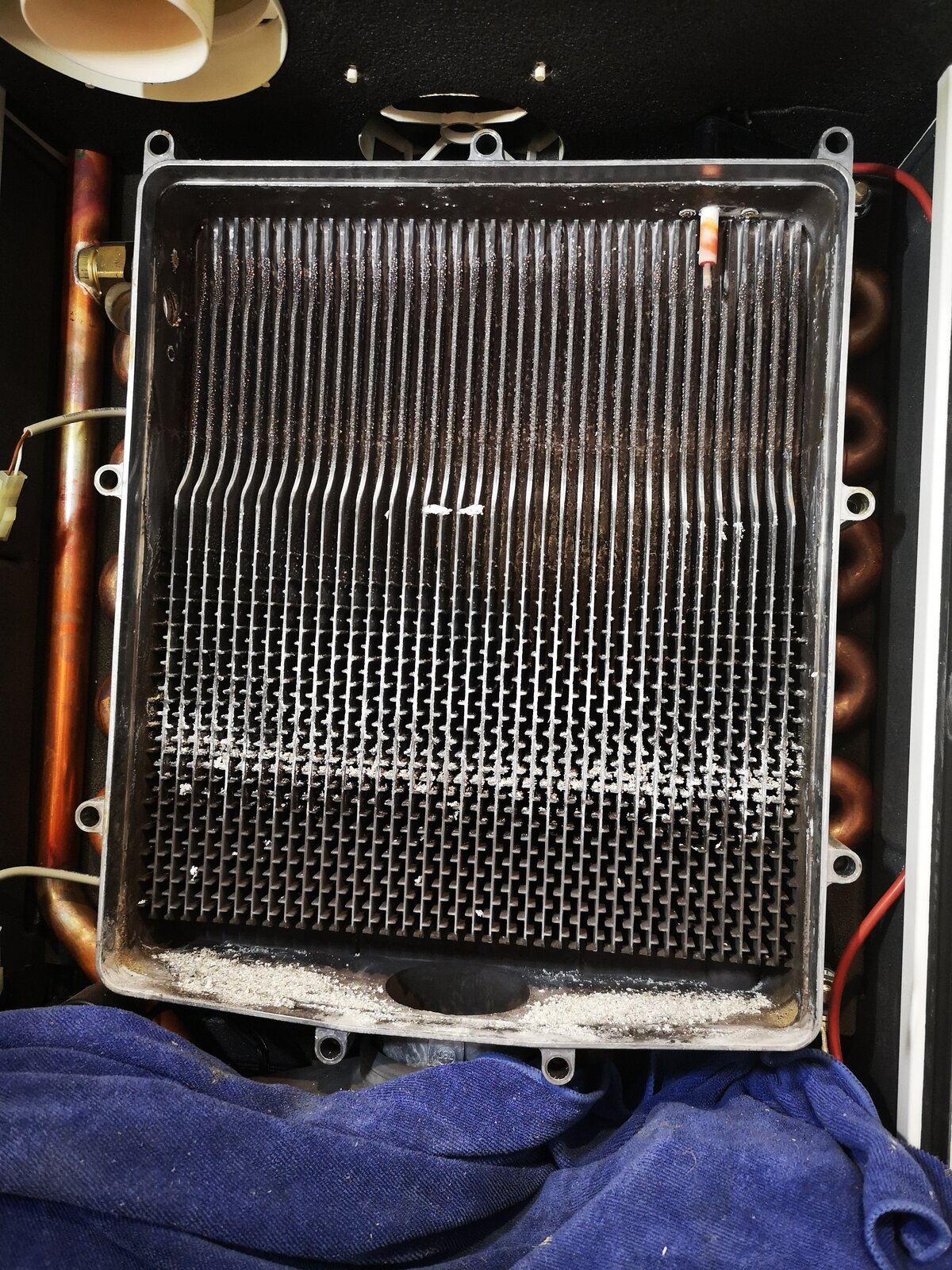

Condensate doesn't come into contact with system water no matter what heat exchanger. It forms on the flueside of the exchanger if the surface of the exchanger is below 50⁰c ish.
If it comes in

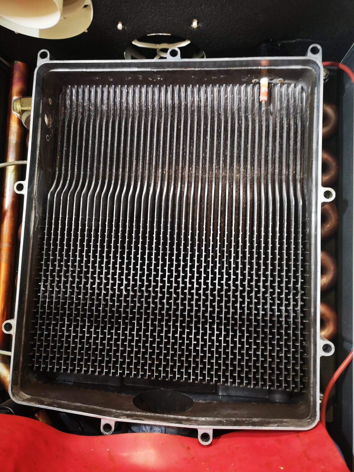

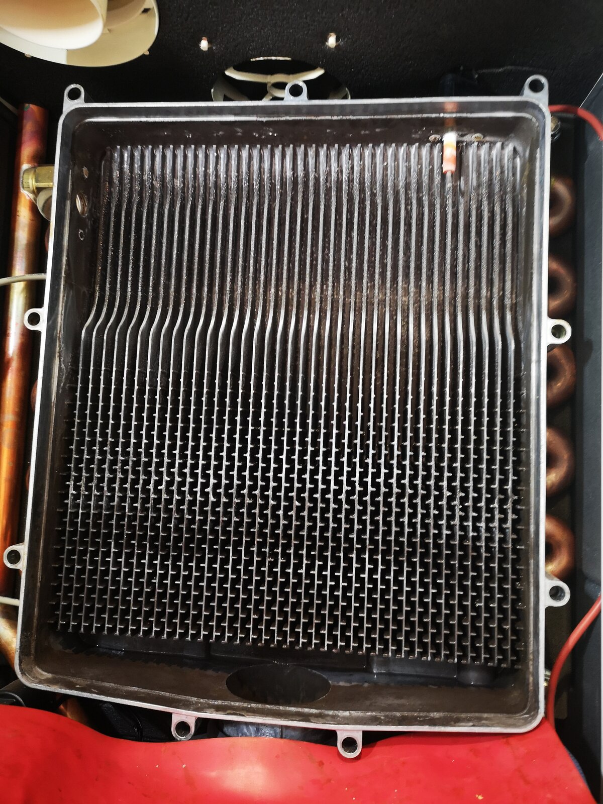

After cleaning hex

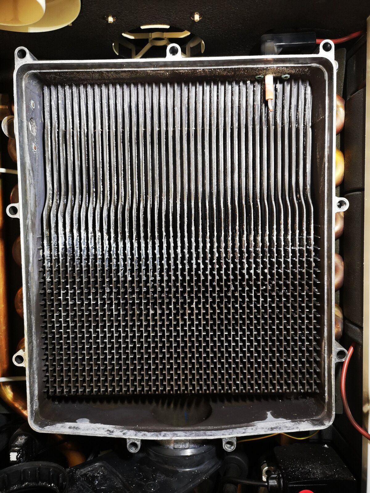

Before cleaning hex
Very good illustration.
Ali forms oxide with contact to condensate, the oxide is around the first run of domestic cold water entering the exchanger, very little on the heating pipes further up the exchanger.
What was the setup, WC. or was it running at high non-condensing temps.
Theoretically you'd want oxides to be further up the exchanger particularly if the flow was set at 50⁰C or below.

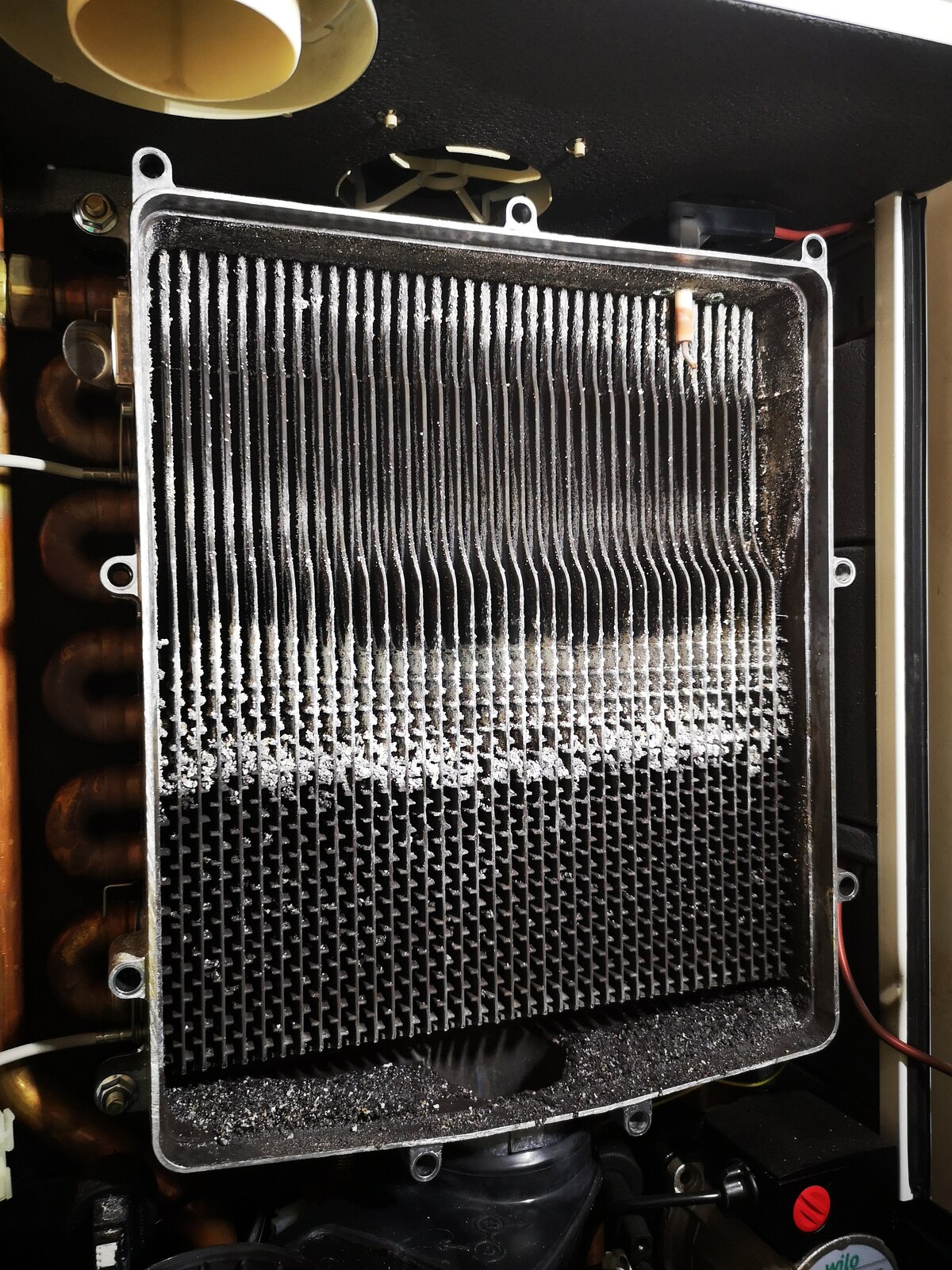

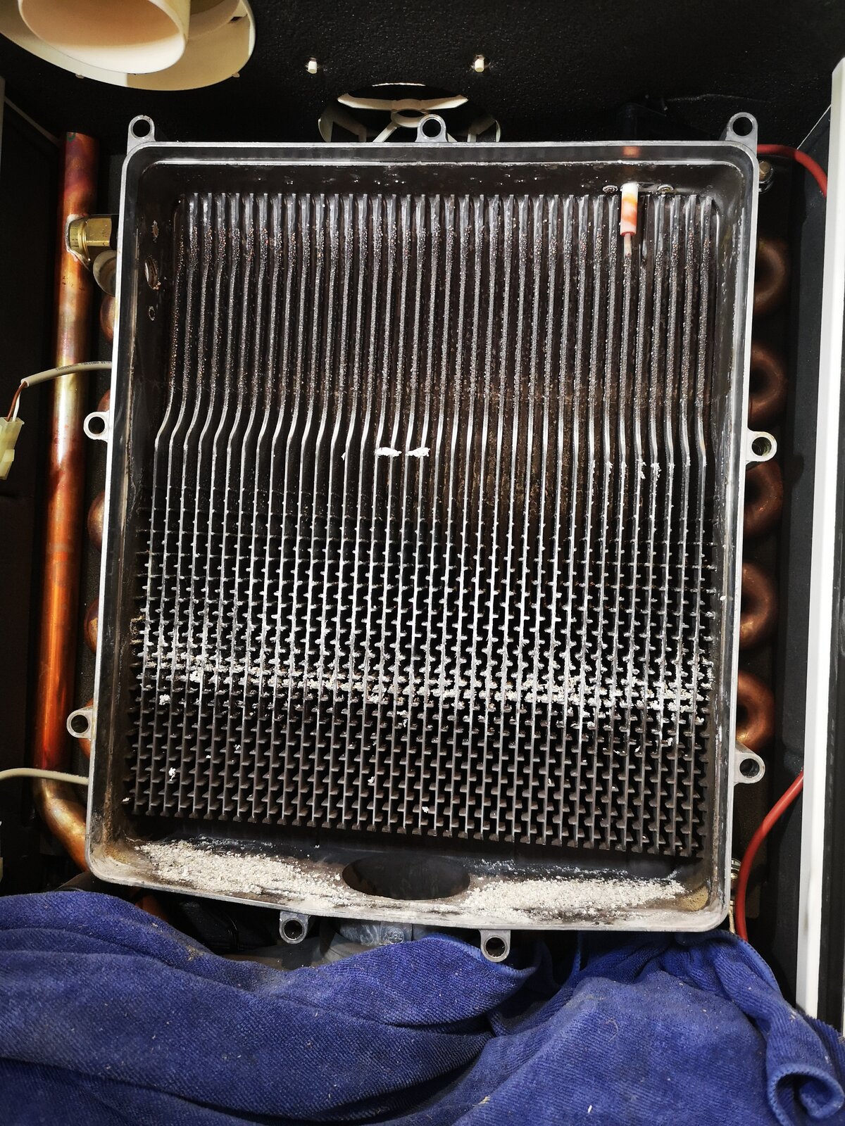

It's on a D plan with unvented in the loft. Boiler is on grnd floor. Controls for CH are nest on OT. This was it's 4th year service. 2 years missed due to Covid and other factors.
Not that bad really. I have another that was worse. Will try to find pics of that one... To be continued....
