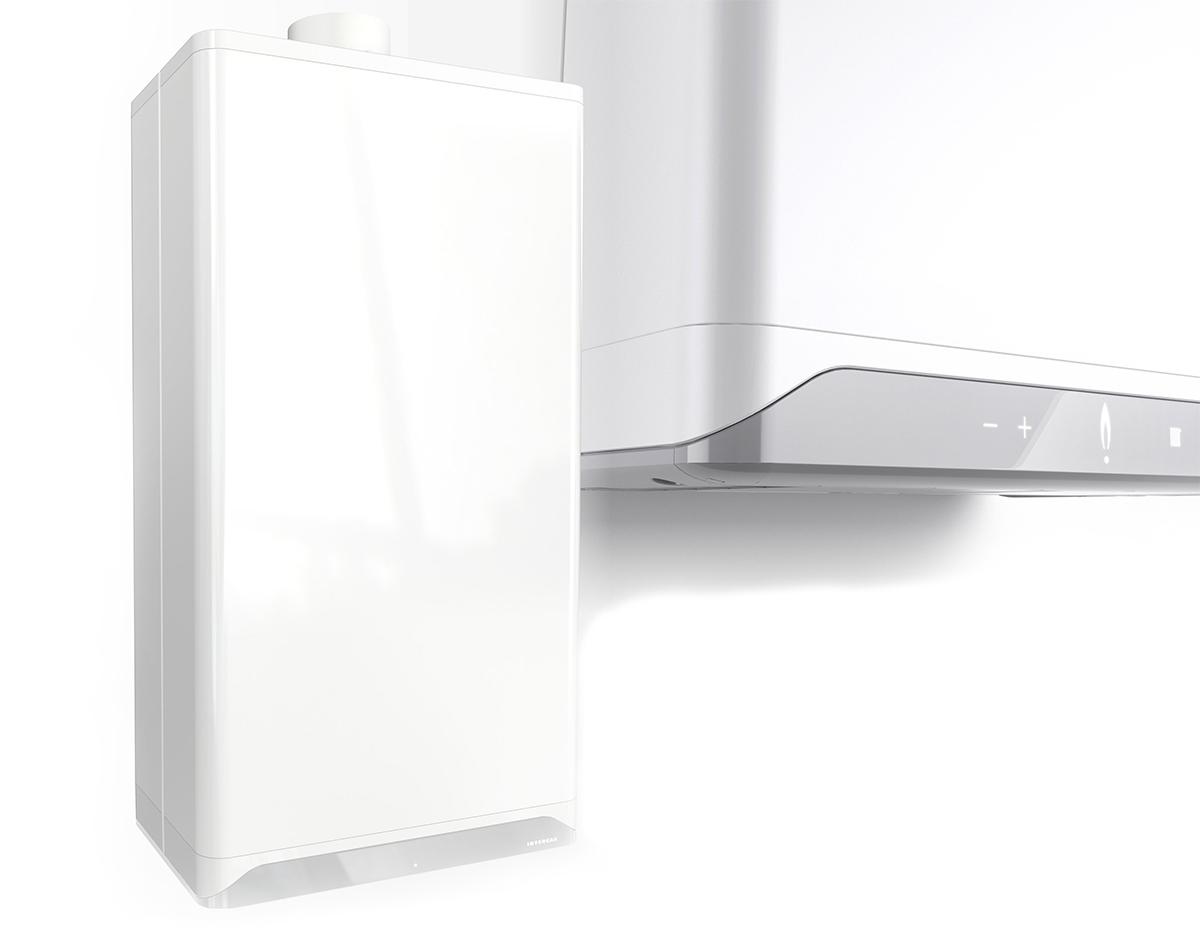

Hi all!
So I've been wondering for a while if Intergas would release a boiler with a secondary HX for flue gasses - and now it has!
http://www.intergas-verwarming.nl/wp-content/uploads/2017/09/Intergas-flyer-XTREME.pdf
The Intergas Xtreme 36 is claiming an efficiency for DHW of 127.6% - how do you get more out than you put in :?:
Looks like this will be the boiler I will be getting if customer feedback is good. Does anyone know when it is likely to be available in the UK?
