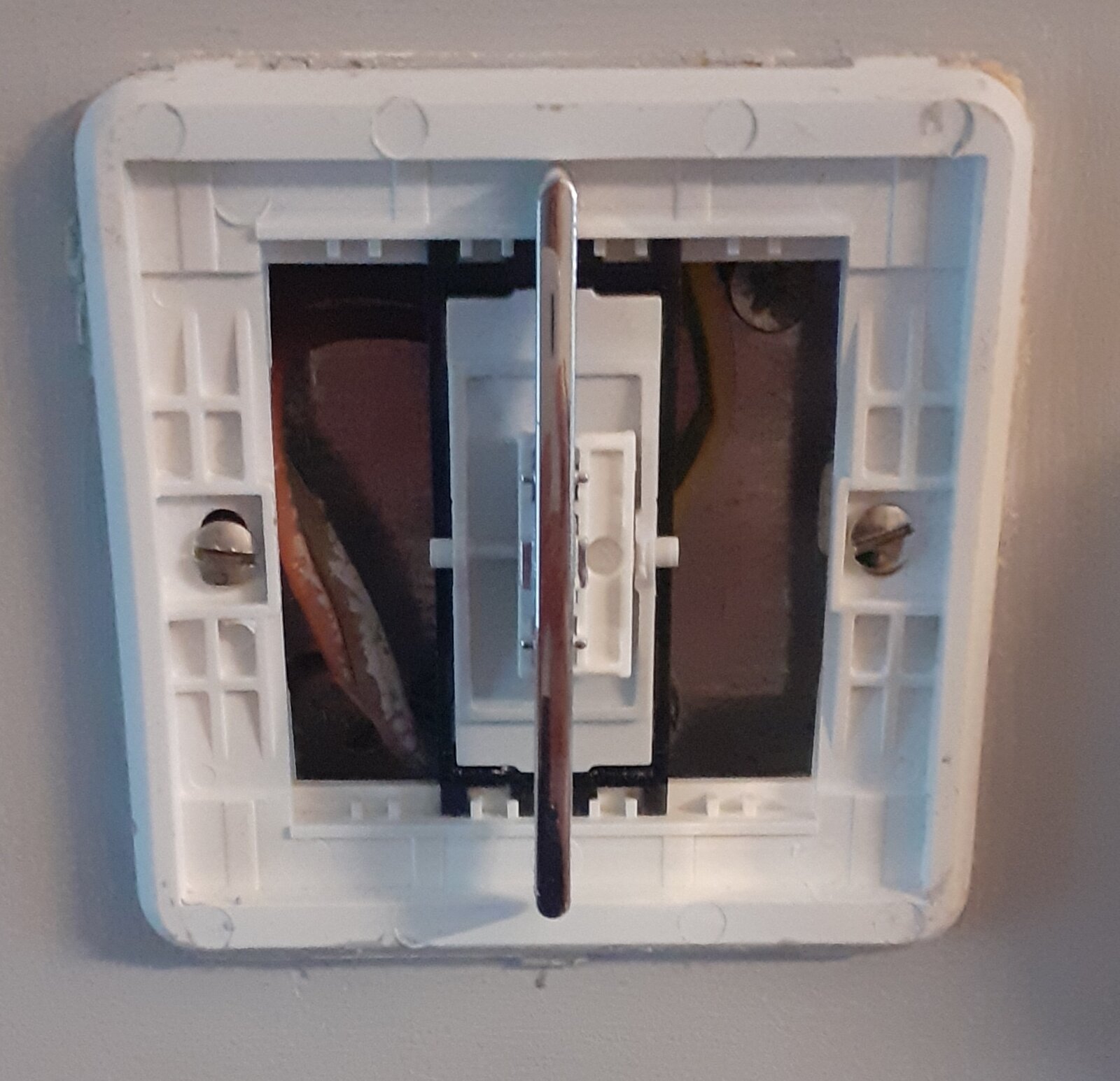

Well, I can see a potential commercial 'point', given that the market for intermediate switches is presumably tiny compared with the market for 'two-way' ones. It is presumably simpler/cheaper just to throw two standard 'two-way' modules onto a faceplate and link their rockers that to explicitly manufacture 'intermediate modules', isn't it?
Well, as neither of us has ever come across such an item, it cannot be a common practice so - presumably not.
As you say, and for whatever reason, it clearly is an extremely uncommon practice.
It does, of course, only work for single-gang intermediates, whereas they could probably get two, maybe three, intermediates on a 'single' faceplate if they had explicitly 'intermediate' modules.

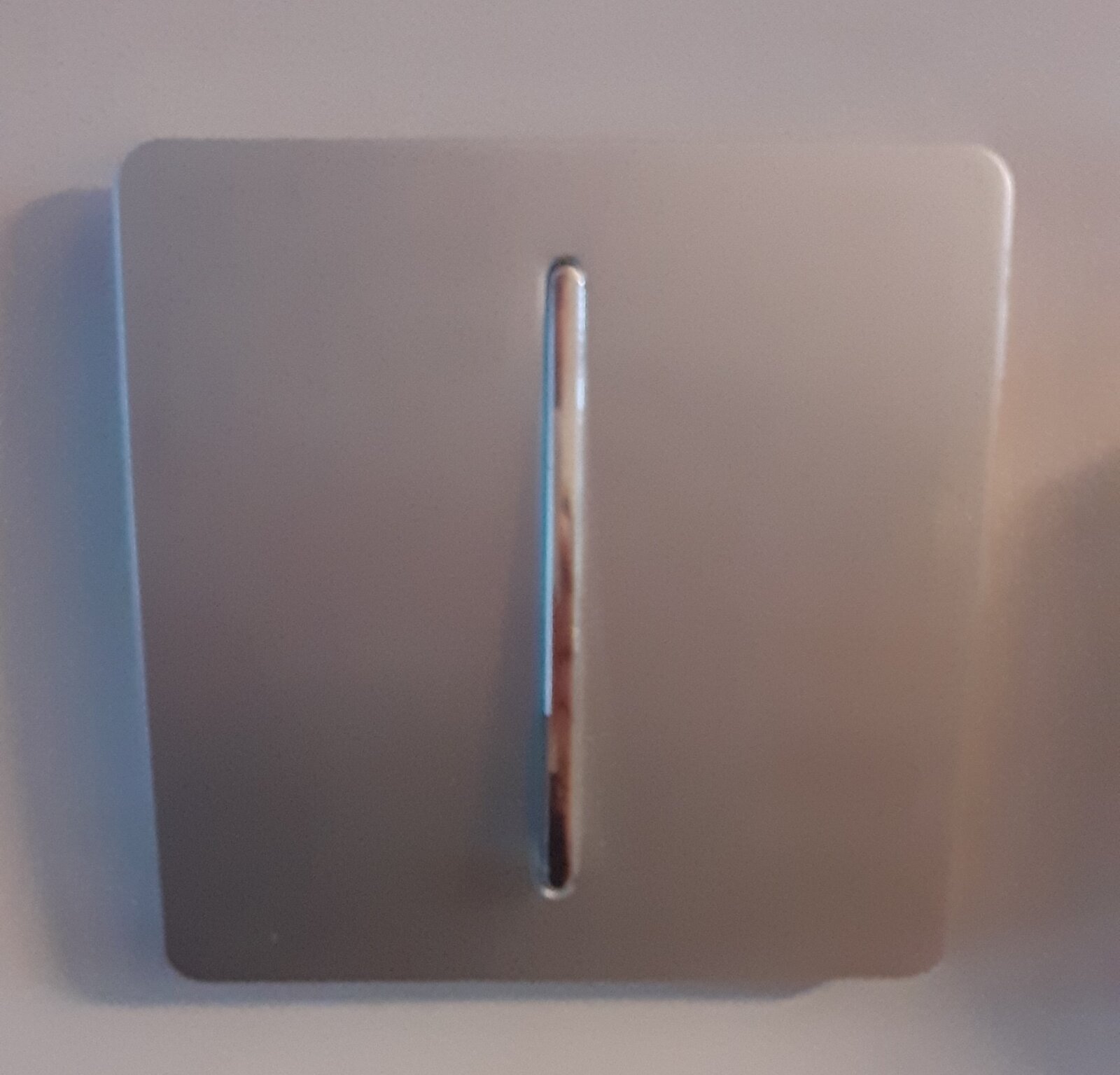

The Trendi switches, for example are a modern switch, designed to be modular from the start.

Here's my 1 gang 2-way switch.
It would only take a very simple modification to the rocker to switch two modules...
Yes, but that is not, in itself, an explanation. Other 'modular' ranges of accessories do include explicit 'intermediate switch' modules.

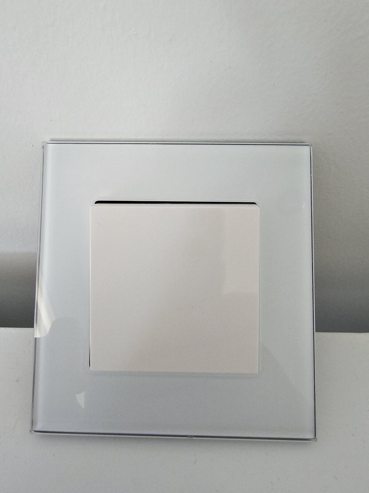

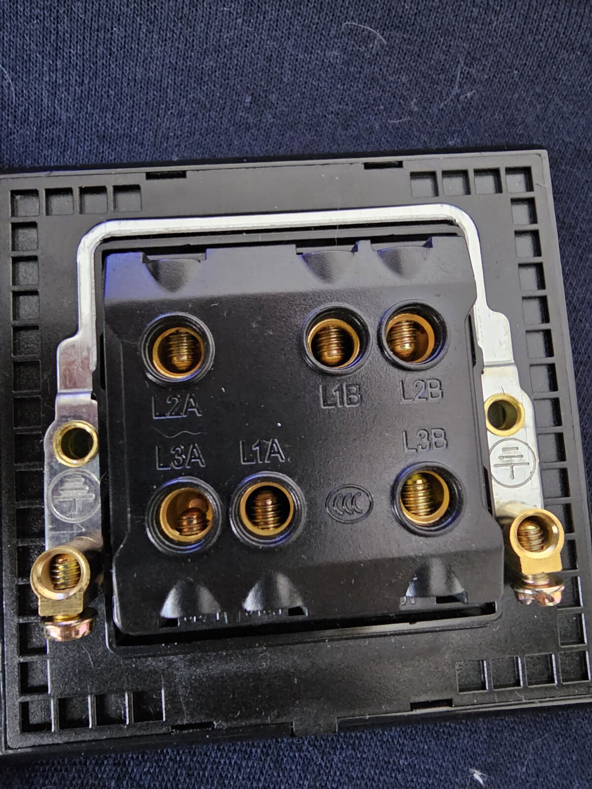

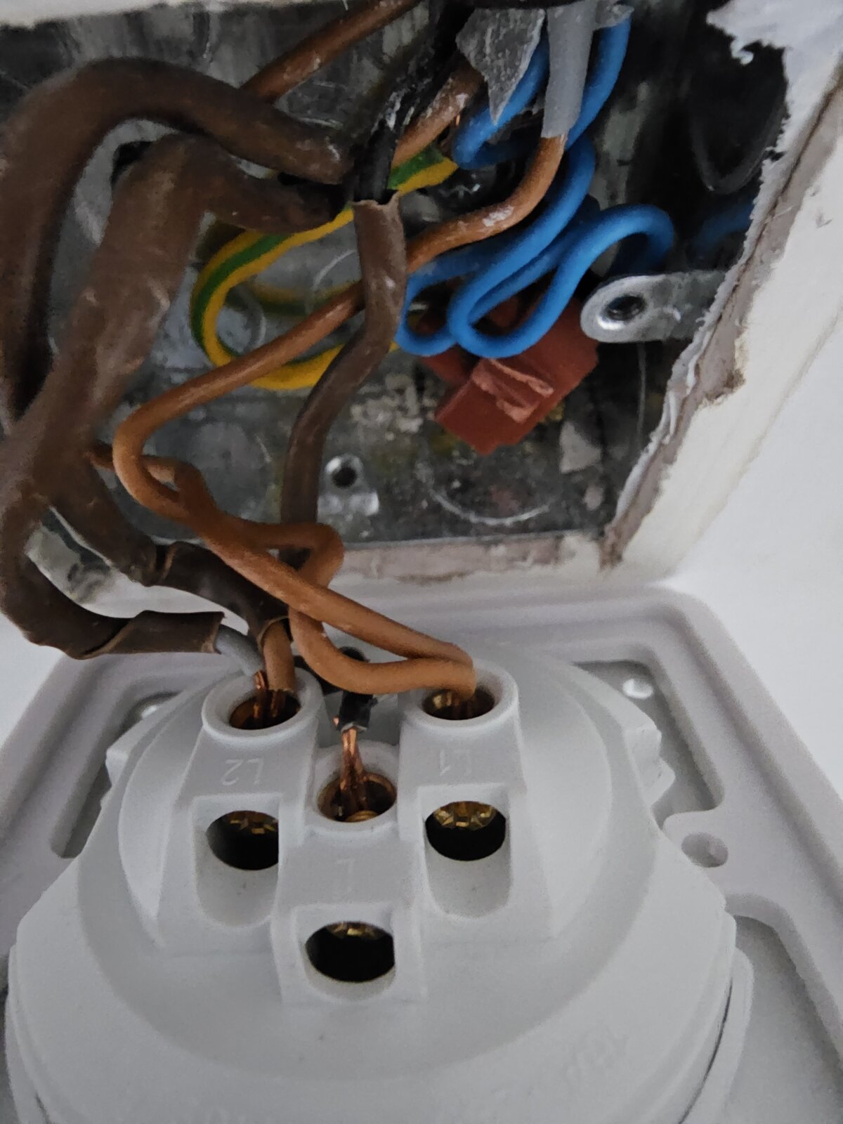

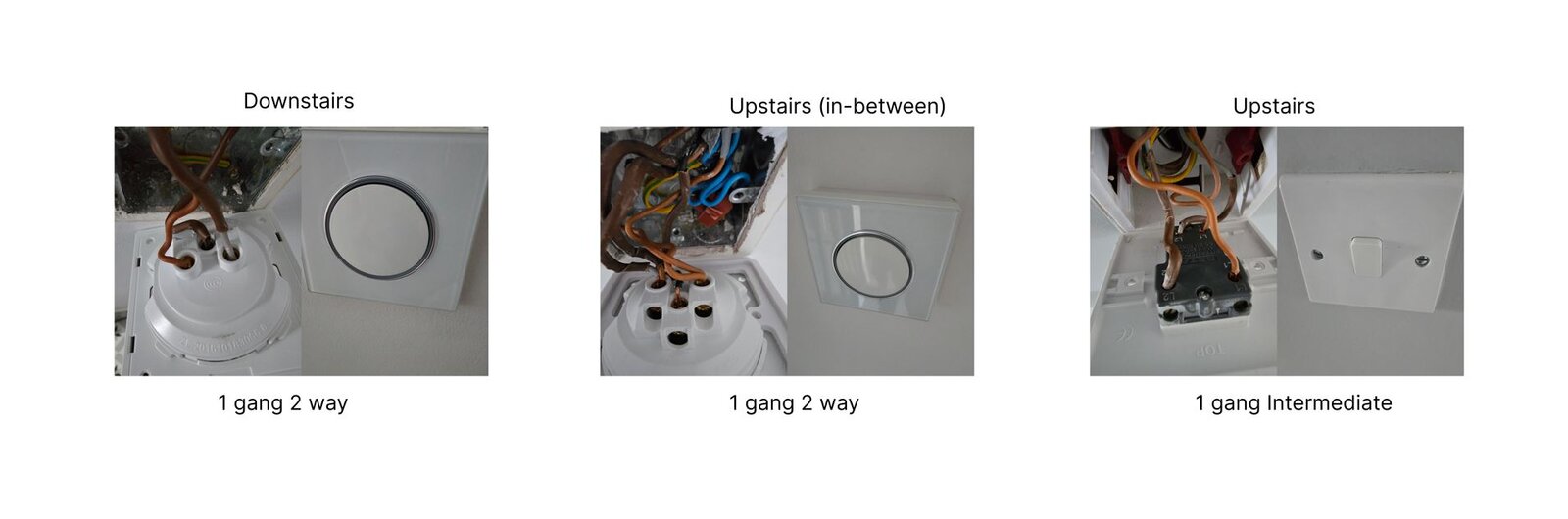

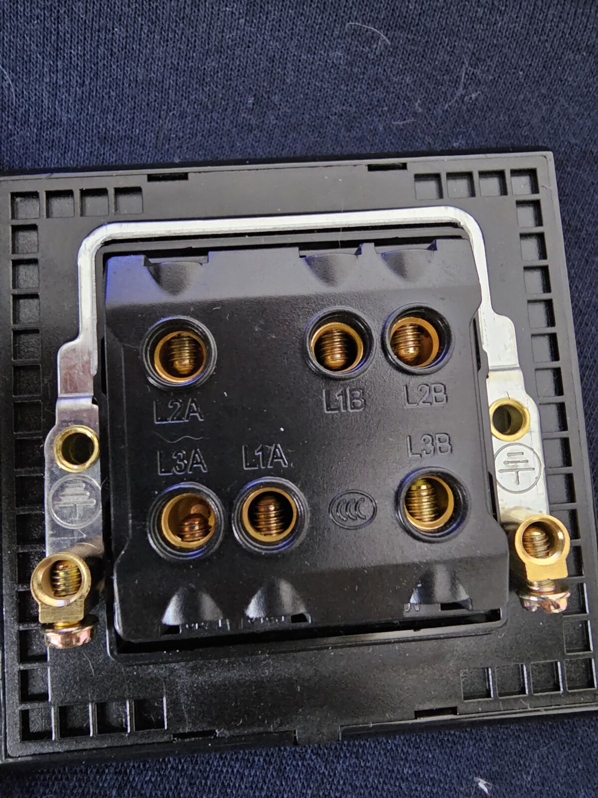

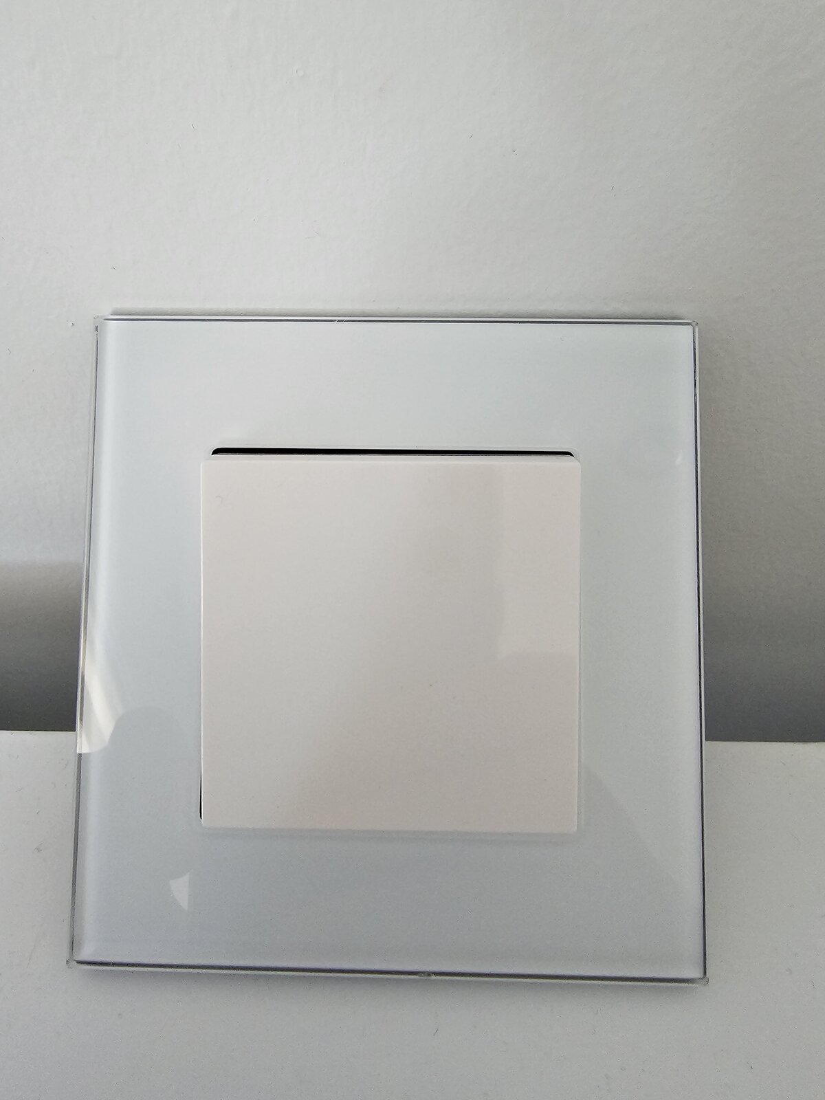

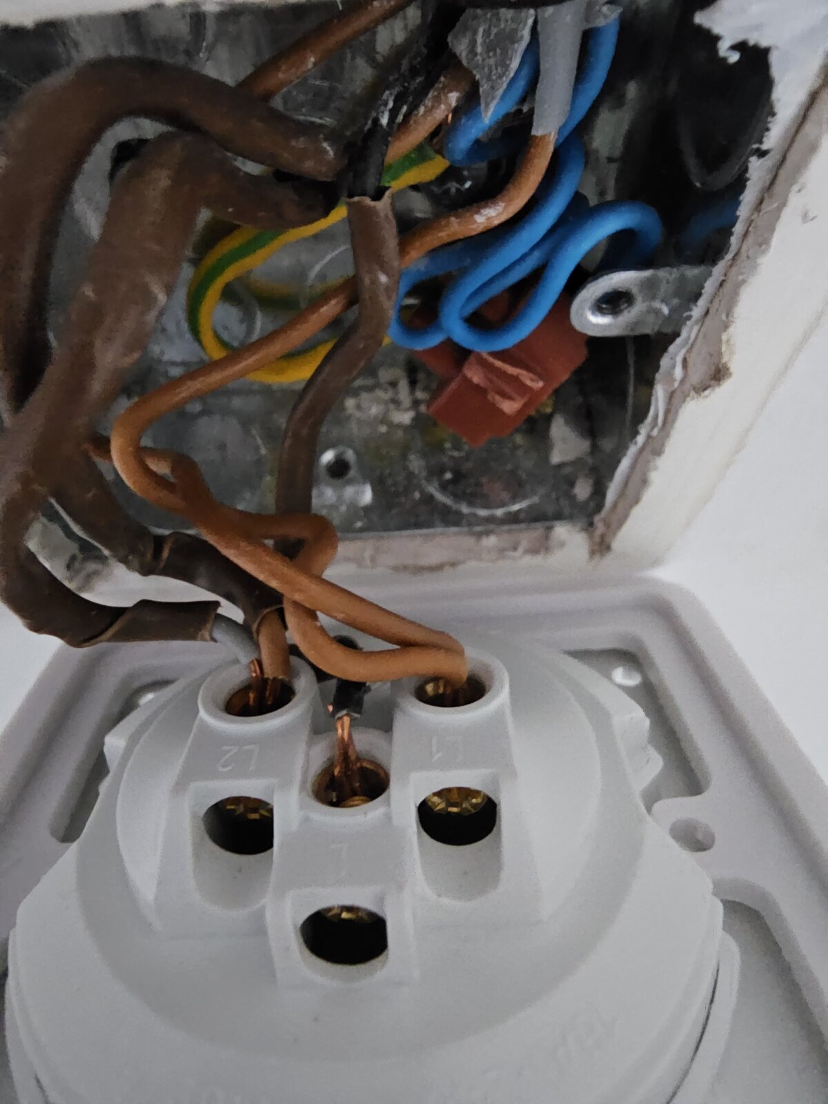

Hello again,
As suggested in order to stop all the "bickering" I've taken the photographs of all 3 light switches.
Downstairs - 1 gang 2 way
Upstairs (landing) in-between - 1 gang 2 way, same light switch as downstairs. This is where usually an intermediate switch is located. However, in my case the electricians have put 1 gang 2 way.
Upstairs - 1 gang intermediate a cheap British white switch. This is where usually a 1 gang 2 way is located.
The new intermediate has got 1 gang too. The photograph of both front and back are attached.
Many thanks in advance!

As suggested in order to stop all the "bickering" I've taken the photographs of all 3 light switches. .... The new intermediate has got 1 gang too. The photograph of both front and back are attached.
Well, I don't know about 'bickering' but, maybe because I'm dim, I could not tell you (without seeing some documentation) how one is meant to wire that "new intermediate switch" - since one expects an intermediate switch to have four, not six, terminals :)
Does it come with 'instructions'?
Kind Regards, John
Yes, maybe/probably - but as I've just written, without some 'instructions' I would not know how to wire that new switch, would you?
Bernard showed us - post 42.
I dare say I could have figured it out - as you would for a double pole switch.
Yes he did:
But that switch has the SPDT 'V's line up.
With the OPs switch, one 'V' is inverted - there may need to be a little experimentation needed to determine which contacts are switched at the same time!
They are both on their side as well.
The switches are two separate switches. I don't think any experimentation is required.
