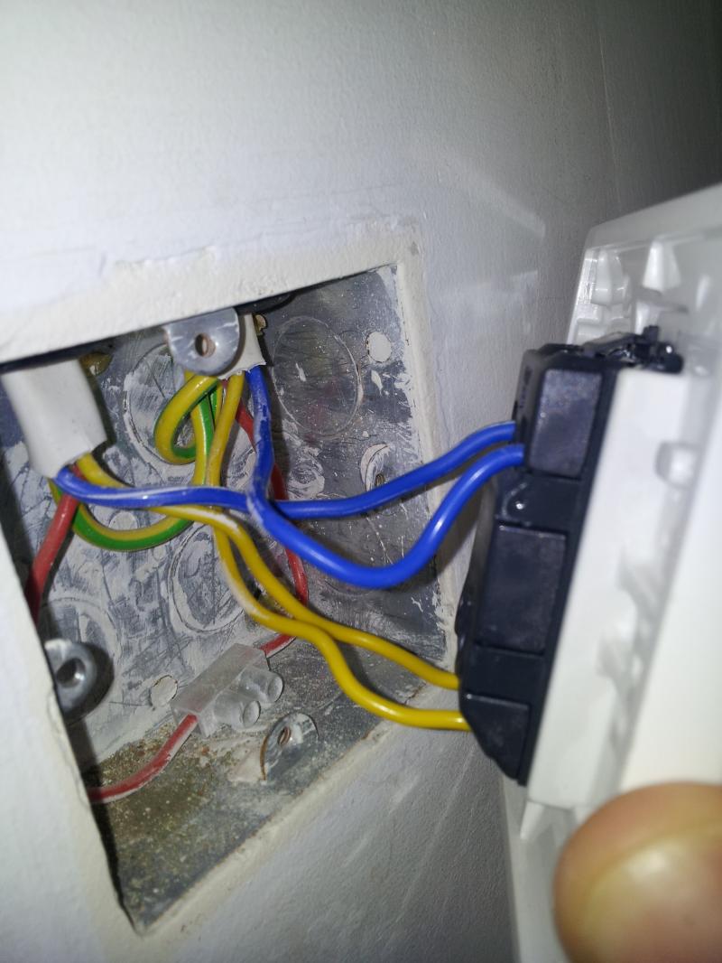

So I tried to take photos when I ahd the switches unscrewed... however in the case of the upstairs and hallway switches it was impossible to get a decent picture. In both cases the switches won't come away enough from the wall without wires being disconnected. Which I don't mind doing if you really think you need a picture - though I satisfied myself that in both cases there was only a 3core cable attached and that the red was connected to the common terminal. It doesn't matter which way round the blue/yellow are, as long as they're connected to L1 and L2, right?
Here's the sort of picture I was getting:
(note that it's on a 2gang switch so you can see an extra wire coming into the back-box, but it's connected to the other switch!)

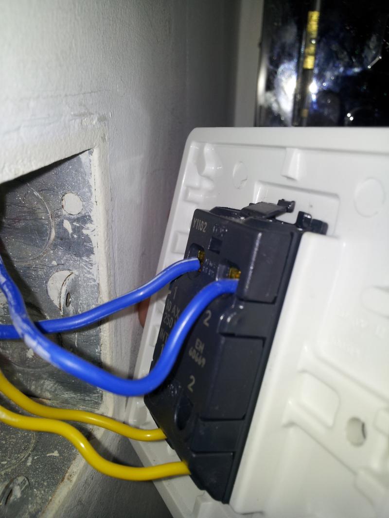

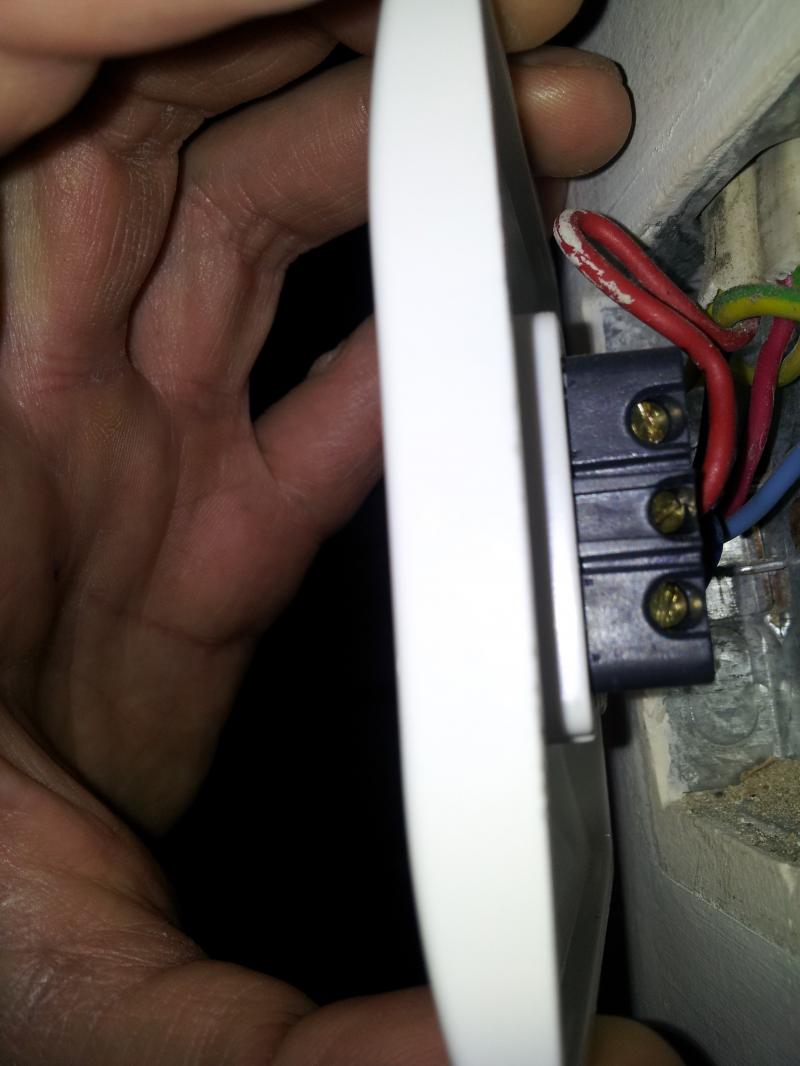

I was however able to get decent pictures of the intermediate (front door) switch:
I've added 2 pics as one clearly shows the terminal numbering and the other shows the wires coming from the respective cables.

Intermediate switch -
The wires should be connected -
One 'cable' to the top and one to the bottom with
the Blues on one 'side' and Yellows on the other
and the reds connected together as they are.
Intermediate switch - The wires should be connected - One 'cable' to the top and one to the bottom with
the Blues on one 'side' and Yellows on the other and the reds connected together as they are.
Is that not exactly what the OP says he has ("...the intermediate switch is wired exactly as in the diagram")?
Is it conceivable that he has an 'atypical' intermediate switch with the top/bottom and 'sides' transposed in comparison with what we expect? From the behaviour he's describing,it sounds as if the intermediate switch is simply joining the strappers when in the 'on' position.

Ah... So when I said "exactly as in the diagram" I was looking at the labelling of the terminals and not the orientation of the cables. So if you look at the middle picture you can see that both terminals on the nearest side of the switch are labelled "2" (and the other side's are both "1"). So the cables are connected up to the sides of the switch rather than the top-and-bottom (which is what the diagram shows).
So either my terminals are wrongly labelled and it's an easy fix, or there's some other problem.

Yes - the wiring is "90 degrees different from the diagram", however rotating the wiring by 90 degrees will still not make the switch "exactly as in the diagram" becuase then each cable will have their wires connected to both a "1" and a "2" terminal. The diagram shows one cable with it's wires connected to both "1" terminals and the other cable with it's wires connected to both "2" terminals.

Remove the intermediate switch.
Connect the two yellows together and the two blues together.
Do the two remaining switches work as they should?
If they do then the intermediate switch is faulty.
Yes - the wiring is "90 degrees different from the diagram", however rotating the wiring by 90 degrees will still not make the switch "exactly as in the diagram" becuase then each cable will have their wires connected to both a "1" and a "2" terminal. The diagram shows one cable with it's wires connected to both "1" terminals and the other cable with it's wires connected to both "2" terminals. When I wrote my original post I (perhaps wrongly) assumed that the orientation of the cables was less relevant than the numbering of the terminals.
Fair enough. I think EFLI is probably correct and that you are being misled by (to my mind) less-than-clear numbering of the terminals.
You could remove the switch and examine its operation with a multimeter, so that we're certain as to 'what terminals are which'. However, it's probably simplest to just make the suggested change ('rotate connections through 90 degrees') and see if that cures the problem, since nothing nasty will happen if we've got in wrong.

Oh, I thought he meant he had already rotated and it still didn't work.
I don't really think you can compare L1,L1,L2,L2 with (to my mind) 1,2,1,2.
Some intermediates are marked 1,2,3,4.
Just had a look at an MK intermediate switch on my van, and the wiring does need rotating through 90 degrees
