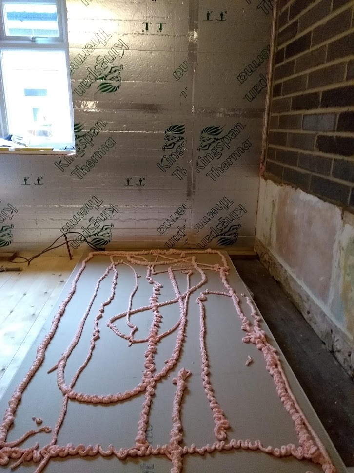

I used 50mm kingspan, fixed with Everbuild Pink Dryfix foam, with plasterboard fixed to that with same foam. All boards taped with aluminium insulation tape.
You get a double vapour barrier (hard to properly seal insulation backed plasterboard). And when I looked at prices a year ago, it was cheaper to get separates.
Didn't inform building control. I didn't remove old plaster unless it fell off - I what it with a utility bar a few times, if it comes off, it goes, if it doesn't it stays!
I don't return down internal walls. Here's the bedroom I did last year. Floor done too.
Jonbey - I have been looking at the Everbuild Pink Dryfix foam. Is it easy to use and does it stick well? How many boards do you get from a tin. I will investigate the insulation and board seperately option. Hadnt thought about doing it that way to be honest
It sticks really well. I stuck a spare bit of plasterboard to a piece of wood as a test and after it dried I could not pull them apart no matter how much I tried.
You can use with a gun or just use the nozzle provided (I use the nozzle, forgot to clean my gun!).
Follow the instructions, i.e. apply, wait 4 minutes, then hold in place for a while. If done too soon the foam will continue to expand and push the boards away from the wall.
I used more than it suggests, I probably do 2 boards per can. So not cheap, but for a DIYer it's a lot easier than dot and dab.
To be extra secure you can some anchors direct into the wall - some people recommend this, although it breaks the vapour barriers. But it is not really needed, it's no more likely to fall apart than dot and dab. I think the reasoning for it is in case of fire, to stop the boards falling off if a fire melts the adhesive, but with wooden floors and ceiling and roof, and the boards sandwiched between brick and skimmed plasterboard, I think if a fire has got hot enough to melt the adhesive, your house is probably gone already!
Some pics of sticking plasterboard to insulation. Because of the 4 minute wait it is probably a bit slow going for pros, but as a DIYer I am happy to take my time! It also helps seal air gaps etc.
