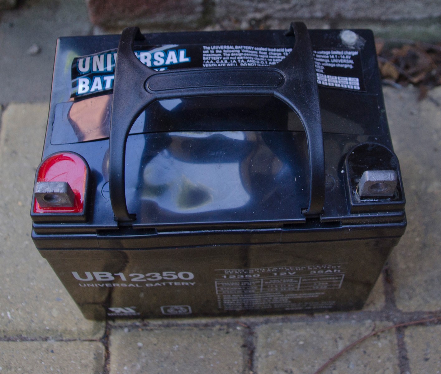

The mobility scooter fried a battery due to a cell failing in the other battery of the pair. This DSC_3937.jpg was the result, however likely would have needed a pair anyway can't really put a new and old battery together.

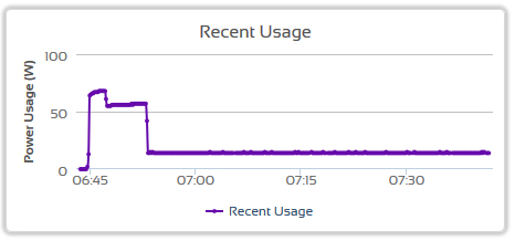

With a smart charger that is one which is designed to work with valve regulated lead acid or absorbed glass mat, (VRLA, AGM) the power in is a reflection of the power out, so a energy meter on the socket will show what the charger is doing. An example charge22-4-20.jpg this shows a 12 volt battery being charged with a Lidi smart charger where it starts at 3.8 amp, then 3 amp, then a long time at 0.8 amp, it will in fullness of time drop to 0.1 amp. With the use of a energy meter wifi connected to my PC, I can see without going to the charger how it is doing, at the moment my wife's Jaguar is on charge and I can check it from my bedroom.

But the problem is if there is a shorted cell, when the battery recovers a large charger can over charge the battery, the blown battery shown was on a 4 amp 24 volt charger, and it is a 36 Ah AGM battery. Smell would have alerted there was a problem, but on charge in a garage seldom used. And in the outer case as fitted on the mobility scooter could not see the damage.
The computer showed the sulphated battery recovered as if a switch had been clicked, it sat for 11 days doing nothing, I had a good battery and sulphated battery in parallel to get charger to work, so it showed the charging of good battery when first put on charge, then nothing, and then within an hour after 11 days went to full charge rate 0.8 amp, stayed there for around AH/0.8 hours, then down to 0.1 amp and using it seems OK, they worked a stair lift. Same done again with a caravan leisure battery.
The beauty of the Lidi charger is once it has gone through the 3.8A and 3A stage, it will not auto return, so maximum charge rate 0.8 amp, so even if there was a bad cell, it would not charge at too high a rate.
A 12 volt battery should show over 12 volt, after charge it will quickly drop to 12.8 volt, at 12.4 volt time to put back on charge, the charge voltage depends on the charger, for a VRLA or AGM the voltage is normally limited to 14.4 volt at which point smart chargers will drop charge rate. Most wheel chair and mobility scooter chargers are stage chargers, the idea is to bang in the charge when flat, but reduce the charge rate as the battery approaches the 80% charged point. So with a fully charged 12 volt battery left on charge, it will sit at around 12.8 to 12.9 volt, as it drops to 12.7 volt the charger will auto switch on, the battery will hit 14.4 volt very quickly, and then charger will switch off again. Typical patten charge24-4-20_3.jpg.
