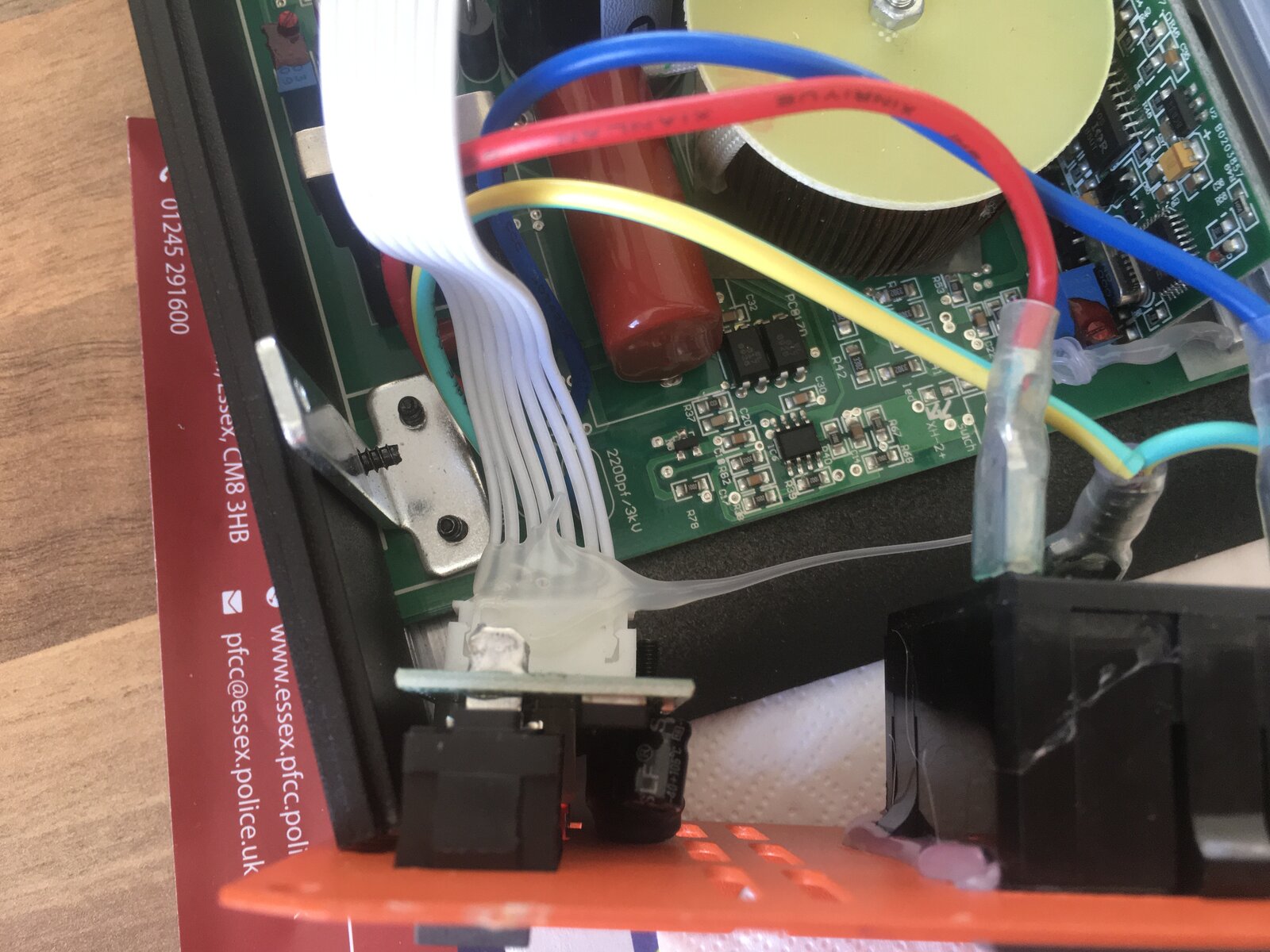

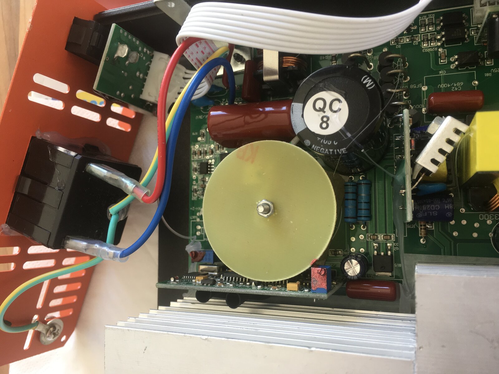

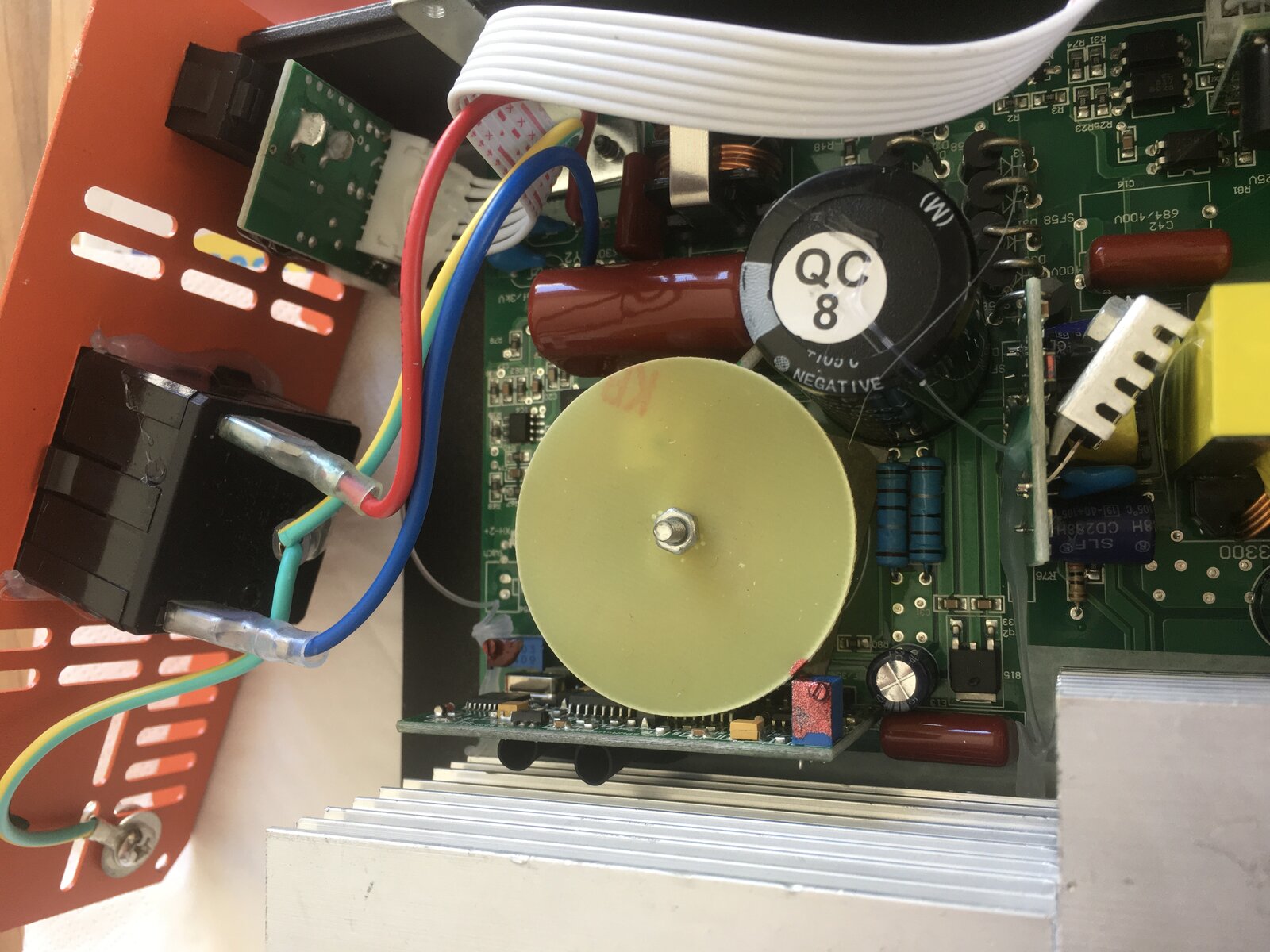

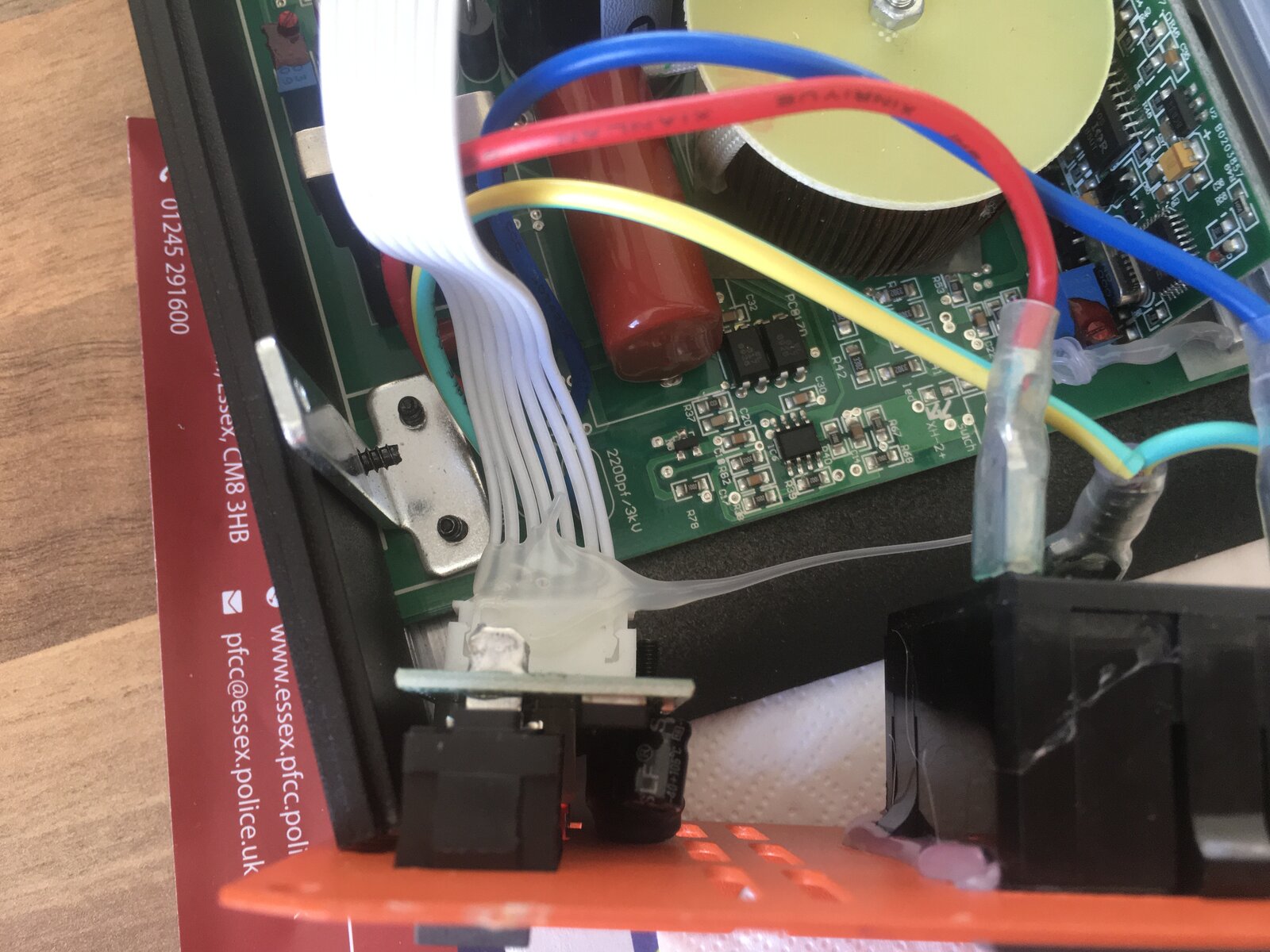

OK, this is where I'm at today. Removed top casing of the inverter with a view to linking the socket earth to the neutral, as suggested, only to find that the existing earth cable goes two ways ... one end to the earth connection on the casing which I've mentioned in previous post(s) but there is also a duplicate wire running to the circuit board in the inverter.
Thought I ought to run this development past you guys before proceeding further. Please see images & thanks yet again for your patience.

Not really surprised - it may well earth things like filters or inter-winding screen.
It doesn't really change anything except we now can't assume that the output is fully floating - it probably is, but we can't be certain. If (for example*) the design connects the earth to a centre tap of the output transformer, then linking N&E would short out the output - that "should" just blow a fuse or cause the unit to shut down, but it's not unknown for devices to just self destruct if the built in protection isn't well enough designed.
* I've seen some "interesting" ideas over the years.
