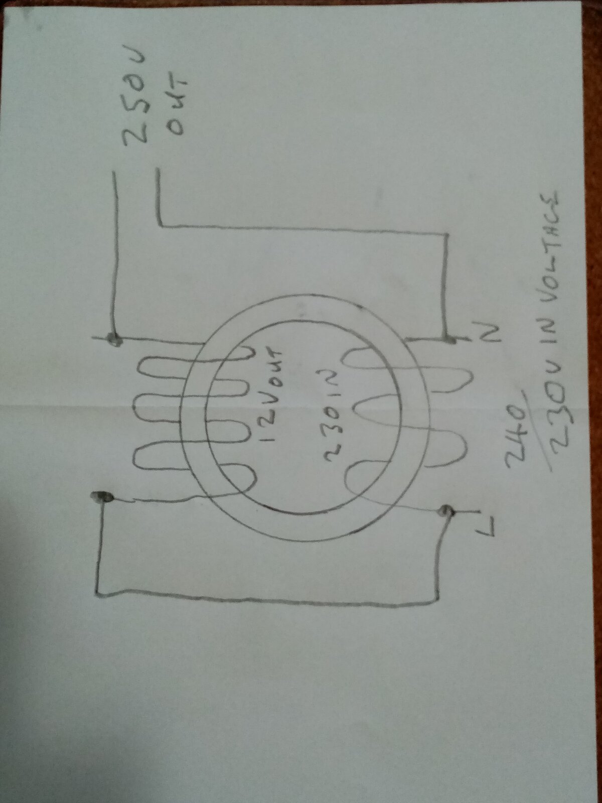

Finally sorted, the boiler is now igniting normally & can be switched between grid/off grid without the need for re-setting. All that was required in the end was a bonding of the earth & neutral on the inverter to keep the boiler's flame failure device happy.

Hi AlI, nebie on the site and trying to help, I had the same issue and it took me 12 months to rethink the problem as to why the baxi boiler would not fire up on the inverter... It worked perfectly on grid and 3 inverters later I came to the conclusion it was the inverters did not give enough voltage for the tronics pcb in the boiler to fire up the burner. So how do you get more voltage out of an inverter?
Only follow this suggestion if you understand an confident to do so... My boiler is working perfectly connected to the inverter. No problems at all with my old Potterton Baxi running 24/7
So you may ask how can you get more voltage out of an inverter? It's more simple than you think and only cost me 18 quid. I bought a toroidal 240v to 12 volt transformer, how does this help you ask? Connect the inverter 230 volts into the transformer .. You will get 12 volts out.... Now the leap of faith and trust, you connect only the live 230 volts to one side of the 12 volt secondary input and you will get 250 volts by connecting the boiler supply to Neutral and the other Secondary out, in essence the primary is transforming an additional 12 volts similar to adding 2 batteries together. I used an 80va toroidal transformer because the pcb in the boiler can't cope with the voltage drop when the pump kicks in even if your only turning the HW tap on. Hope this helps R.

Hi Norseman, my baxi boiler is fed from a 300 watt Bestec inverter and the inverter also powers the lights and wc fans, the CH doesn't even dim the lights on start up. Putting it in a more simplistic way is to use the 12 volt Ac output of the transformer and adding it to the 230 volts input from the transformer this gives you 245 volts. I will do a scetch on paper and upload a pic and it may help. Regards R.
It worked for me. I tried every option and this was the solution.Total cost 17 quid

Thanks for the sketch.
