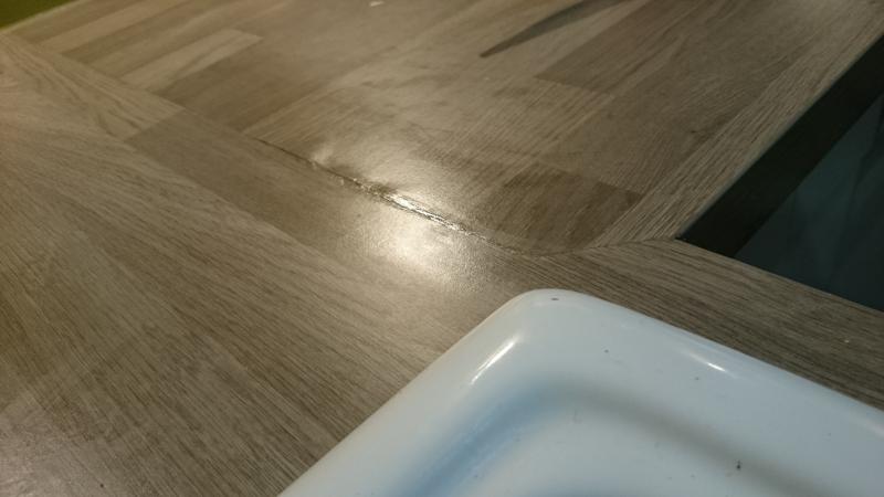

Is a kitchen worktop joint waterproof?
He also said if he replaced the worktop he would use PVA to try to stop it doesn't happening again, but couldn't guaranty it
so if he agrees that using pva would/might stop it from happening again why didnt he do it in the 1st place.
on a personal slant,i dont use pva anymore when i do worktops,i use poly glue and bushboard jointing compound.

But there's PVA and there's PVA. 5 or 6 years ago most PVA was D2 (interior use) or D3 (exterior, sheltered use) and took 12 to 24 hours to dry. These days there are plenty of 10 or 20 minute PVA glues (although I'd leave it a few hours TBH) rated at D4 (exterior, fully waterproof). Unlike PU glue they don't foam up or make your skin go black - both major advantages IMHO. PU has it's place, but I think the risks of using it with pre-finished materials and veneered stuff, etc (and having to scrape off any foam out) are just too great

Attached is a photo but it's difficult to see - the bubbling runs for perhaps 4 inches and is around 2mm high on the right side of the joint (The left side worktop strangely hasn't bubbled at all - I guess that side is sealed properly)
I've now put silicone over the join to try to stop it getting any worse
I think perhaps all I can do is leave the fitter a negative Checkatrade report? I don't think the fitter will admit that he made a mistake so won't do to fix it.
It's a shame because until this happened I thought he'd done a brilliant job

Thanks chippy5 - I did buy through Howdens - what would they normally do in this situation if it's a fault in the material? would they send out a free worktop or would they send someone out to replace the worktop?
Your best bet is to call the rep and have him come and have a look.
If it is a material fault Howdens will supply new
But I have a feeling it's been poorly fitted. Which means you have to get the fitter to replace the worktops free of charge. You shouldn't have to pay to replace them

if howdens accept they are at fault and you supplied the worktop then you need to pay the fitter/chippie to fit the new one as it was fitted to standard so your contract with him has ended
if you can convince him he is partly to blame you may get a compromise off reduced cost to fit
