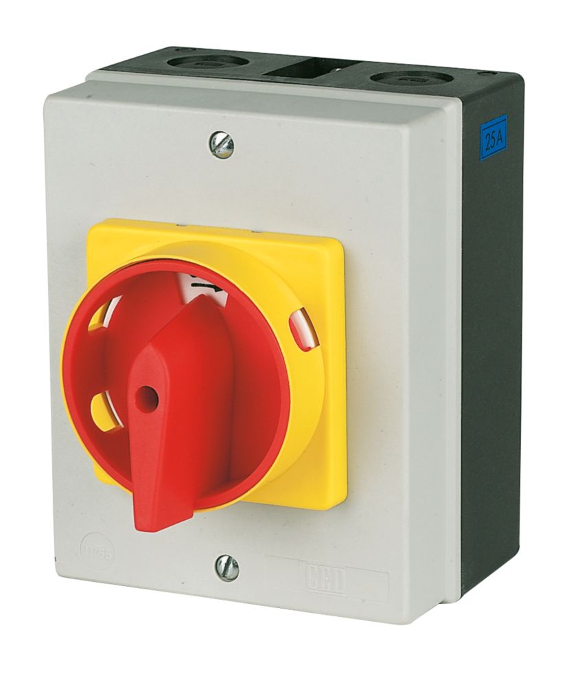

However, if you felt that you would be more comfortable with all circuits in the garage (other than lighting) being isolated when you left it, there would be ways of engineering that which would not involve using MCBs for that purpose.
ae235
You could even padlock it when off, if you wanted.
<pic of rotary isolator>
Indeed. He might even consider using the main switch of the CU (although I'm not sure they are really designed for frequent operation, either). However, either way, he would have to engineer things so that his lighting circuit (which he wants to stay live) bypassed that isolator/switch.
Kind Regards, John

I've perhaps given the impression that my vast and luxurious "workshop" allows me to maintain 19th century steam locomotives as well as the odd light aeroplane.
In fact, it's a standard single garage so it won't take long just to walk round the eight sockets and flick their switches off. If I was to do anything at all then b-a-s' suggestion of an isolator per tool-carrying ring would be an idea.

Isolating a ring is 'interesting'. I suppose one can get SP isolation by using a standard DP isolator to 'isolate' just the two Ls. If one wanted DP isolation, I suppose one could use a 3P+N one to isolate all four live conductors.

Ah - great point. So an isolating switch in one direction would still leave the circuit live, but with diminished current carrying capacity! Definitely not doing that, then!
