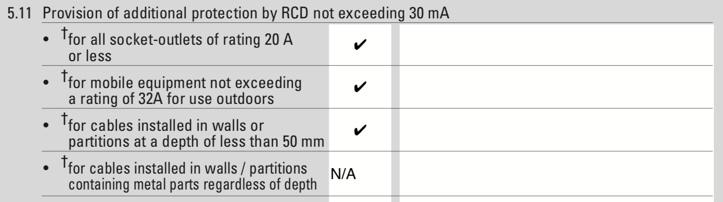

Is metal stud-work required to be earthed?
We could discuss whether the studwork should be earthed - and specifically whether that creates more hazards than it removes.
But one obvious mitigation is to require all circuits to have RCD protection - that should have tripped the supply in that case, causing an apparent nuisance trip, and probably getting the cause found without it being fatal. Perhaps we should suggest that as a new reg :whistle:
It is on the NICEIC EICR (and I assume others), can't say I've come across any metal stud work that wasn't in new builds at all (which are obviously all RCD protected and thus irrelevant)
