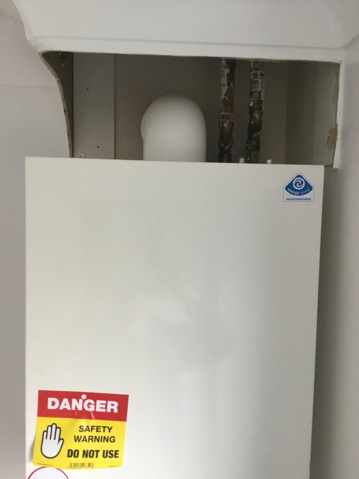

Is my boiler illegal and can't be serviced?
How many people who design new boilers are GasSafe registered ?
Do you know any designers who are not registered for gas work?
Boiler in the picture, IIRC, was never made as rear glued appliance
DanR I was mulling over what you said above. How difficult is it to cut the mastic and do a proper check.
Obviously someone who installs boilers will have detailed knowledge of boilers made by many of the dozens of different boiler manufacturers.

Still, 5 minutes with the multi-tool instead then :D
Don’t forget “many” service technicians are just that! They wouldn’t know what a multitool was and certainly wouldn’t want to get covered in nasty plasterboard dust! :LOL:
I ended up cutting out a section as it was too small to cut out just for an access hatch and discovered the boxing was actually glued back to plywood pattresses on both adjacent walls. I'll re-attach the cut-out with a couple of angle brackets after its been serviced so it allows for future access.
Due back out to service in 3 weeks so let’s see how that goes.
Thanks for replies.
