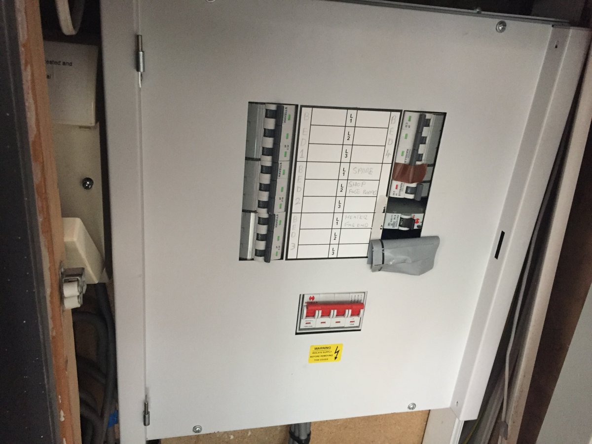

In relation to my CU. I said earlier it was a sunbed shop in a previous life and it still has a 3 phase supply and a 3 phase board to which one of the phases supplies the CU for the centre
Does the 3 phase board ONLY feed your shop? Or are there other breakers? We need pictures!

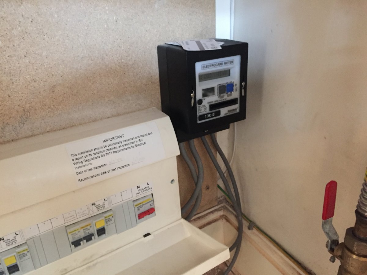

Ok heres what i did. Pictures to follow.
I turned off all mcbs on consumer unit to shop but left mains switch on. Went up to flat and turned on lights, this gave a slight flicker to our meter. Then plugged in a kettle in flat, this made the flicker faster. Then turned off mains switch to incoming supply to shop which turned the lights and kitchen sockets off to the flat! The turned mains switch to shop back on which made the kitchen sockets live and lights on in flat. Then went to CU in flat and turned mains switch off in flat which turned off lights and sockets to flat. So i think something not quite right. Didnt have anymore time to do any further testing. Will post pics now

Pics.....

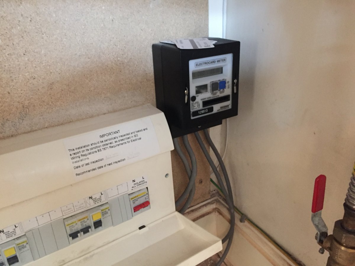

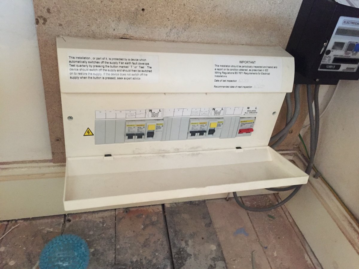

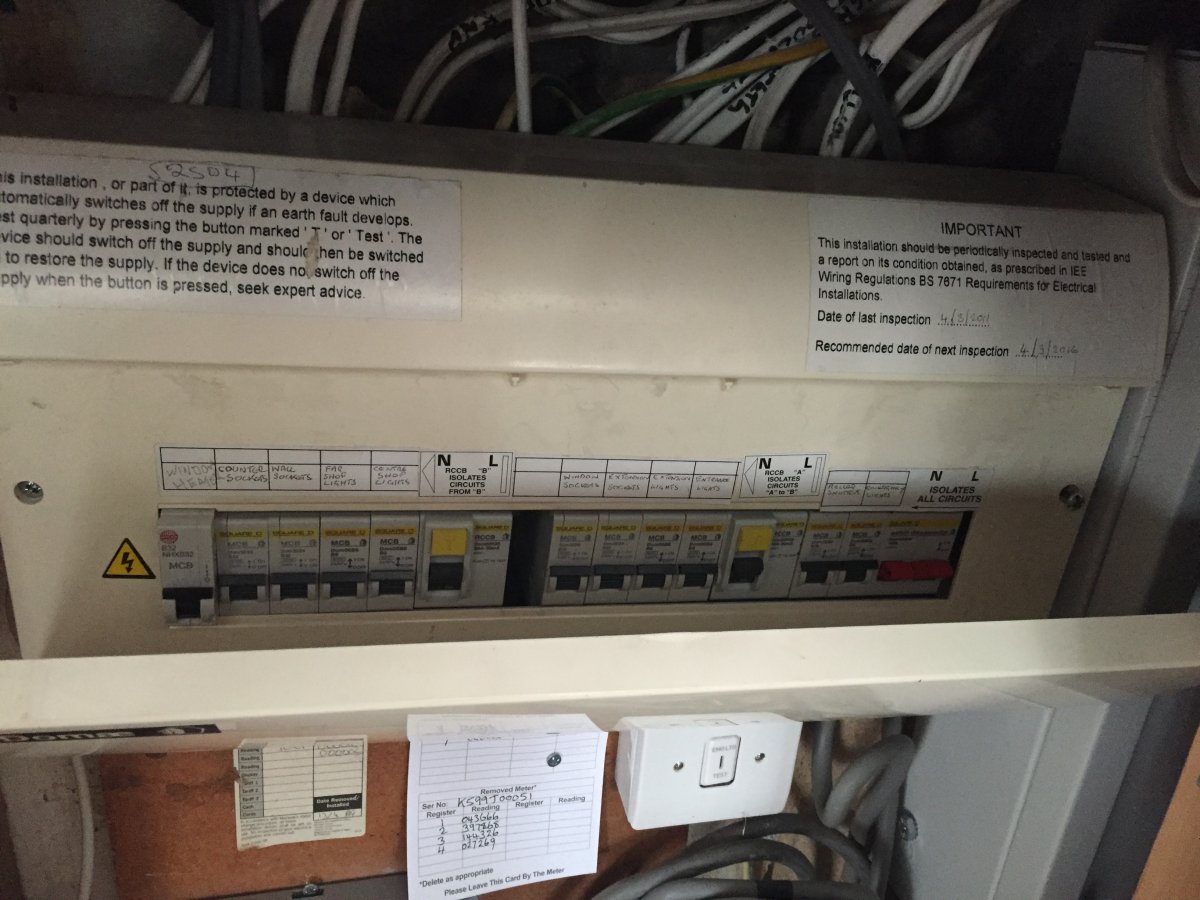

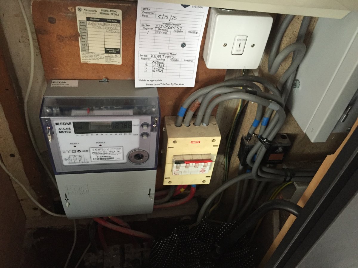

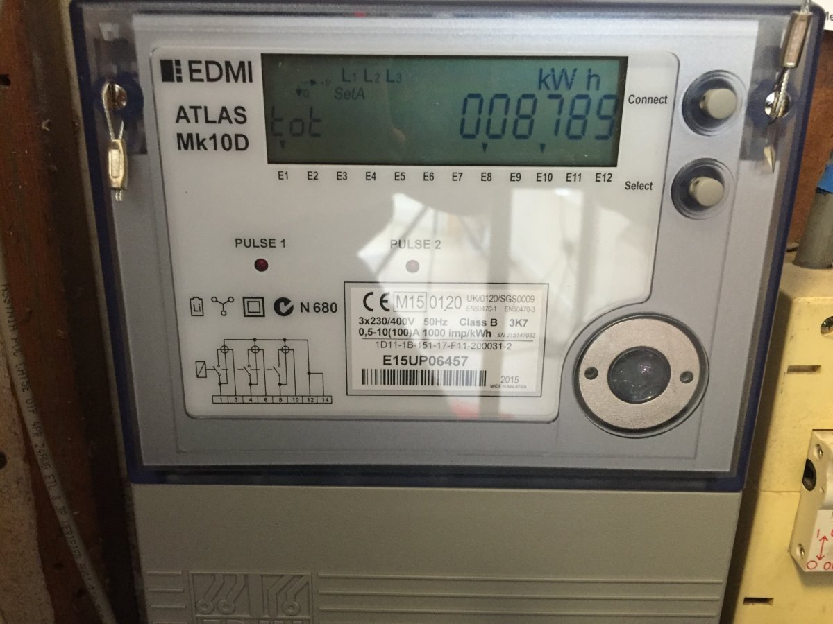

please describe the Main Switch
Is it separate from the consumer unit?
The mains switch is on the incoming supply and switches the power off to the 3ph board which in turn switches the power of to the cu
thanks, I see that now. It looks as if there is a 3-phase meter for the whole building, then a smaller single-phase meter in the flat. I suspect, but I can't follow the cables, that it is a subsidiary of the 3-phase meter, in which case it would be tracking usage that has already been tracked. That would be acceptable if it was a tenant's meter and the downstairs person charged the flat, but is not right when they are independent tenants.
If you can follow the cables on their route from the big meter and the main switch, it may become clearer.
I think you are right. I think one of the phases feeds the flat and then goes through both meters. My question is, where do i take this now?
try to follow the route of the cables. If you follow them and take photos, it may be clearer to see. If that is the problem, point it out to your electricity supplier.
