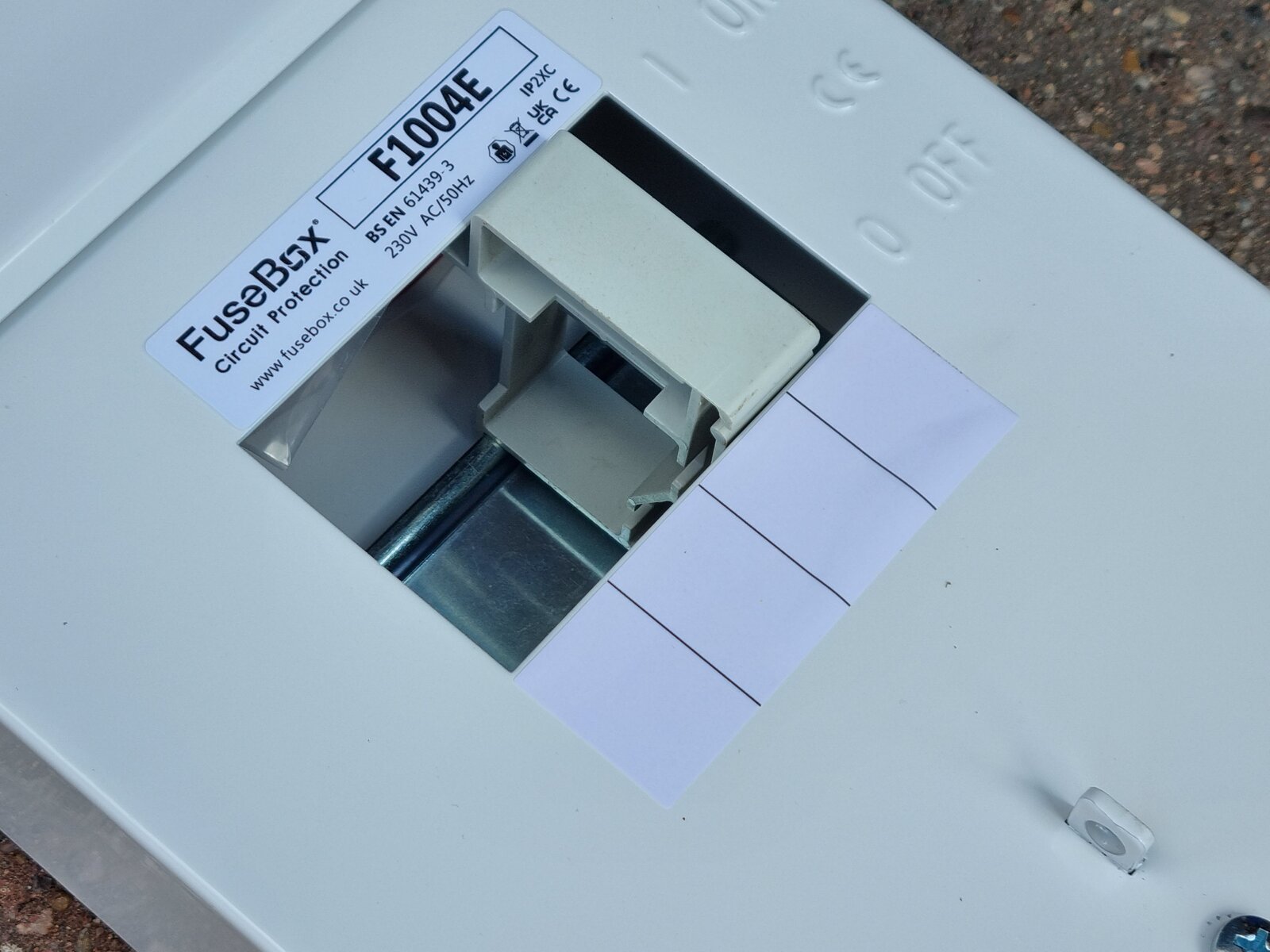

Is this a C1?
I imagine someone is bound to ask, so ... can they be as easily removed "by just squeezing the top/bottom from the front" (which 'they' would probably describe as "without use of a tool" :) ) ?
Kind Regards, John
Well yes that may very well be the case... except only after the CU cover is removed with the aid of a tool
Oh, that would probably be OK, even in 'their' eyes.
I was thinking that "from the front" meant with the cover still present.
Kind Regards, John

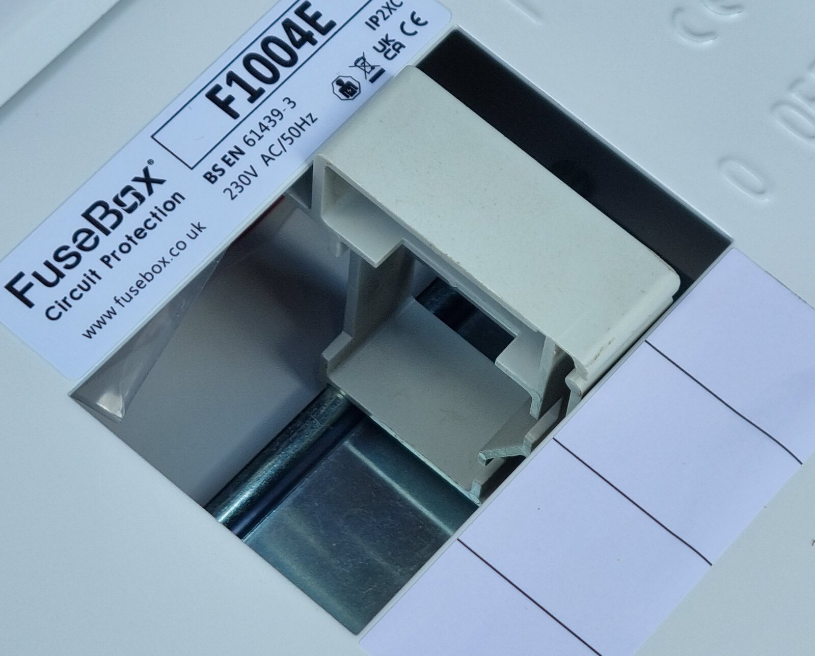

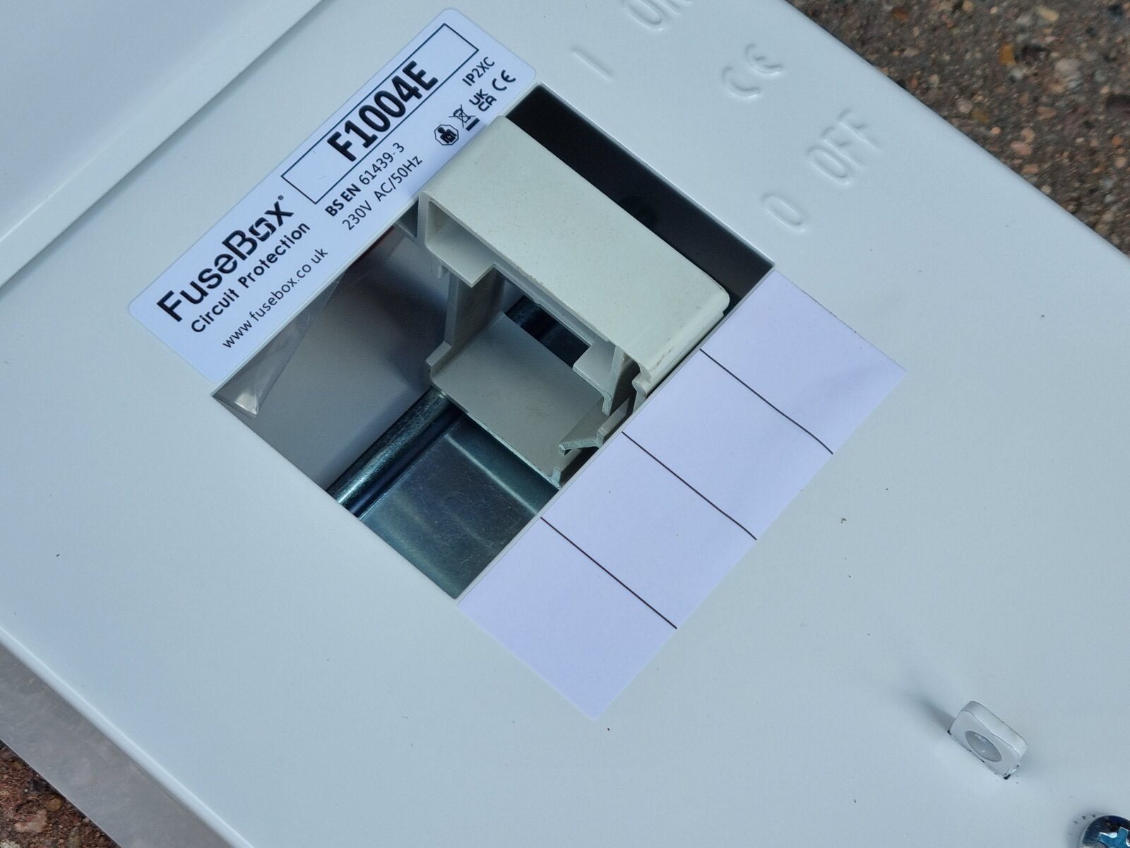

To close this one off I thought I'd have a go with one of the "squeeze top-bottom" blanking modules in an empty board.
You can't get them out. Even with all the room on the side, putting my fingers in the CU via the other gaps (which you wouldn't normally do of course) you can't get them off the DIN rail. You have to have some leverage there to lift them up, which can only be achieved with the cover off.
So confirmed as perfectly safe and fit for purpose.
