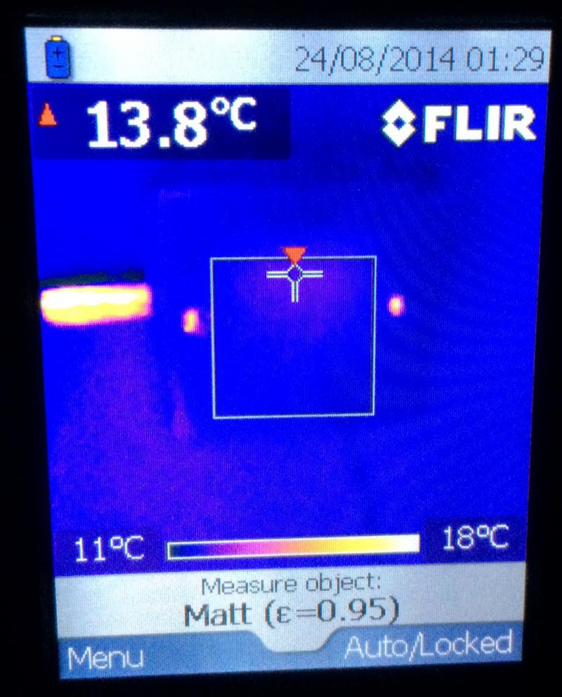

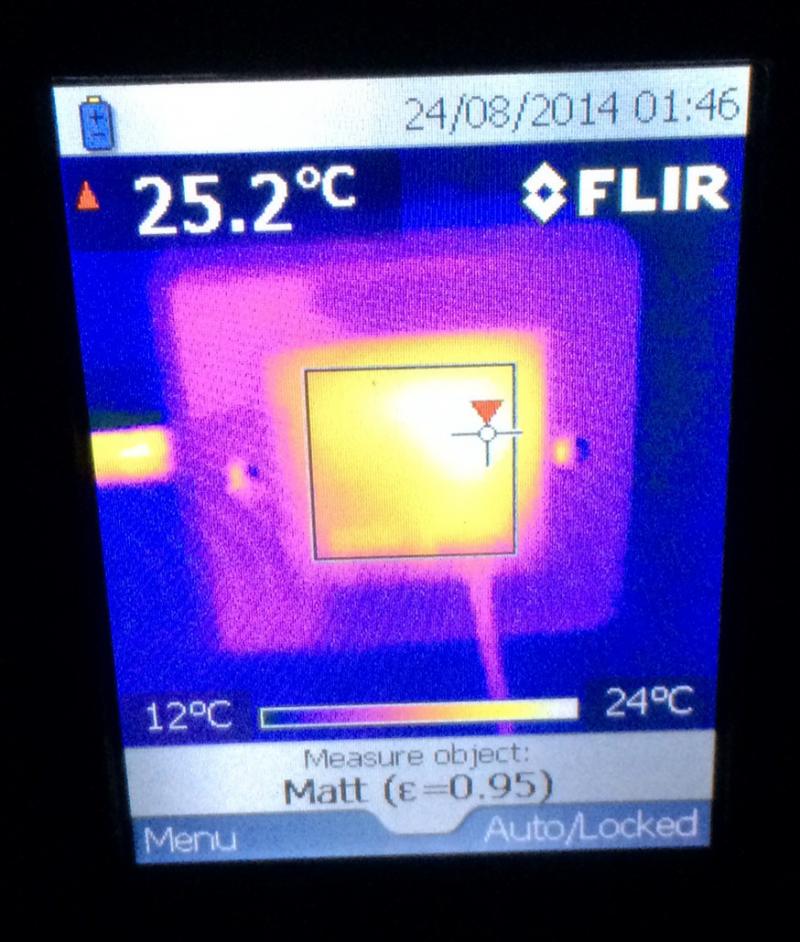

Was having a bit of a play with my usb charger last night. It's a LAP branded euro modular one from screwfix. I leave the lead in all the time. It stays completely cold when not in use and warms up when actually charging. The standby current in negligible.
Standby
Charging

Interesting! Is that the supply cable on the left? If so, it looks as if it gets surprising warm when the charger is in its standby state.

No it's a galv coupler. As it's a shiny surface what you can see is the reflection of heat from my body.
Emmisivity is the bit of thermal imaging that I still don't fully understand, but basically shiny surfaces appear hot when they are not really. For reliable readings of these you need to apply either black tape or matt paint.
No they reflect IR energy from other sources, and appear hot. You can see the coupling and plate screws in my first picture appear hot, whilst they are really the exact same temperature as everything else in the picture.
Isn't it the other way around? They have low emisivity, so they radiate less.
I think you're both right, in some senses, but that endecotp is somewhat muddling the concepts of emissivity and reflectivity - which, although somewhat related, can operate independently.
A highly polished metallic surface has a very low emissivity - so radiates very little of the heat that it 'contains'. Hence, if RF's socket and charger were in deep space, with no other significant heat sources around, his camera would therefore show the screws etc. as colder than surrounding materials (of higher emissivity) at the same temperature.
However, highly polished metallic surfaces also have a high reflectivity. Hence, if there are other heat sources around (like RF's body), his camera will see the screws as hotter than their surroundings (which have lower reflectivity), since the screws are reflecting a lot of the incident heat from his body, even though they are radiating very little of the heat which they 'contain'.
