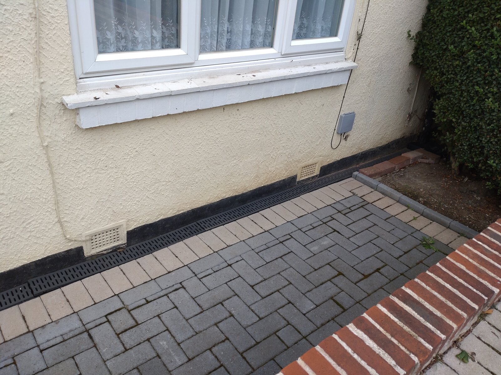

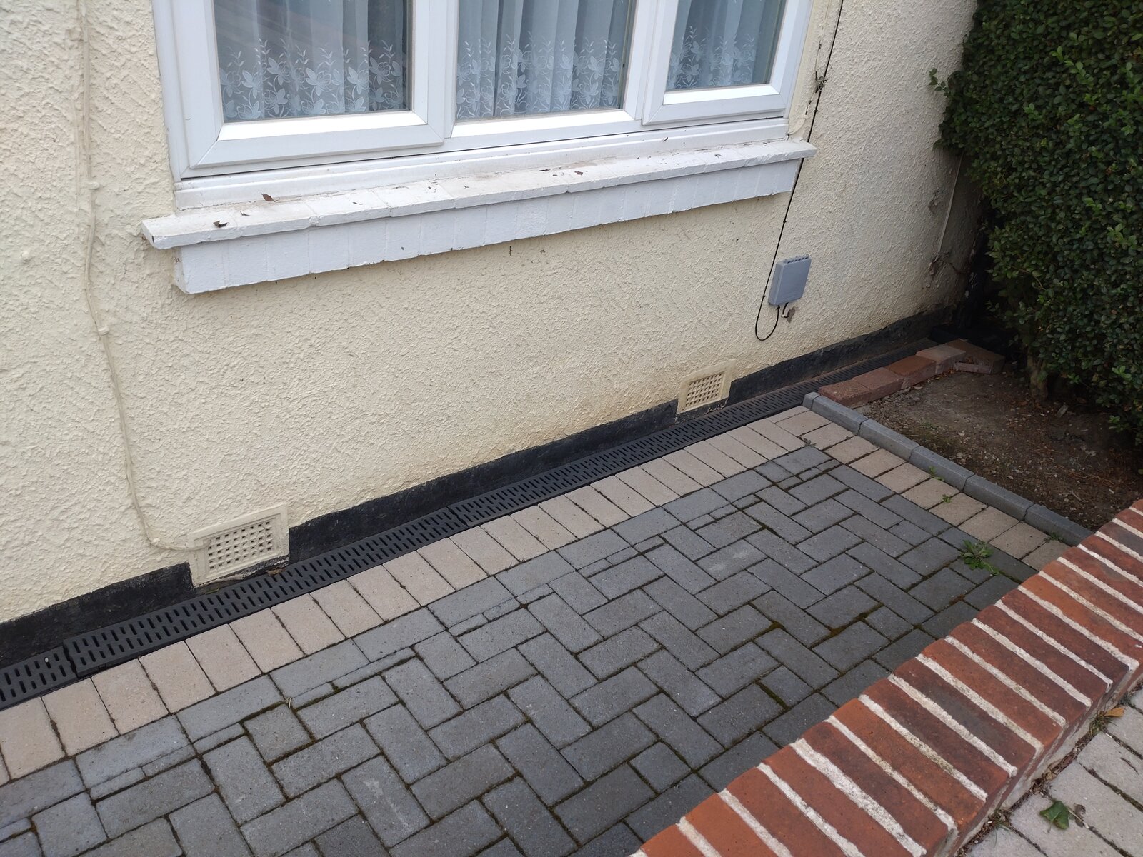

The photo in the left is my house.Rge hedge divides the garden.Photo on the right shows the drain in front of the wall
Please find the DPC and mark it in chalk for your next pic.
I will not be in the least surprised if the garden level or render negates it.
The trough drain is suspicious. The sort of thing that is added when the paving is too high.
The DPC (Damp Proof Course) is bridged (covered), by the render, giving a porous path for moisture to rise from the ground and cross it. Ideally it needs to be chopped off from just above it. E.g. like this...
...but also check drains.
